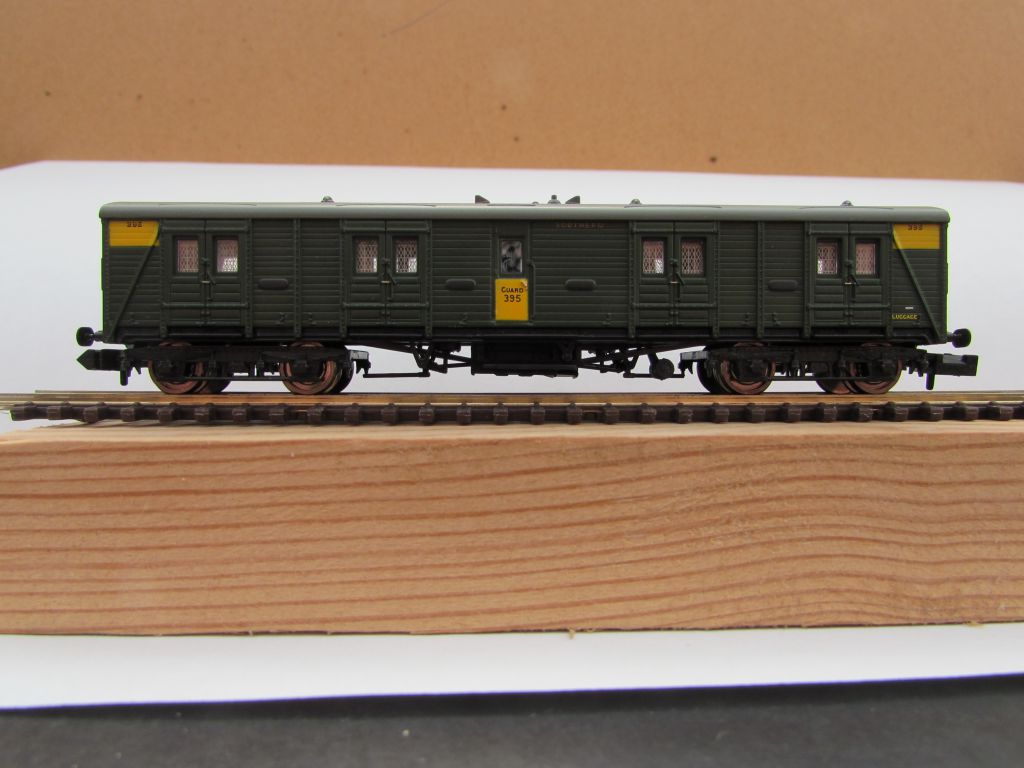

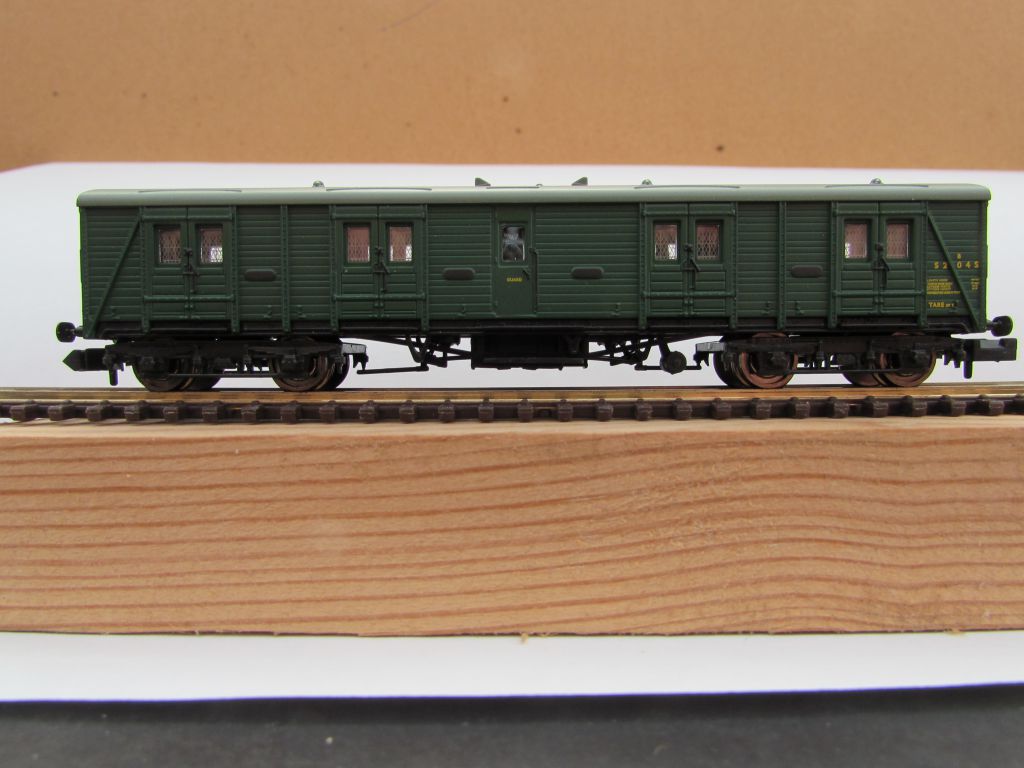

@REGP
Probably not on the website but you should still be able to track these down.........
374-631 BR (SR) Green
374-630 SR Green
and if you're modelling SR parcels at all then this also...........
374-416 SR green PLV
Personally I don't worry too much about age of stock as all sorts of old stuff hung about in parcels rakes

No problem, Ray. If you change your mind TrackShack have the 374-416 in stock.
Also, check out the GUV 374-130 (maroon) and 374-131 (green)
