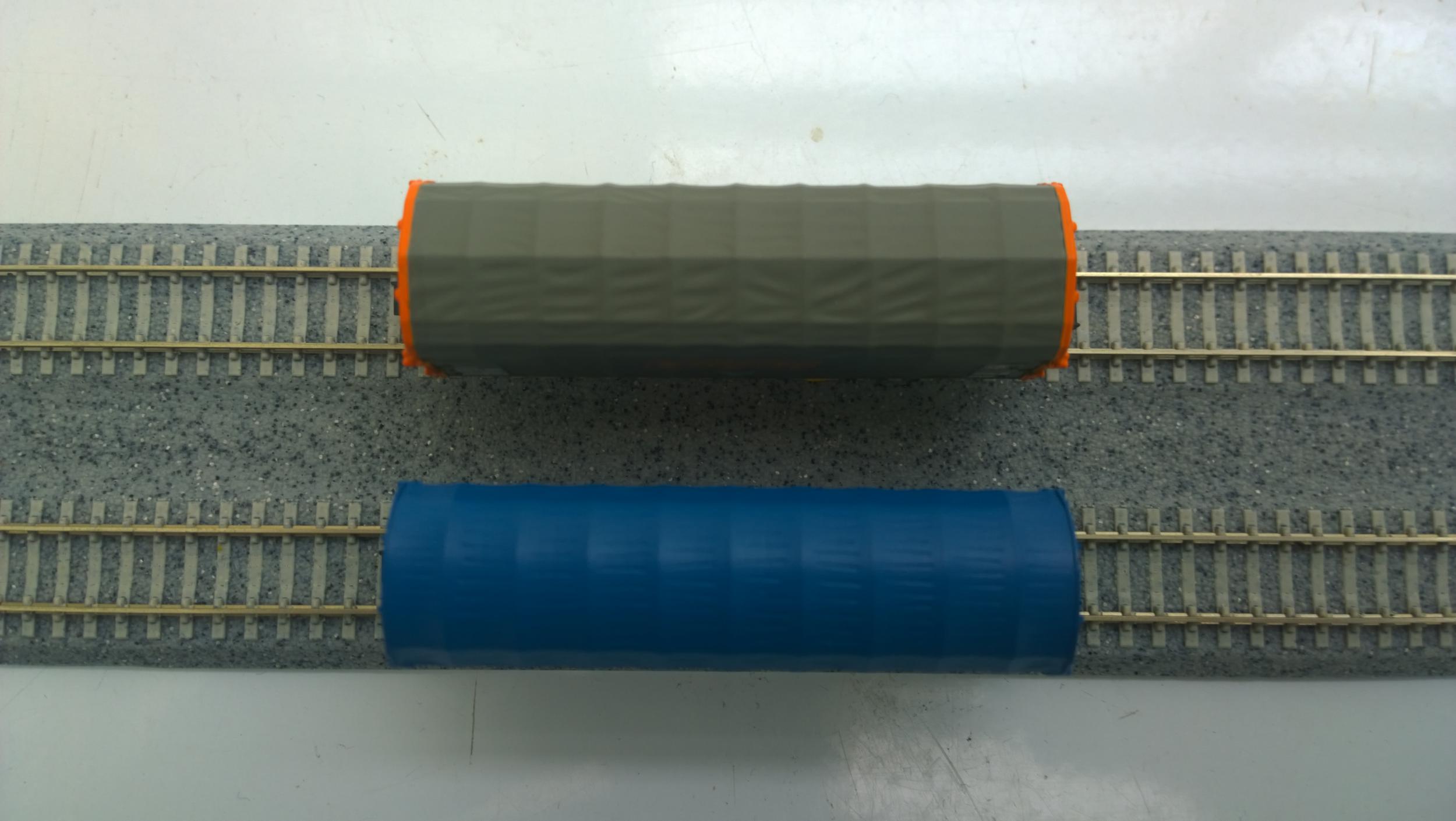

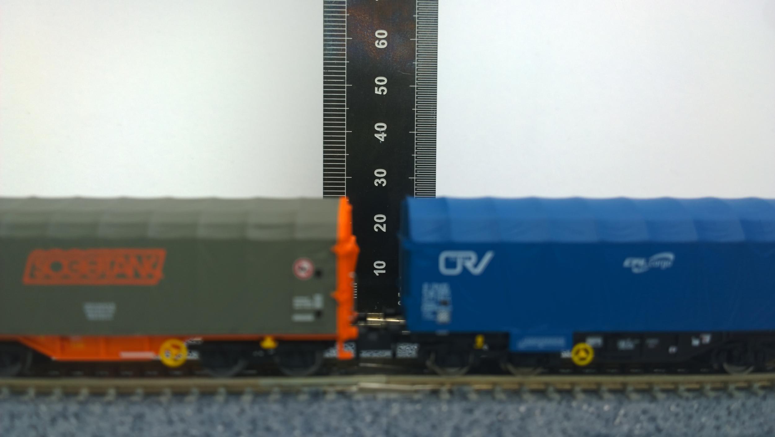

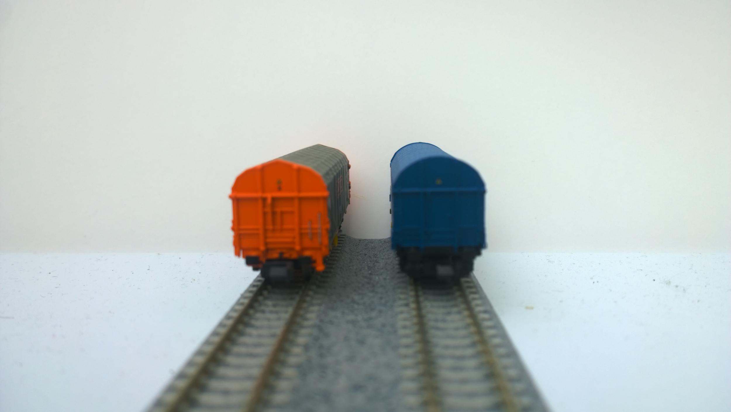

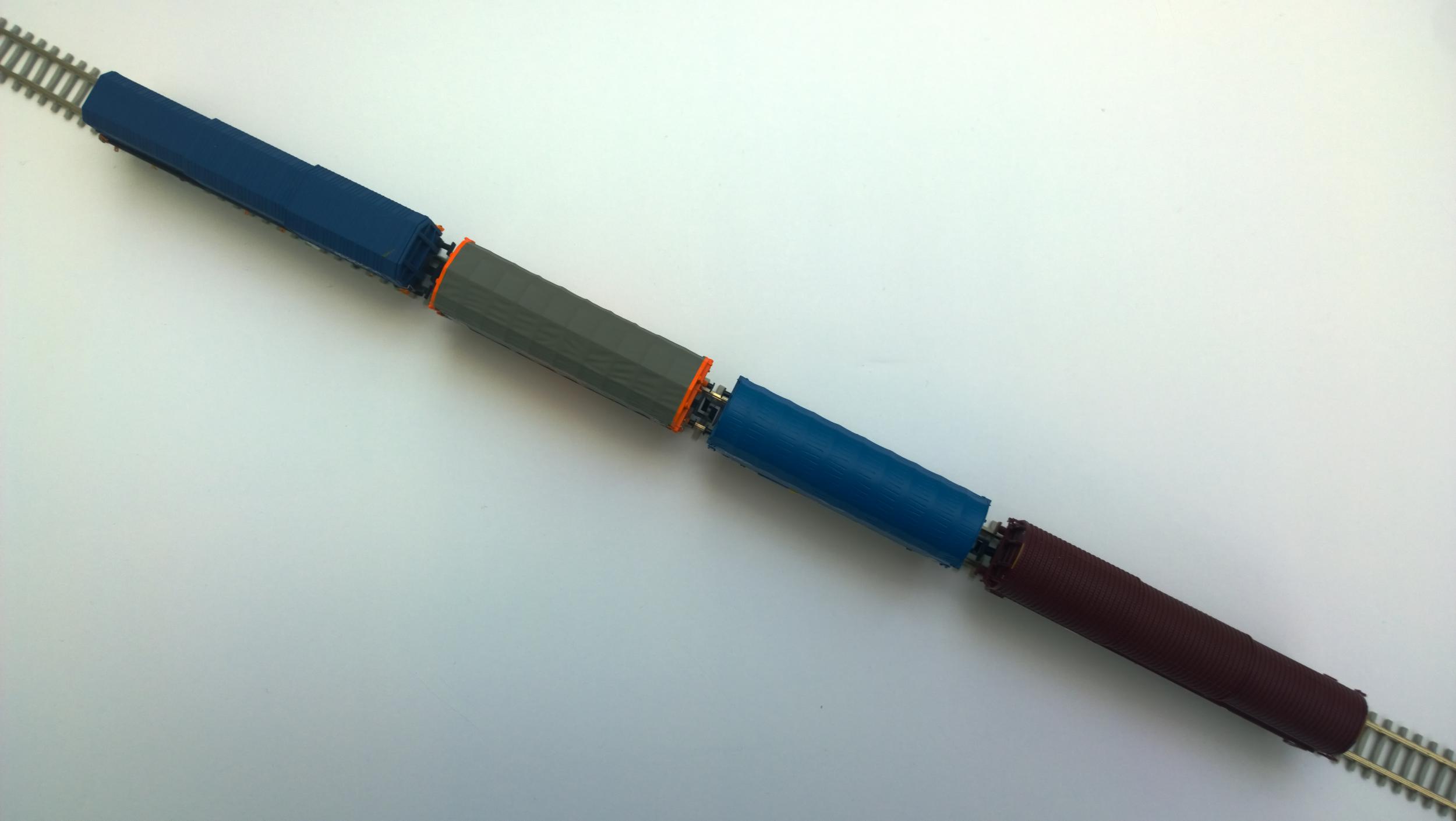

I have a dozen Modellbahn Union (MU) Shimms Tarpaulin Wagons, all manufactured by Dapol. I bought them intending to re-livery them as 'GE Capital Rail Services'. However, I've never been satisfied with how they look in a mixed train of Dapol KIA Telescoping Steel Carriers and Bachmann/Farish BRA Bogie Steel Carriers. The MU Shimms simply look too large.
I've recently purchased a pack of Fleischmann Shimms Tarpaulin Wagons, which look much better in a mixed train.
Comparing the dimensions of the Modellbahn Union/Fleischmann models shows the most significant difference is in the width:
                                      MU / Fleischmann
Length over buffers  75.4mm / 75.0mm
Height from rail-top  27.2mm / 27.4mm
Width                      20.4mm / 19.6mm
So probably safe to say that the MU Shimms is 1:160 scale. The MU model has exquisite detail, but I'll be flogging them all now and replacing with Fleischmann.
Oh, and the prototype has two roof profiles which both have the same max height.
So that's interesting, as it's actually the reverse - you think the smaller 1:160 wagons better match the UK 1:148 ones!
