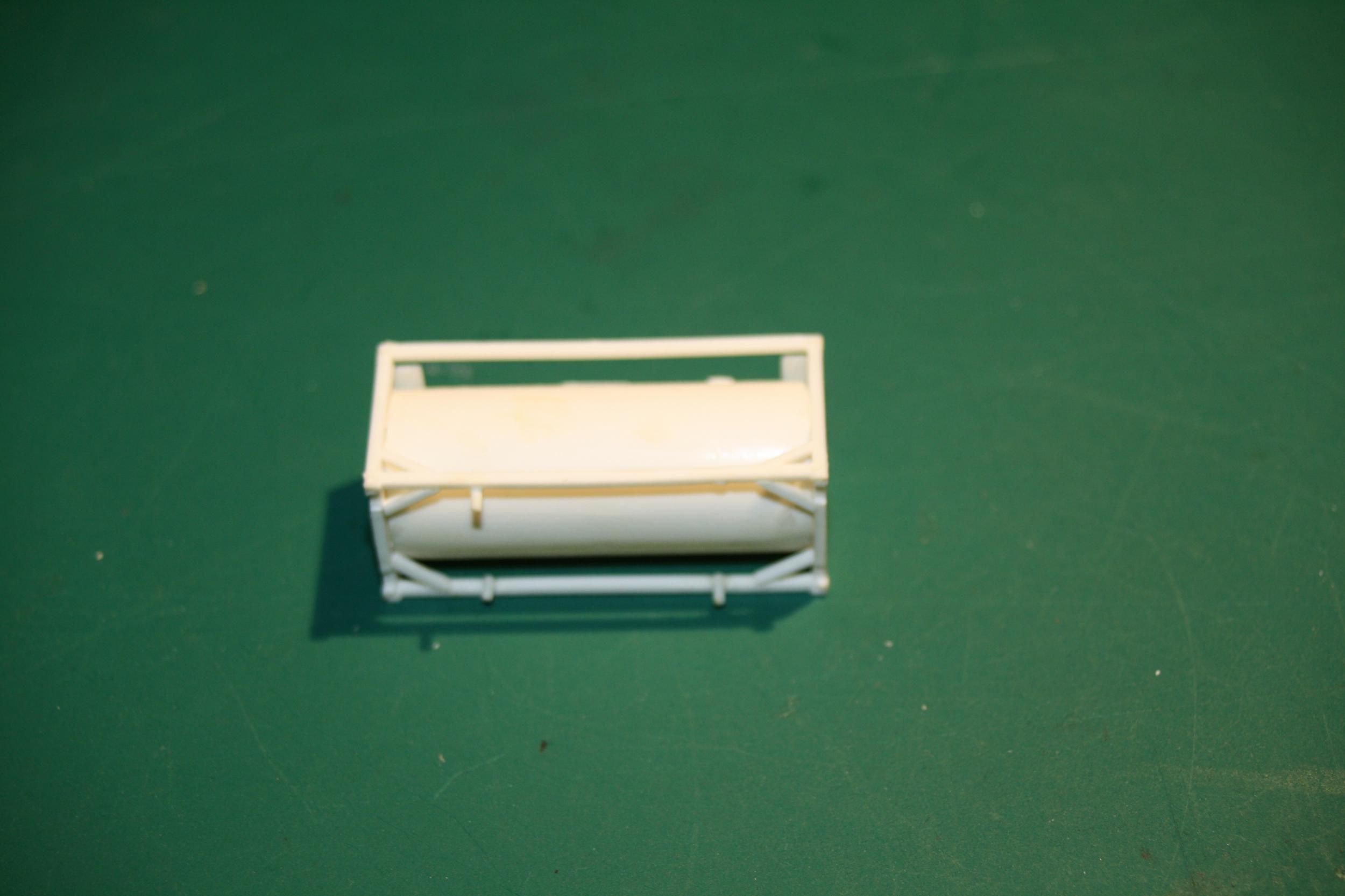

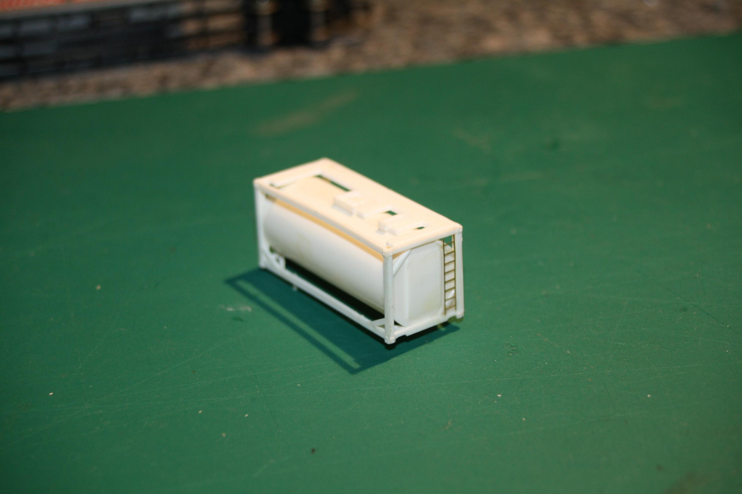

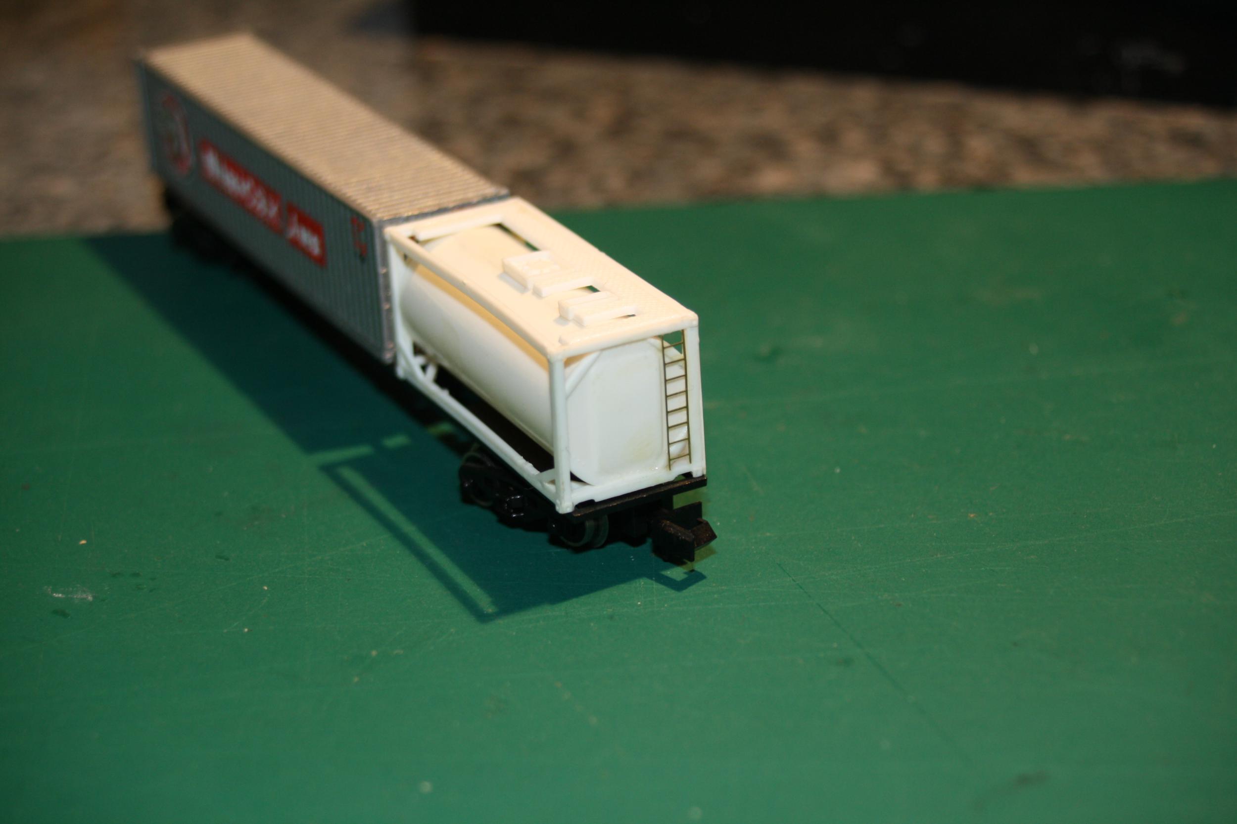

Not the best work I've ever done, but here is one of Arran's that I made earlier.
Drilled the bottom framing to fit locating pegs so as to load onto a Farish Freightliner wagon.....
I really should do the transfers sometime !

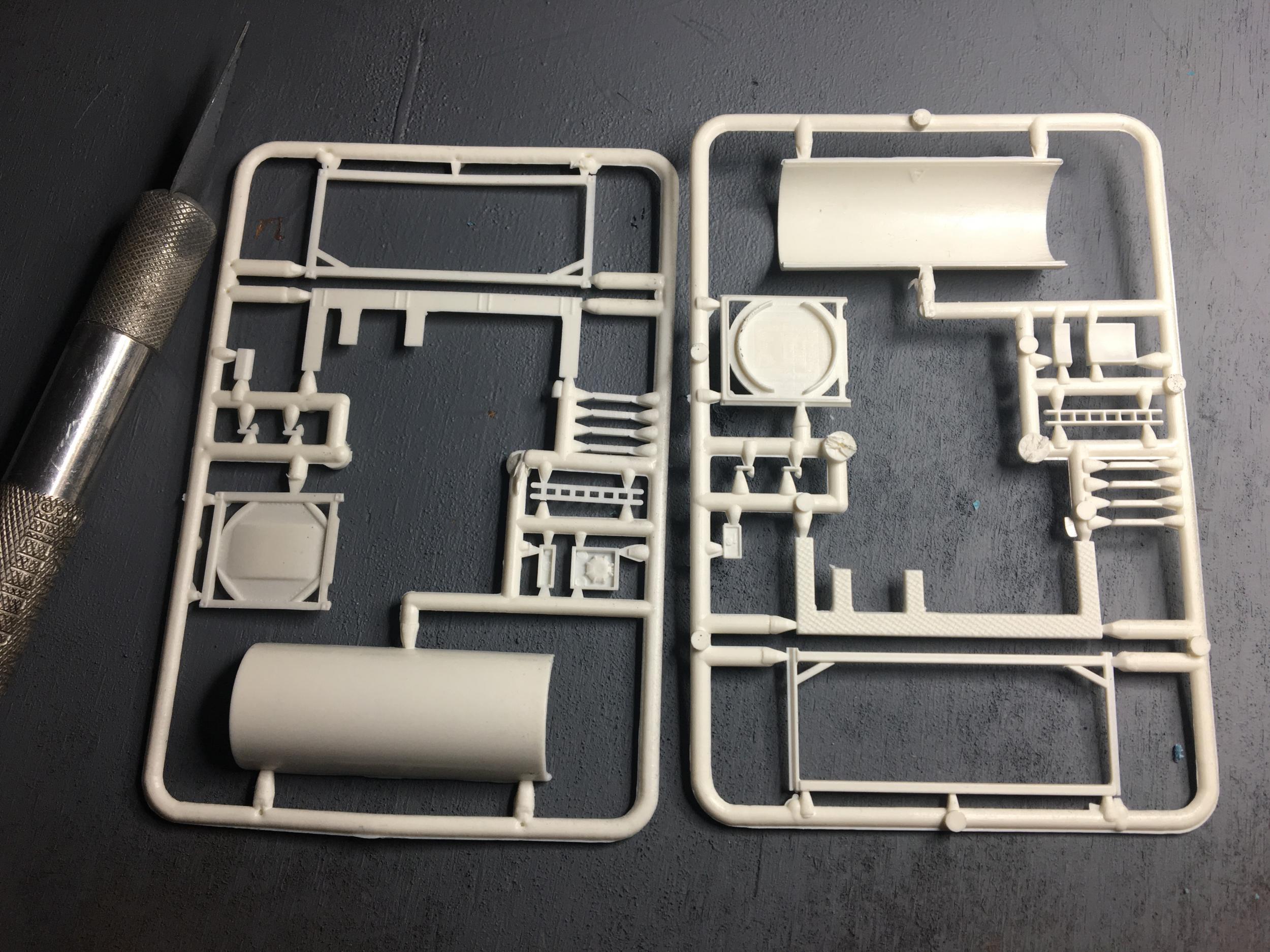

Here's a quick pic of the frets as they come. You need two frets to make up one tanktainer, although you wont need all the parts.
It would be quite nice if there were some walkway etches that we could use instead of the plastic lump that come with the kit. Any ideas anyone?

There are (were?) walkways
Ask Arran at C Rail

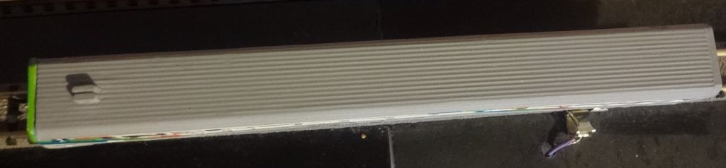

Take a piece of kitchen aluminium foil and place it over the walkway. Brush gently with a small paintbrush to copy the relief to the foil. Make a thin copy of the walkway in 0.25mm plasticard and smear the upper surface of this with Pritt stick or similar. Lay the sticky side of the plasticard onto the underside of the foil image so it is fully adhered. Let it dry for an hour or two. Spray with aerosol car accessory primer. Let it fully dry. Then cut round the new foil covered plasticard shape to reveal your new thinner walkway. OK it is a bit of work but once primed this should give a finer appearance.
This ribbed roof was made in this way in 1992 and 25 years on is still going strong.

Hi @westie7 I know there are walkways on he fret, theyre the E shape on the frets. But Im asking if there are etched brass walkways which would be much finer. Are you saying that c rail sell etched walkways?
Kirky
westie7
Yeah he did do them, dunno if he still does, I grabbed a few many moons ago. If you get them from CRail, take your time they're well fiddly

They certainly used to as I have a couple of sets.
