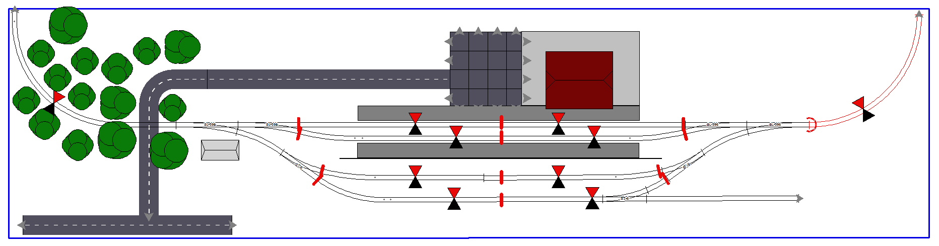

Blair Ivor is set in the Scottish Highlands in the here and now, and will be on an 18" x 72" board.  Everything must fit, there will be no fiddle yards, extra boards etc.  It is an old rural station that has had some necessary upgrades carried out to meet current railway operations requirements
You can see from the plan below that the mainline splits to service 2 platforms, below that are a couple of sidings.  This area is being used as a hub for equipment, supplies and machinery to service redevelopment in the area e.g. new drainage, better water supplies, moving overhead power lines underground - you get the picture - so there will be a couple of barren/hard standing areas at the bottom.
Between the lower platform and level crossing will be a small signal box controlling all the action  :worried:
Rolling stock: so far I have a Class 158 2 car DMU in Scotrail livery and a Class 66 in the new DRS livery.  I have 1 bogie bolster wagon, 1 pack of Metcalf stone platform kit and the girls have been given a list of Ancorton Models items I would like.  Some time in the future the points may be controlled by servos possibly using the MERG system.
I would be grateful for your advice on some very basic signalling type and placement and I believe the sidings should have shunt warning signs?
Also advice on applying power to this DC system (until I dig out what points I have I'm not sure what type I'll be using, probably electrofrog though.
Time is of the essence, I would like to get this up and running quickly with most of the scenic work done at the same time so all/any advice you can give will be invaluable. I also want to add another couple of freight wagons perhaps a container car and another flat wagon.

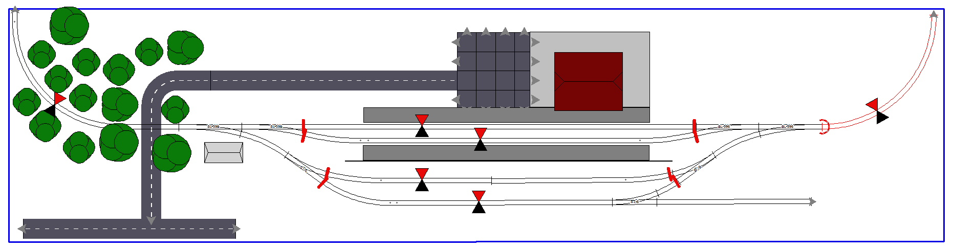

For DC, I would create separate power sections for the curves at each end, and each of the platform and loop lines.   The spur siding can be fed from the loop line.
I usually double isolate all sections (ie. both rails not common return) so I can cab-control with two or three controllers powered from any source.
Something likes this. Works for live frog or insulated frog (I would recommend live frog of course). The diverging ends of the points make a natural position for the isolating joiners.   I would suggest you fit frog droppers now even if you don't plan to include frog polarity changeover right from the start - you'll probably want to later.
You could add a single rail isolating gap and switch on the siding, if you wish to park a loco there.

A slight variation on my previous suggestion for the power feeds, should you perhaps want to stop a train in the platform or loop and run another loco up to the other end to draw the train away, would be to split each of the platform and loop sections in half in the middle.  That's effectively what I have at my station, and the split is actually and conveniently at a board join.
Hi Lawrence - could you clarify; the plan you have posted has the look of one that runs between two fiddle yards (or one round the back) - can't see how you can operate it without an extra board.... ???

Quote from: PostModN66 on November 26, 2017, 08:39:45 PM
Quote from: Lawrence on November 26, 2017, 12:44:27 PM
Cheers Jon  :)
What you see is what you get Jon.  I only plan to run the 2 locos mentioned, the DMU can hide in the trees or the tunnel, likewise the 66 can sit in the sidings area whilst the DMU runs through.  The only reason I curved the lines was to give a little extra length to hide the trains.
PostModN66
Aaah......I see!
Just as a thought, you could squeeze a circuit onto an 18" wide board.  A Farish 158 and a 66 will go round 8.5 inch curves quite happily (they do on my Lofthole layout).
Just saying!
