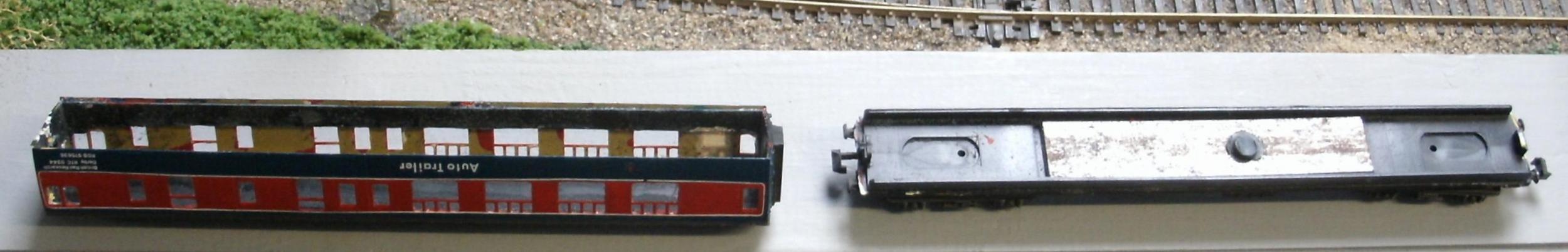

Minitrix coaches have a useful function if you aren't that good at assembling coach kit shells. All my Minitrix coaches were converted to Brass sided conversions, with Clearfix flush glazed windows.
Andy.
Full story and pics at:-

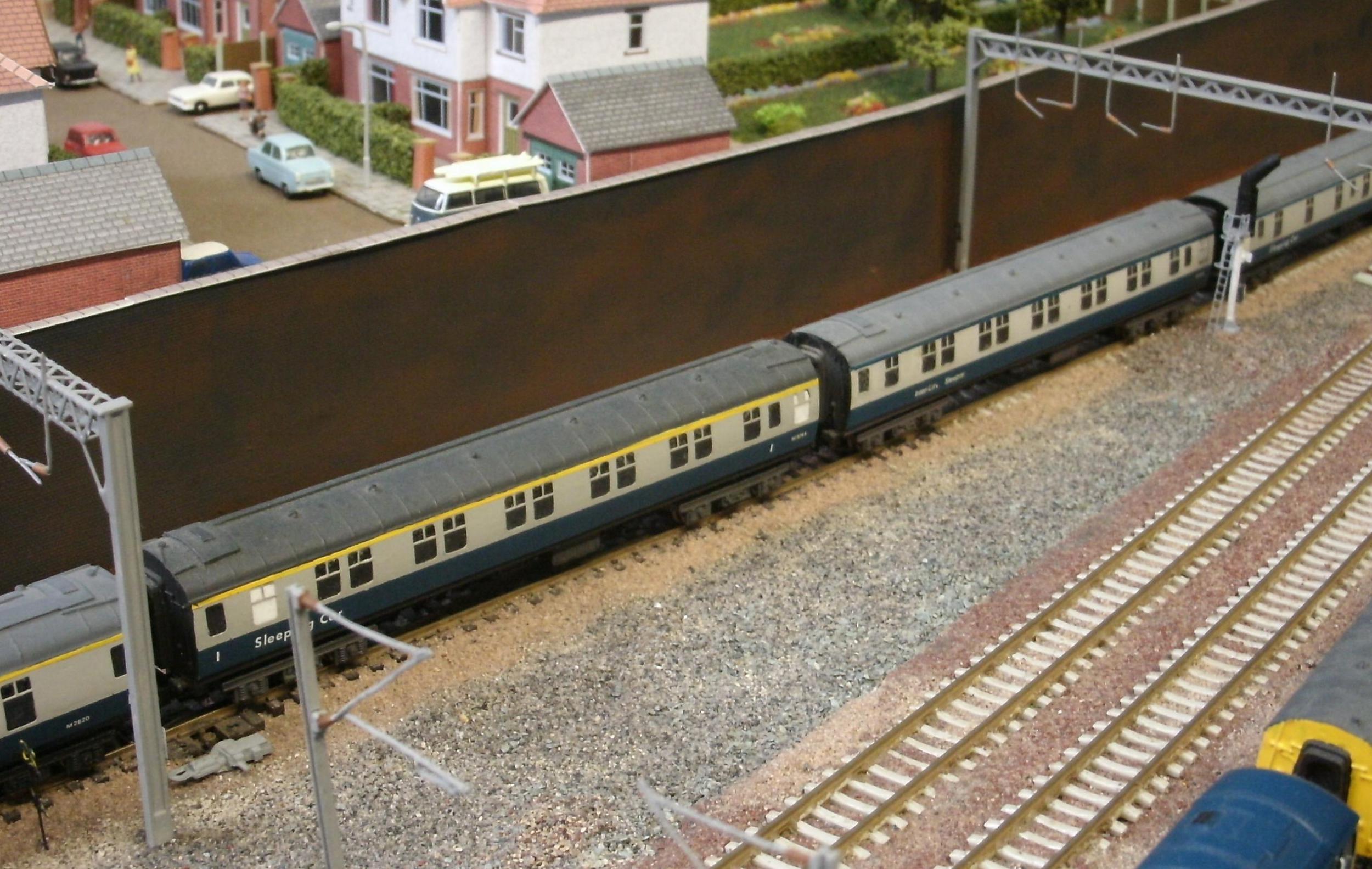

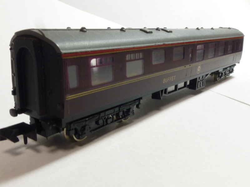

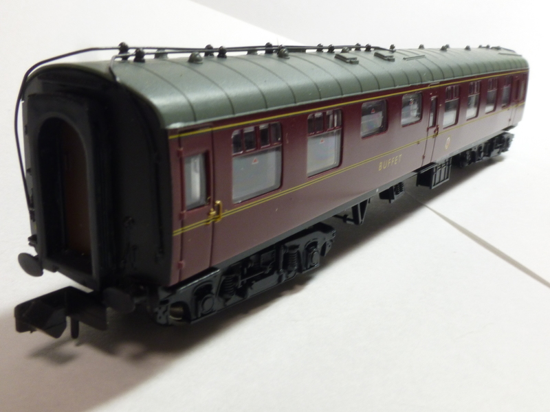

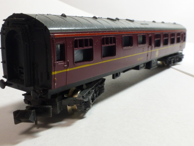

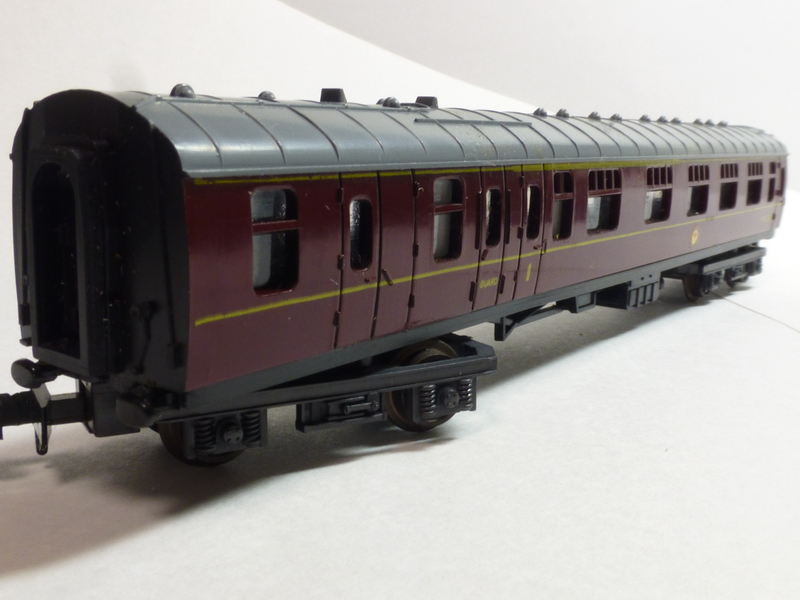

FWIW a quick photographical comparison of N gauge Mk1 models through the ages:
LoneStar (technically OOO, not viable to run on modern N gauge):
Lima:
Mintrix:
Farish (Poole, "printed" sides):
Farish (Blue Riband):
Apologies for the iffy photo quality.
