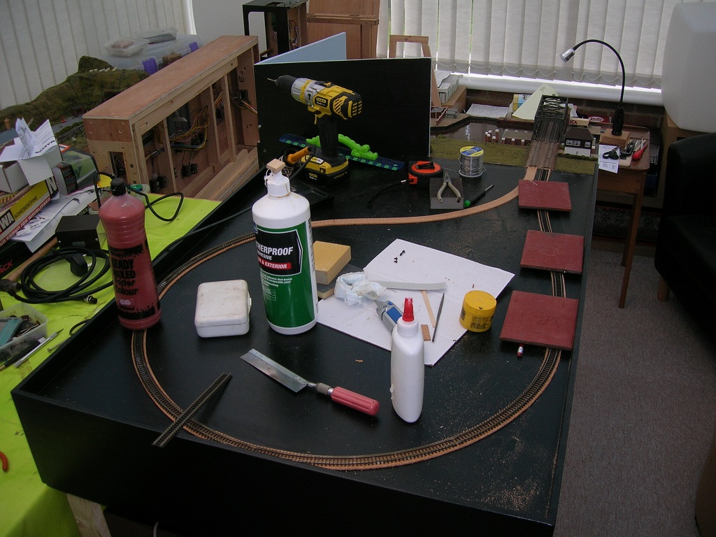

I deliberately used Settrack curves for a return loop I built last year, rather than flexitrack.  It's perfectly fine, it did 4 days at Stuttgart with no derailments at all.
