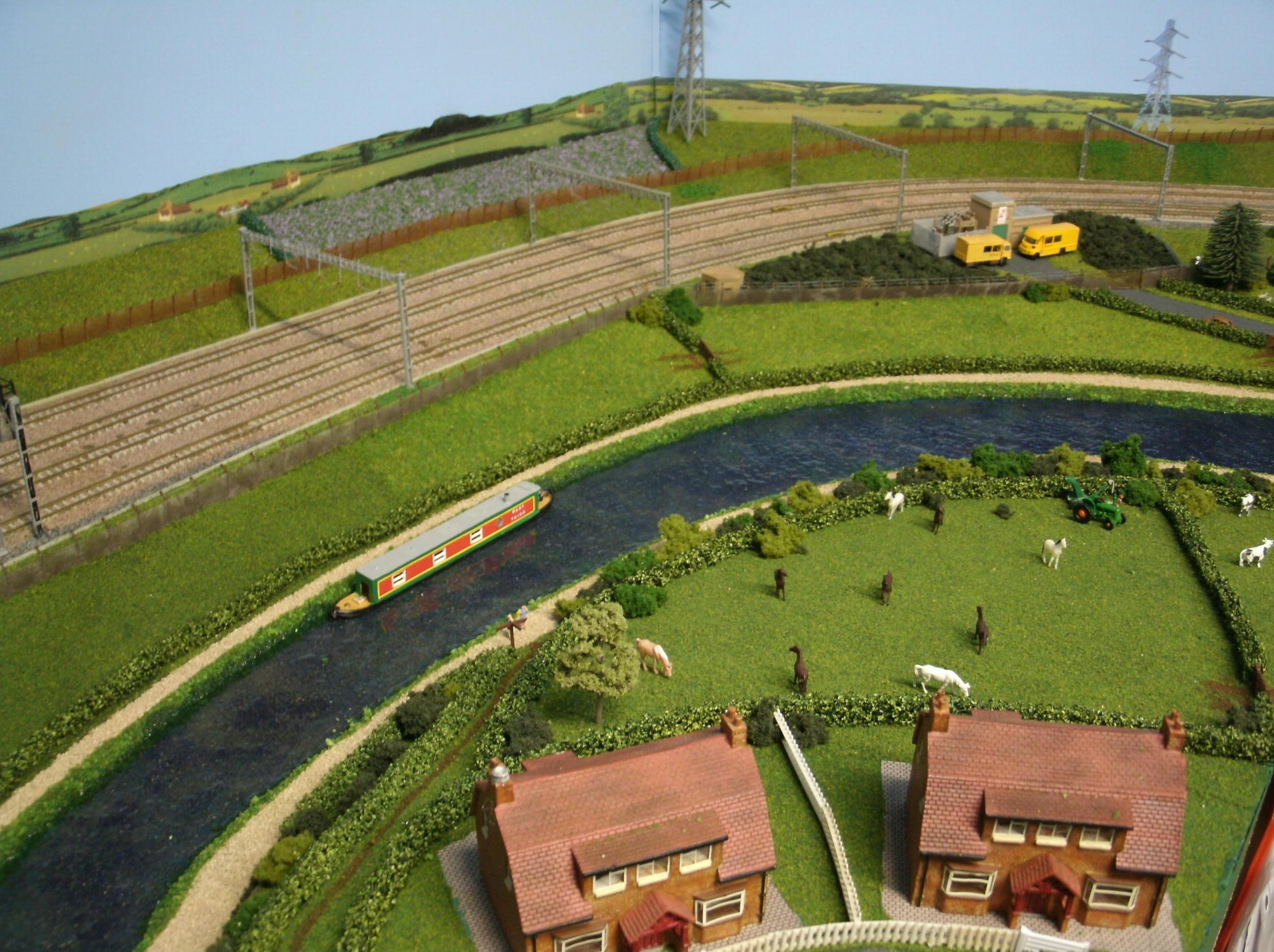

AndyRA
Yes, the NBrass ones are fairly simple to put together. I fashioned the Registration Arms from off cuts of Telephone cable (from another current thread). Found I could paint them with Humbrol 64 matt grey without primer.
Andy.
Full story and pics at:-
