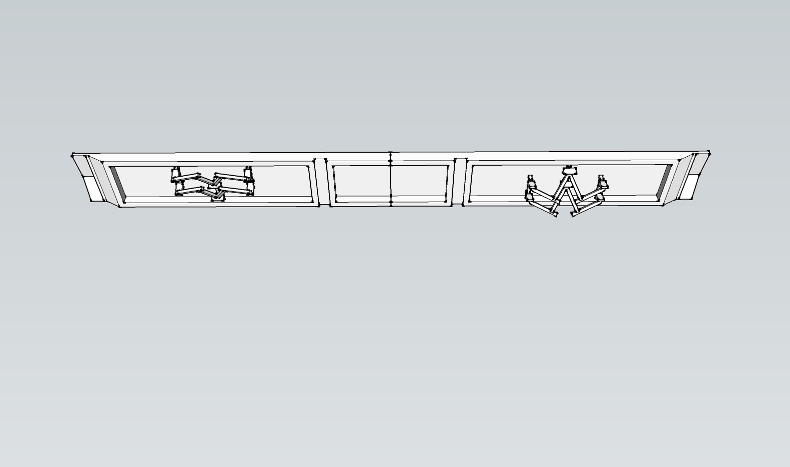

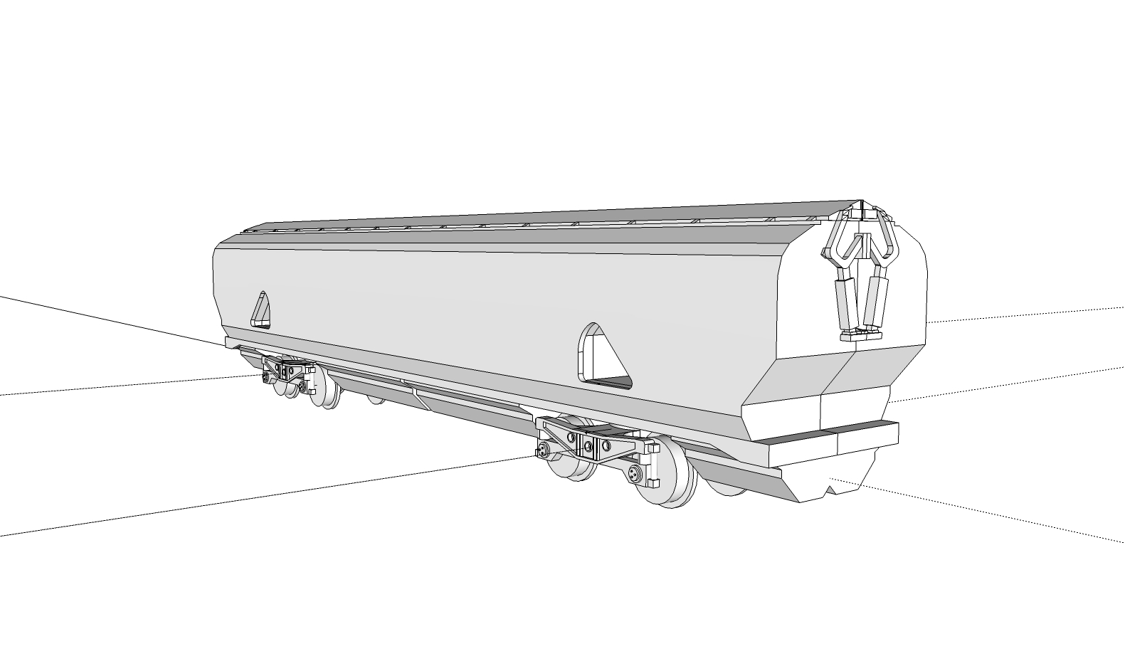

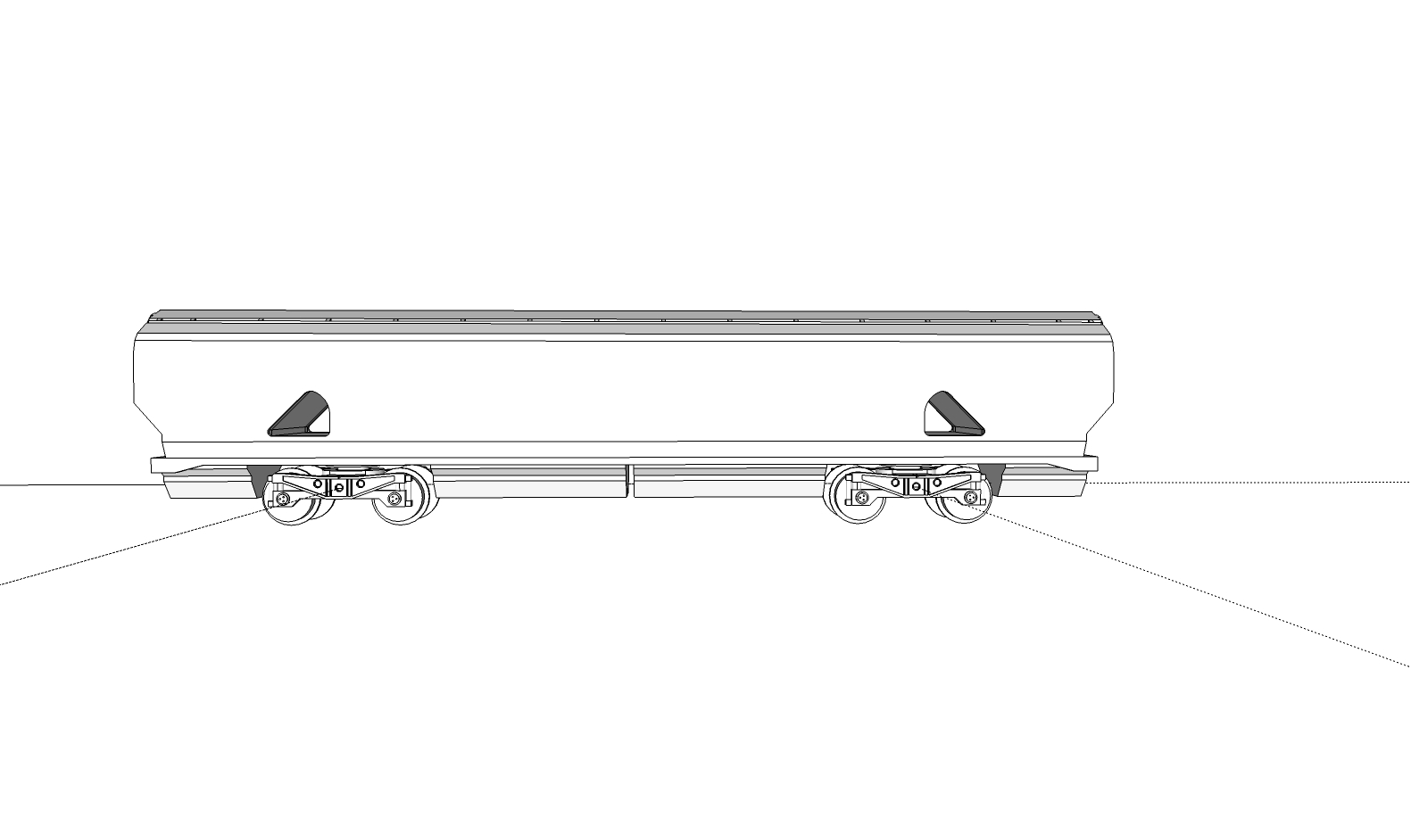

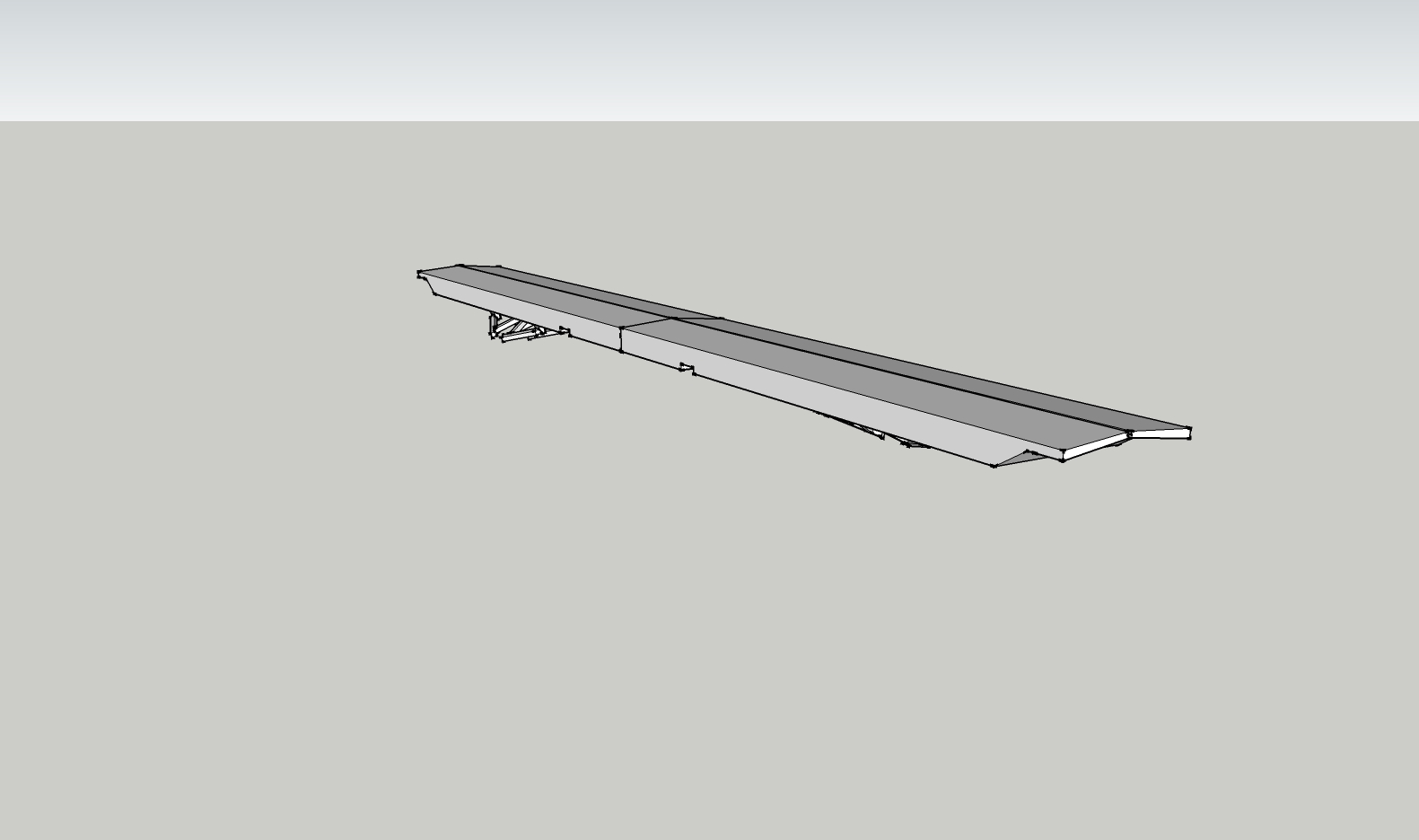

I'd pretty much got the IIA-D to test print stage to see if it was viable, as can be seen from the images below. Still needed to make space for the coupling pockets, fit some brake gear details in the hopper cut-outs and sort out the bulky door lifting gear. The print would have been a chassis, the upper body of the hopper in FUD and the bogies in WSF. I'd still really like to do some of these, I see them quite regularly and they are quite striking compared to other wagons.
