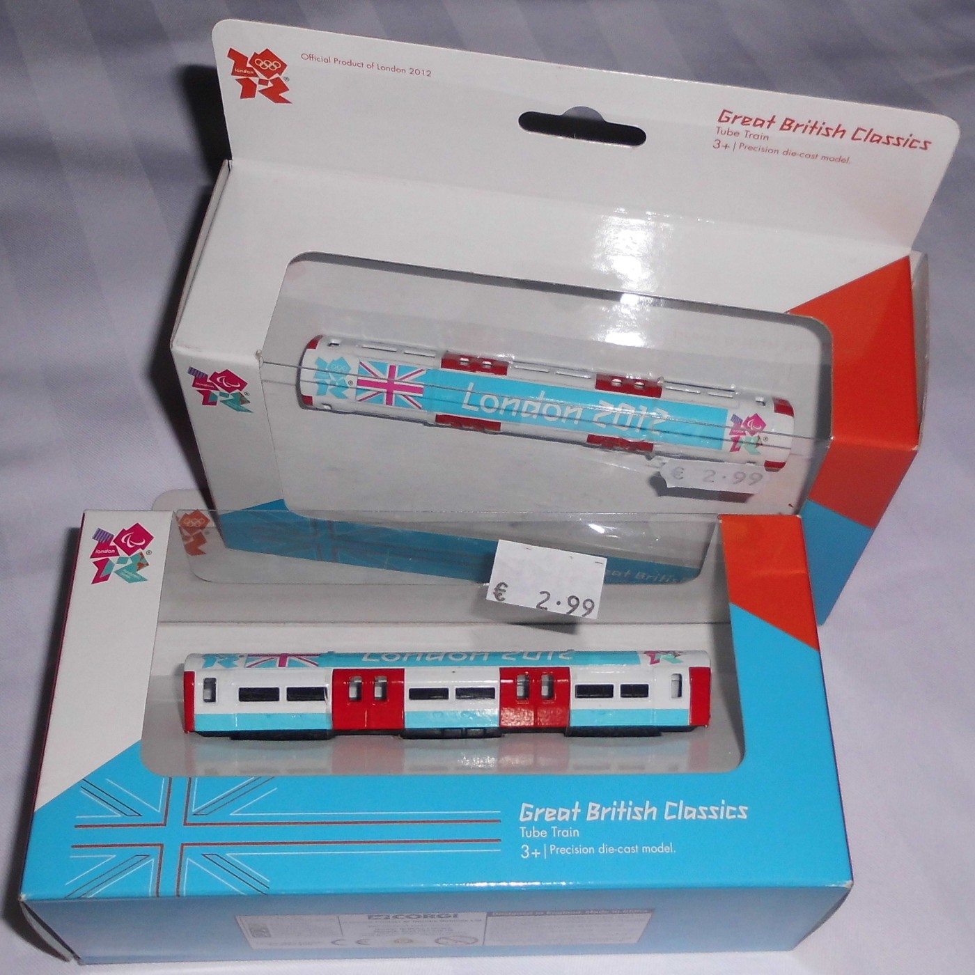

Hi jonclox...
..I got those (May this year / Marks Models Dublin):

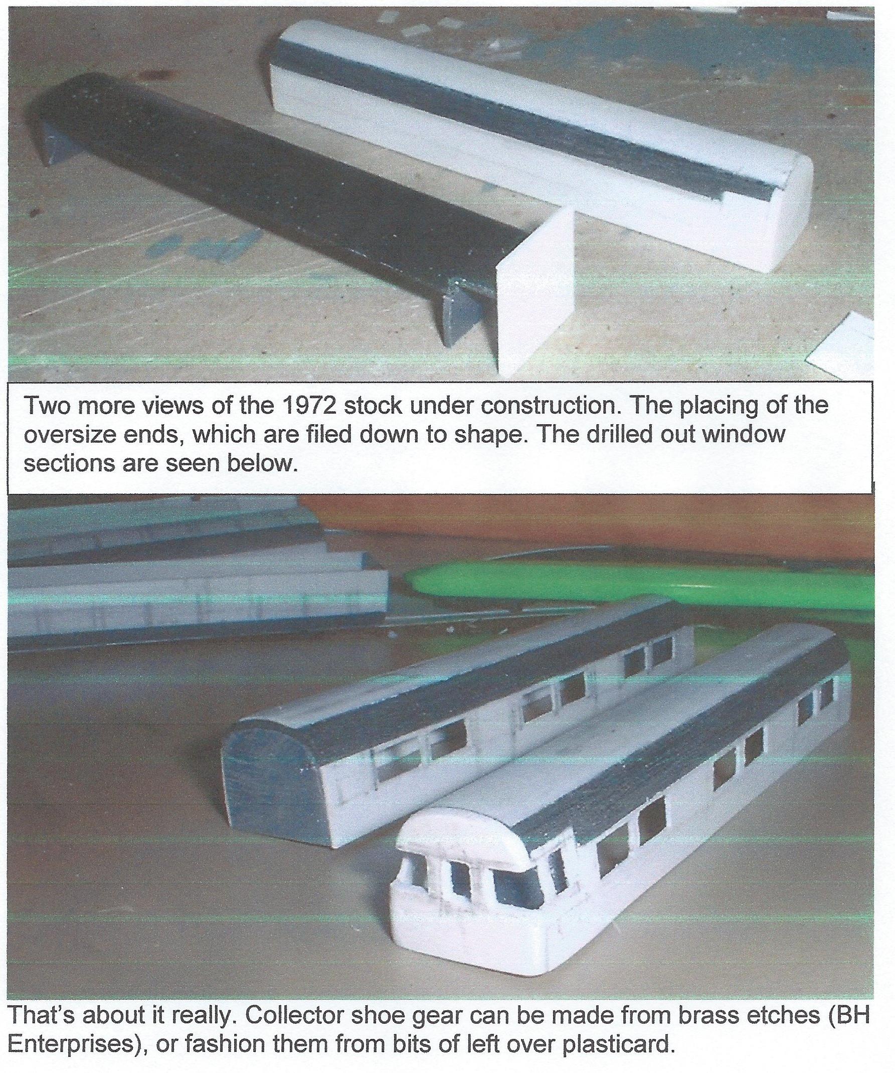

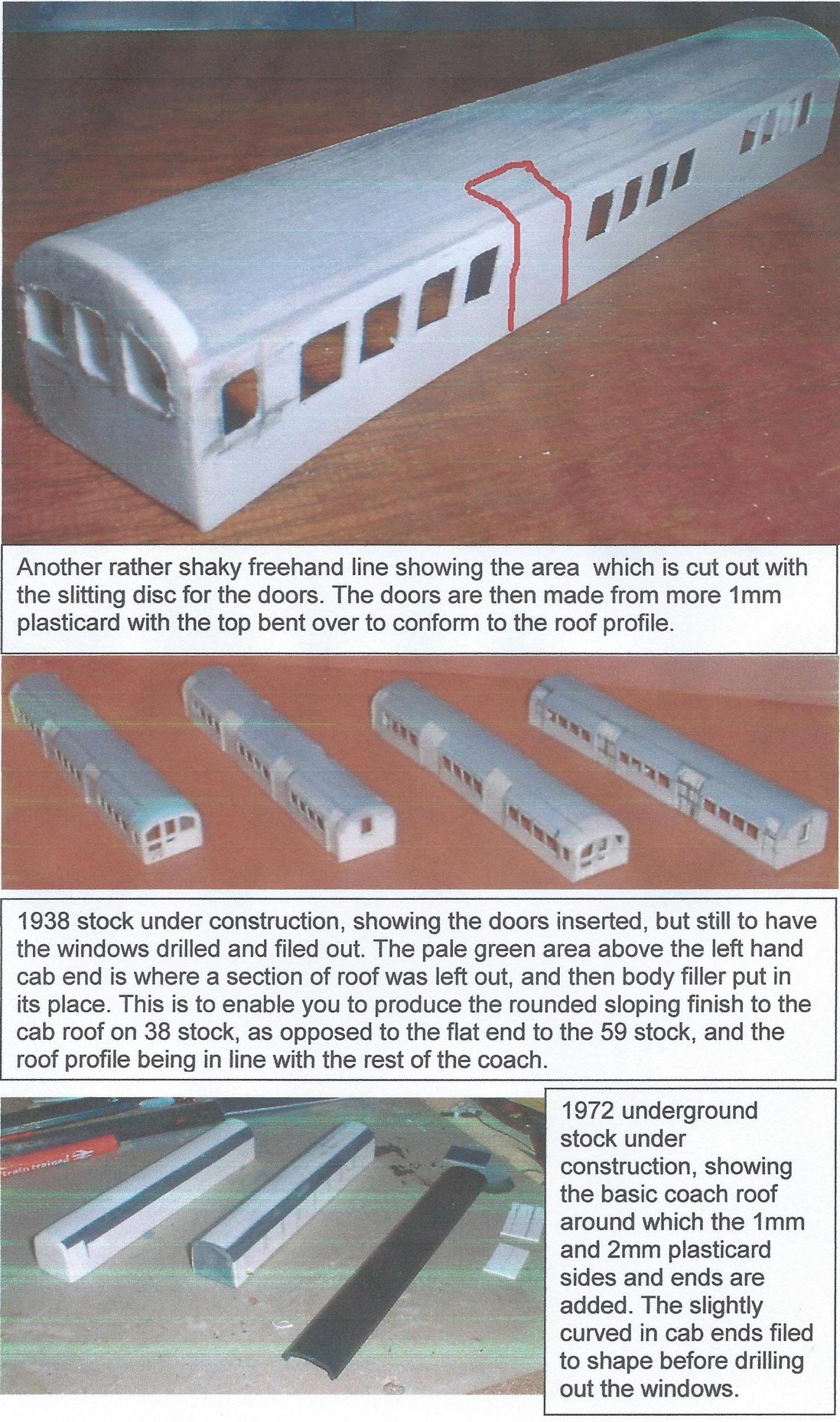

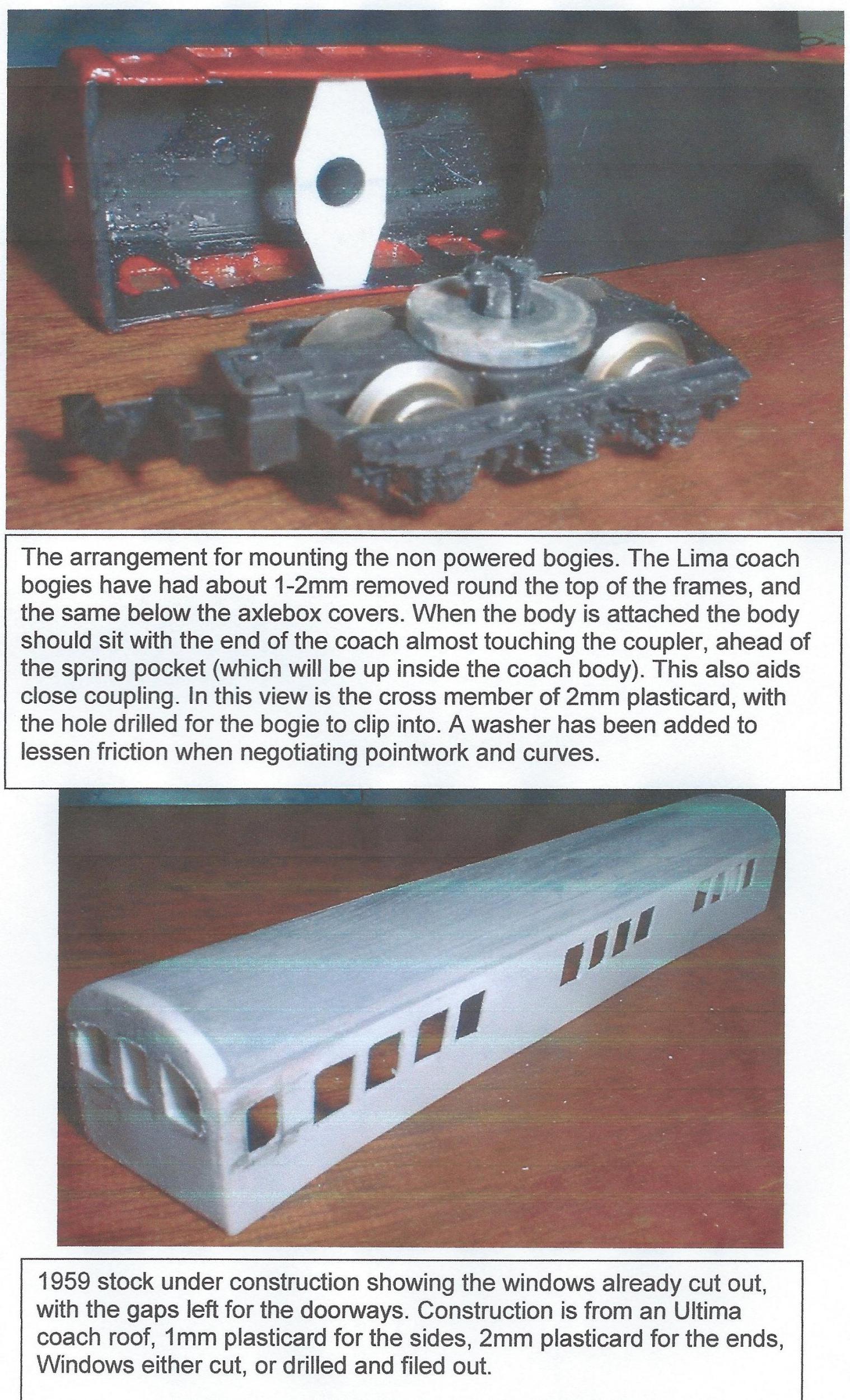

The stock is all scratchbuilt. As they are nearly twenty years old I was unable to find the original photo files. So I have scanned the original article I did for them. Sorry the quality is not brilliant :(
The article included the motorising using Arnold 'Kof' Diesel shunters, but I have since re-motored them with Tomytech chassis. The odd picture at the end was for the A60 stock. These were made from old Farish 101 DMU's. The thin plasticard was overlaid on top to give the doors a recessed look. The windows were then drilled out.

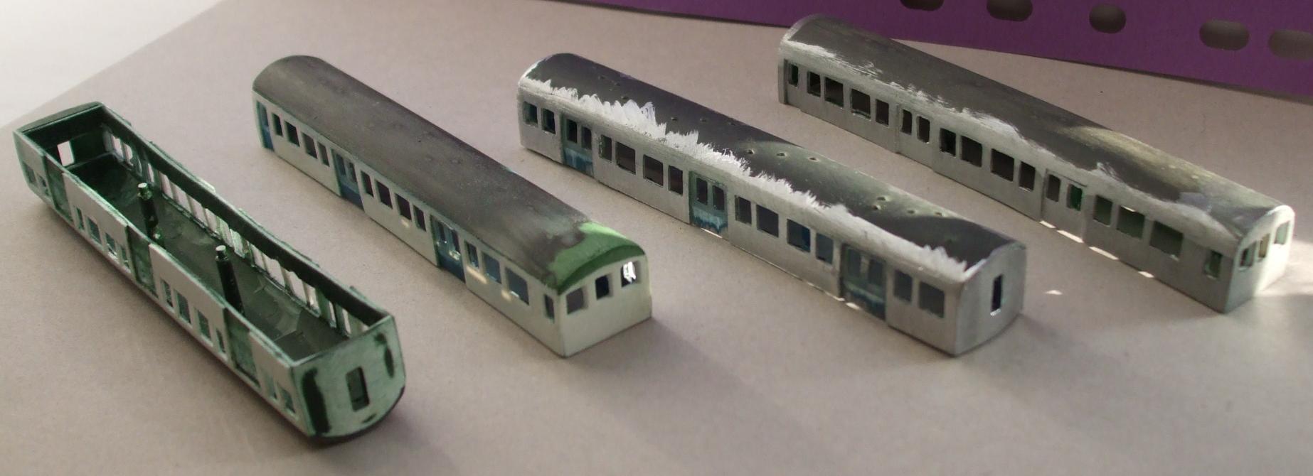

...so...I finally finished my London Tube Project. It is not pefect - I know  :-[ - but I´m happy anyway.
You can watch my short video in YT here:
