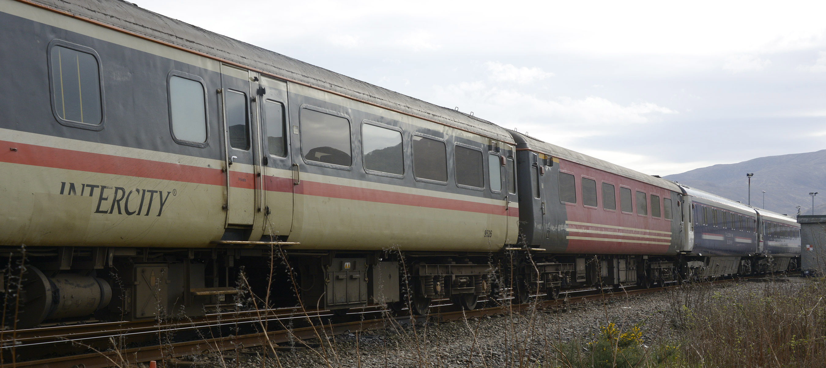

Class 67 heading the Carstairs - Edinburgh leg of the journey, and showing the first two vehicles are far from standard Mk2s.
http://www.asterias.co.uk/kaleidoscape/displayimage.php?album=146&pid=4551

The MK2e BUO was converted from a SO years ago. The windows do line up with those in a MK2e So. The small window replaces a full size window each side, all the toilet windows are gone  and the window in the guards van is in the correct place. The doors are the problem but with a decent starter coach it would be possible to convert if you had etches.
The MK2F lounge car depends on which conversion they came from.
some are nothing more than MK2F FO's with some windows painted out https://www.flickr.com/photos/125049968@N03/24797624585/
Others have the toilet and 2 end windows blanked out https://www.flickr.com/photos/timhorn/6323032974/
Most importantly for us modelers Farish still have the MK2F RFB and MK2F FO listed as being worked on so there is hope for both MK2 Sleeper lounge cars.
