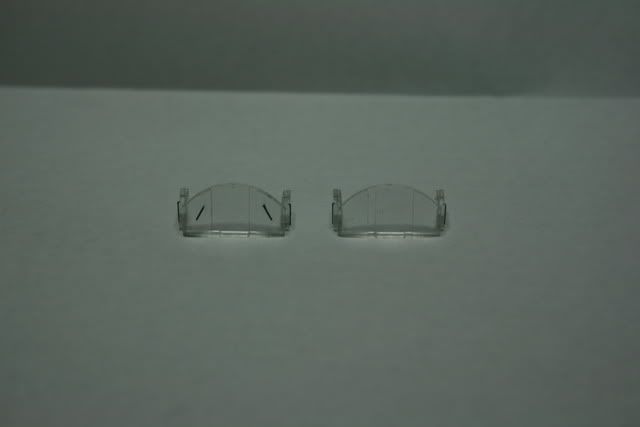

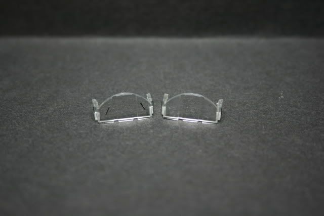

Hi all   :wave:
I have finally managed to remove the wipers from a Farish Class 40 window molding  :laugh3:
I did it by first carefully cutting the wipers off with a brand new craft knife blade
then polished them with one of these
http://transportmodels.co.uk/sandingsticktrigrit-4500.php?manufacturers_id=&products_id=4500
I was a bit nervous at first but as i had a couple of spares i thought i would give it a go
i smoothed off the windows with the course part of the stick then the medium grade
then polished the result with the finest part of the stick
Here are pics of the result  (original on the left)
hope this is of use to someone out there
