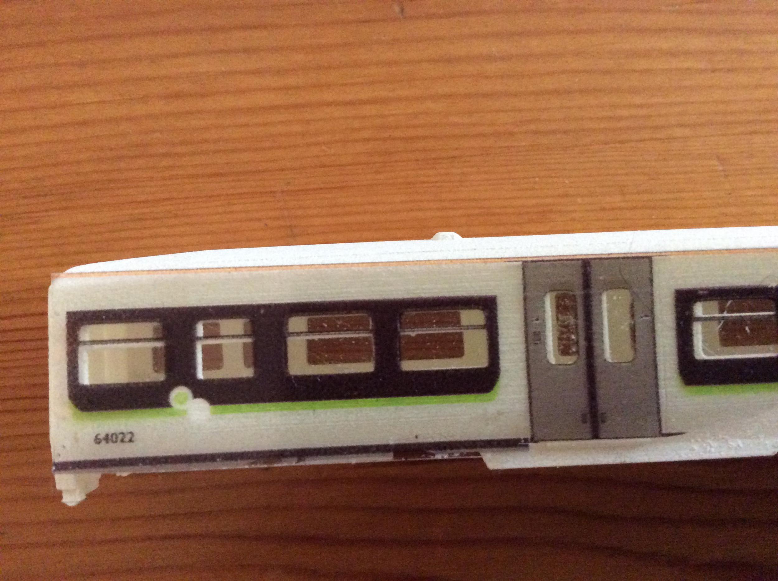

Mine is going to use a mix of 170 and 158 chassis. I bought some of Adam's vinyls intended for the Etched Pixels Farish Mk 3 route. The length is different from the Pete Harvey bodies and the window layout on the Pantograph car does not match the LM version. As a test I photocopied Adam's sides onto some very thin clear slightly tacky vinyl which I bought in the US. It is intended for making labels for glass areas such as warning symbols to stop folk like me trying to walk through doors which are not open! Anyway I think it might be a solution. The photo shows a damaged print overlaid on a white primer body. Glazing is flush but some resizing is needed. I put this to one side when my cataracts deteriorated rapidly. Feel the urge to get back to it now.
Just checked the material - Avery Window Pictures which is available via Amazon.com at least.
