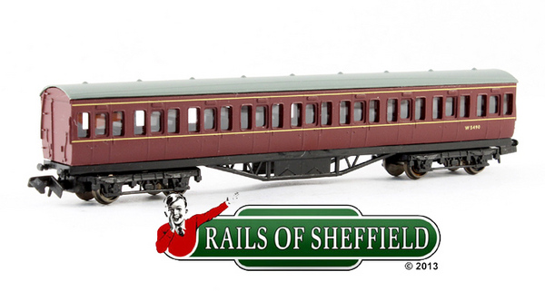

Just recently a few of these early coaches have been appearing on eBay. Out of interest can anyone put a date on when they were produced in this packaging?
I'm probably wrong  ::) but I would estimate it dates back to around 1964.

Having read the thread linked above I would say that the packaging pictured is the original Graham Farish packaging from 1970 to 1972/73...

The coach in the picture here is similar packaging to the 94xx and I would say dates from circa 1971/2. Soon after this the packaging changed to cheaper plastic tray in card sleeve and then "blister packs".

That is fairly early Farish N (and Farish N started in 1970). I have one that I converted to an LMS compartment electric back in the mid-1970s and it was old stock then (I think purchased at ACE Supplies, Manor Park). The unpainted coaches were first produced in early 1972 (advance sample shown in RM April '72) and were replaced by painted ones in late 1972 ('Superstock' range, advert Sept. 72 RM) when they went to smaller window boxes. Since the non-corridor versions came just before the corridor stock it is possible that the latter were never released in unpainted form. The four wheelers were released at the end of 1971, but the unpainted ones were in smaller non-window boxes without the separate flocked tray.
So, in answer to what date, I can safely say 1972.

BernardTPM
