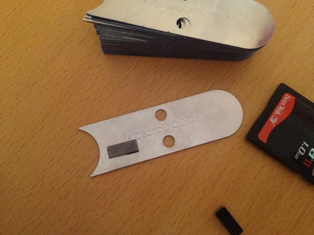

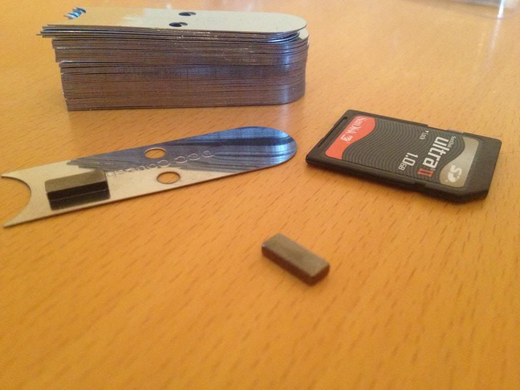

I received the value pack of Powerbase yesterday. There is enough product for 5m/16ft of track and enough magnets for 6 locos (although that will depend on the number of driven bogies, etc.)
I will get a chance to experiment with this system On Friday and so i'll report back then.
In the meantime here are a couple of photos of what you get in the pack and their sizes. That's a standard SD card for scale.

Not quite Peter.
That's what I thought initially. The plates re not magnets, they are steel, but obviously magnetic. The only magnets are those fitted to underside of the engine, preferably between the driving wheels.
They are neodymium magnets I think, and so quite powerfully. There are YouTube videos showing the OO version in action on 1 in 30 inclines and it appears quite impressive.
