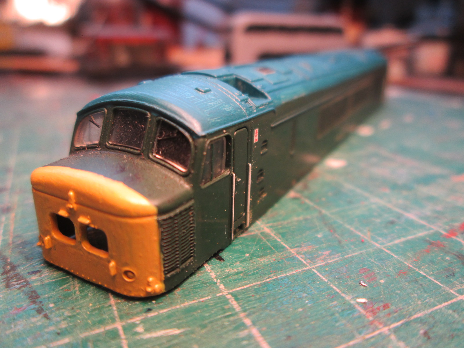

KevTheBusDriver
This week... time to repaint a Farish D67 to convert it to 45012 in blue. Photo here of it at teatime today; it has all glazing removed, full yellow ends and a blue roof:

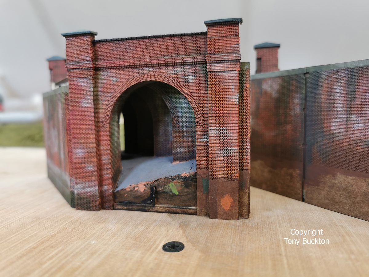

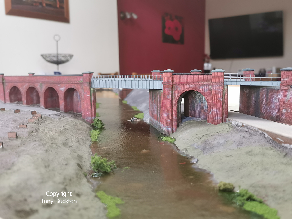

Albion47509
Building a viaduct before laying finescale track. Brickwork and bridge spans laser cut designed in Lightburn and cut with a Creality 2 laser cutter.
