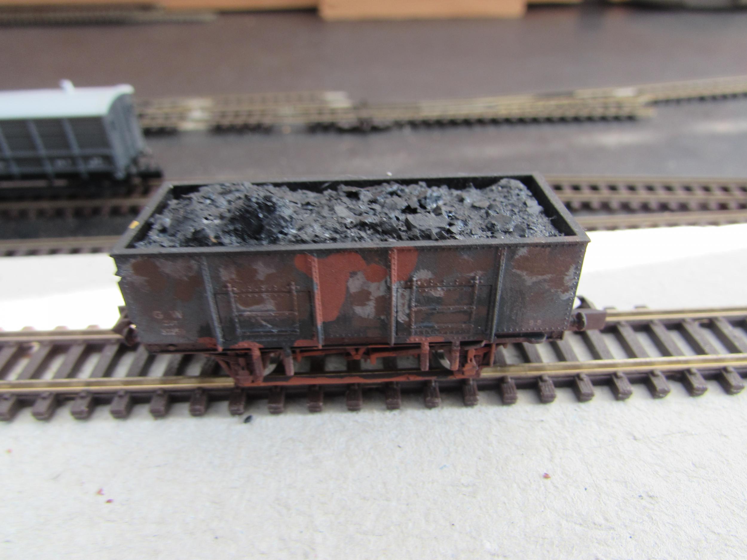

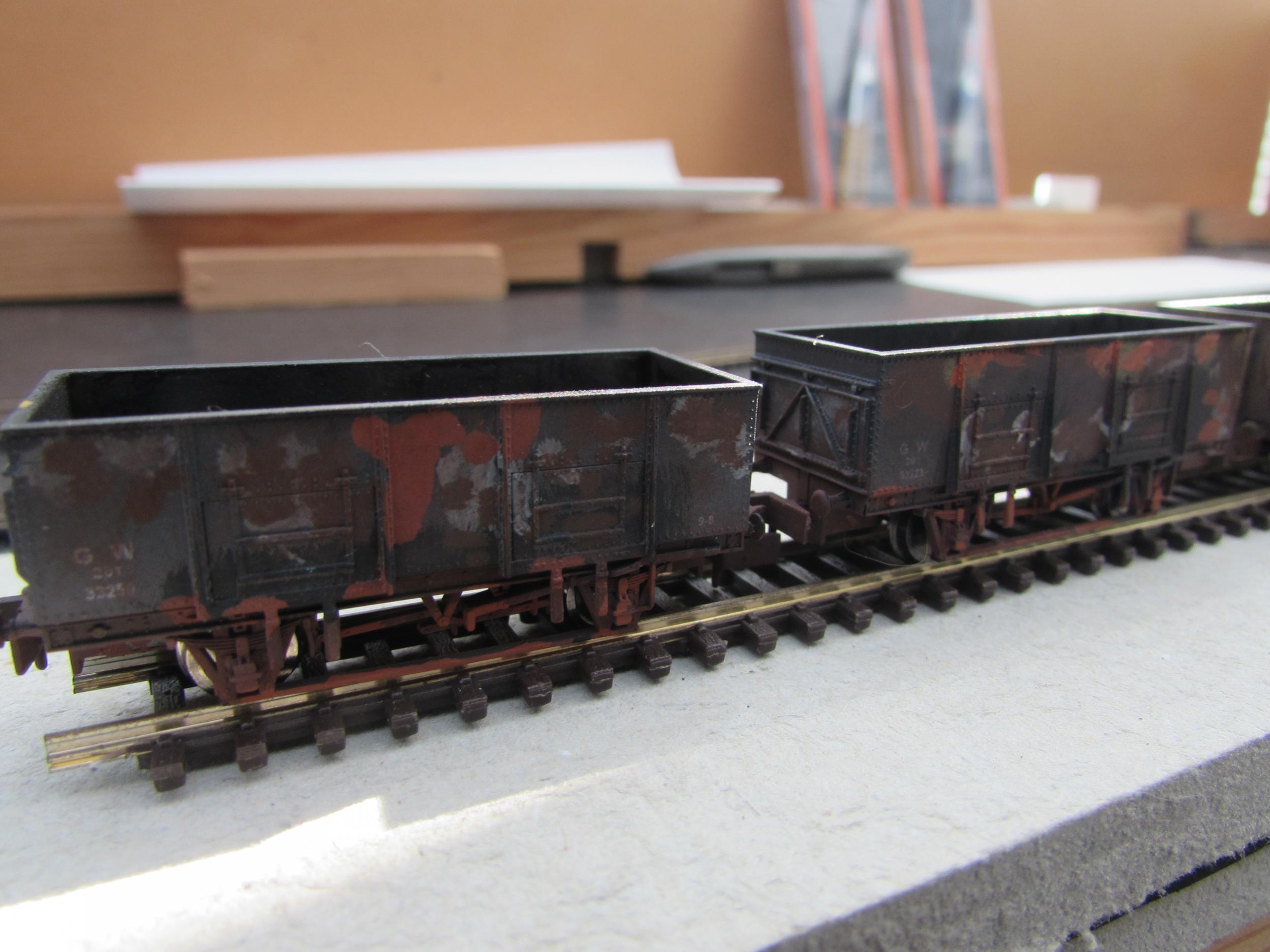

This morning I finished off my little project so here's some evidence of my poor workmanship.

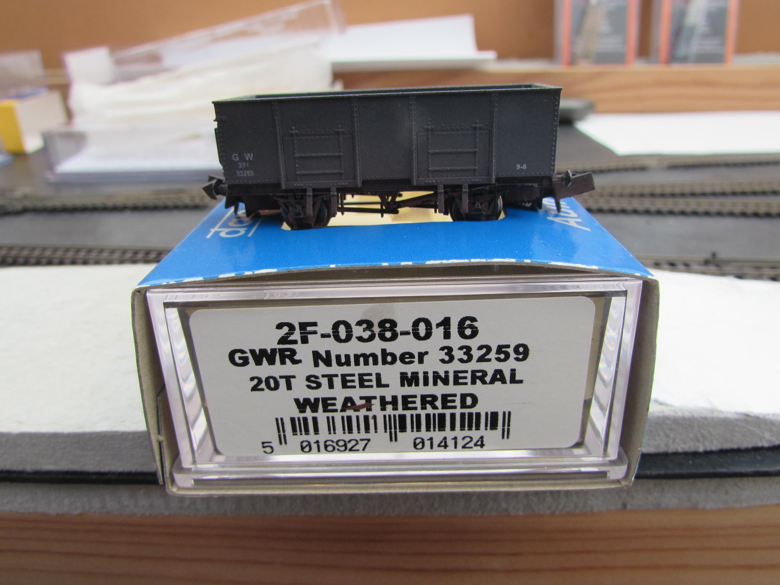

I took 10 of these (paid for by selling some of my Collett coaches) and decided the weathering was merely dust and not much else ::)
Along with some grey and black acrylics (not in the same bottle you understand) and some of these I set to work...
Once I was happy with a really grotty/on their last legs finish I gave them a coat of matt varnish......

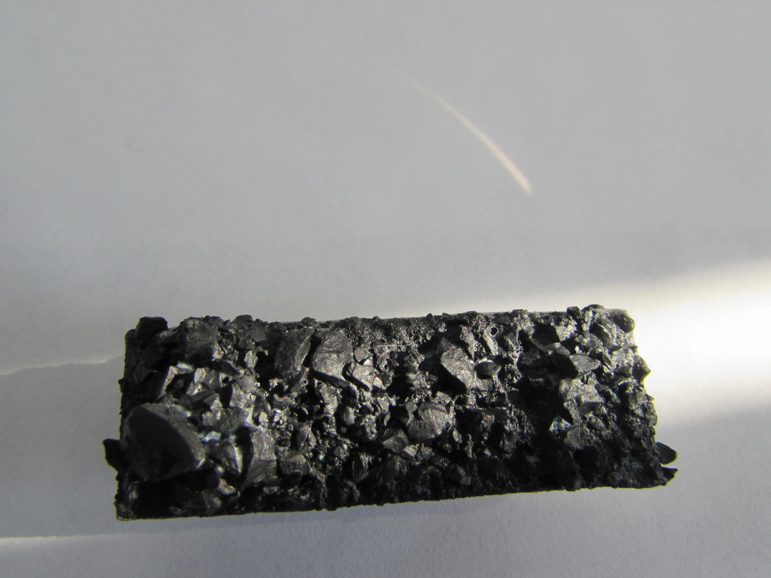

The coal loads were made from 2mm thick picture framing card obtained from a shop in Preston £1 for an A4 sheet :D) which was cut to size with a modelling knife, PVA glue applied and crushed real coal spread on it (of which more later). When dry I brushed off any excess, spread some more coal and then went over it again with a ballast mix (50/50 PVA/water with some washing up liquid) applied with an eye dropper. Finally, to avoid getting coal marks everywhere I matt varnished the load too.
To the underside I glued (PVA) a piece of 6mm square plastic and a washer.....
The finished article. I'm not sure the camera has done it justice with a cruel close up as the coal looks more like black sludge than actual coal :-\
Was it worth the exercise? Yes, I enjoyed the weathering although even I would admit to being somewhat heavy handed with it but, in my defence, I did want a very filthy finish and wanted to try out my paints. Sorry, but @dannyboy the coal was not the best idea I've had as it was a pig to break down to somewhere near correct size, was hugely messy and seemed to get where I didn't want it to get and, to be honest, I wouldn't use it on loco bunkers/tenders :no: I'll use packet real coal for those e.g. Peco.
Before anyone shouts "YES - BUT WHAT'S THE WASHER FOR!?" the idea was to use a magnet on a stick (e.g. the extendable Rolson one I have) to lft out the loads so I can run empties/loaded as I desire. The magnet has turned out to be too weak to get through the lacquer/coal/glue and card so is only a partial success. However, with a better magnet it would certainly work. As it is, by pressing on the end where there's a gap in the square plastic the other end lifts up and they can just be picked out of the wagon.

I have to agree with the above comments Mick, your weathering has turned out to be pretty good.  :thumbsup: Not sure what you did wrong with the coal, it works perfectly on my open fire and when I fill the bucket up, it looks very realistic!  ;)
I can't afford a tea strainer, or to get nicked for stealing next door's wife's tights off her washing line so I can only guess there was too much coal dust which became a sludge when wetted with the glue mix. It does actually look better than that cruel shot.................................honest.
Hailstone
Quote from: Newportnobby on May 27, 2018, 08:28:21 PM
I wouldn't worry too much Mick, if you are modelling the transition years there would be wagons like this which would almost certainly end up in a loco firebox as some depots, particularly freight ones got some real dross in the 1950's and 60's
I have a takeaway box half full of real coal that I crushed some time ago and I shake the box until the dust moves to one side and then pick the size of coal that I want with my fingers - hope this helps
