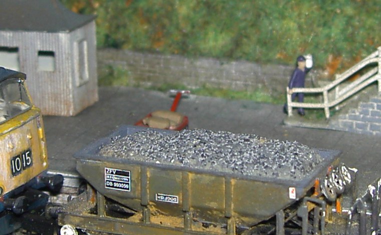

i also need to put ballast in some dogfish hoppers, will presumably need some foam for this and then ballast on the top of it....

With my dogfish I have used peco wagon loads filed to shape. I do not have them to hand but I believe that it is just the ends that need filing down to fit. The peco loads look better if weathered. I use very very dilute enamel paint (mainly thinner with just a brush tip of paint).
Elmo

I used Ten Commandments ballast loads painted with faller 'granite' paint, which really does paint this speckled colour thats like ballast .

HAA, HBA, HEA and HFA : [Chivers Fine Lines normally]
Dapol Dogfish : Jacksons Models / Saxondale Loads 2M06
HTA and HHA : Jacksons Models / Saxondale Loads 2M09
I have fitted several Cast In Stone (Ten Commandments) to HTA and HHA wagons
However they are narrower and heavier than those from Saxondale
The disadvantage with the Saxondale ones is they need trimming down in order to fit within a HTA or HHA, but better that than the gaps with the Cast In Stone version
