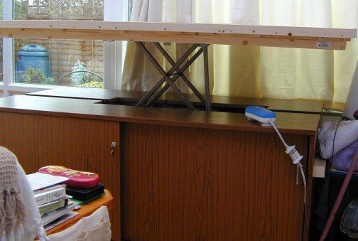

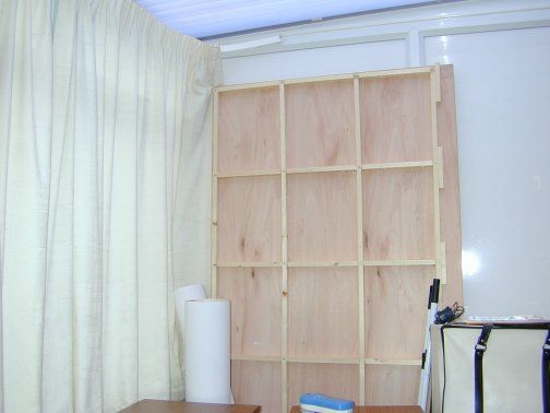

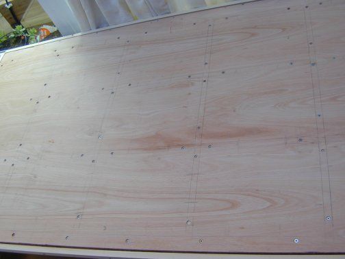

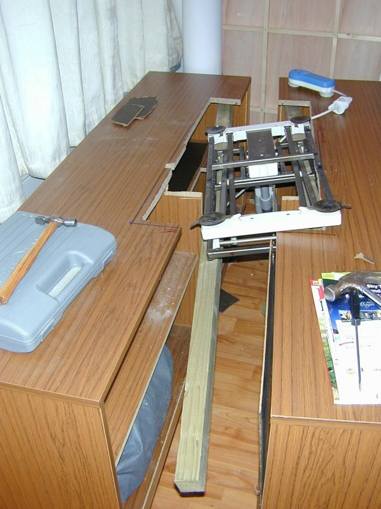

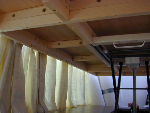

Hi, As I'm disabled I need to raise up the base board rather than bend down to add wiring point motors etc.
I had thought about using hydraulic arms like the hatch/5th door in a hatchback car, but that would not have given me a controlled movement. Somehow I managed to get a link to a bath lift in my search, but at £300 plus that was too expensive so found a secondhand one on ebay for £35 took a chance. I got my car mechanic to cut two end bits off and drill a couple of holes where my diy tools just didn't cut the mustard. Here's how I did it with photos to show what I've done.
1)First I had to make the frame, by cutting the wood to lengths, drilling holes
   for the wires and inter locking joints; this I could do on my own. (photo -board lift2)
2)I then got the local timber merchant to cut the large sheet of ply to size( photo- board)
3) Then I attached the frame and a second frame underneath.
4)I had 2 low level book cases which Peter attached 2 sets of wheels with brakes.
5)In these  I cut out spaces for the bath lift.(photo- base 2)
6) My car mechanic used an arc welder to cut off bits I didn't need and drilled holes.
7) My carer moved the ply & frame into place (photo- lift up)
8)I drew an outline to show where the frame was underneath (photo-board flat)
I had help to lift the bath lift into place, the board on top and the wheels onto the unit.
I'm goining to use a mirror on a short pole or a video camera to see where I need to thread
wire etc.. I have no idea if its all going to work but I'll keep you informed. :Dftp://
