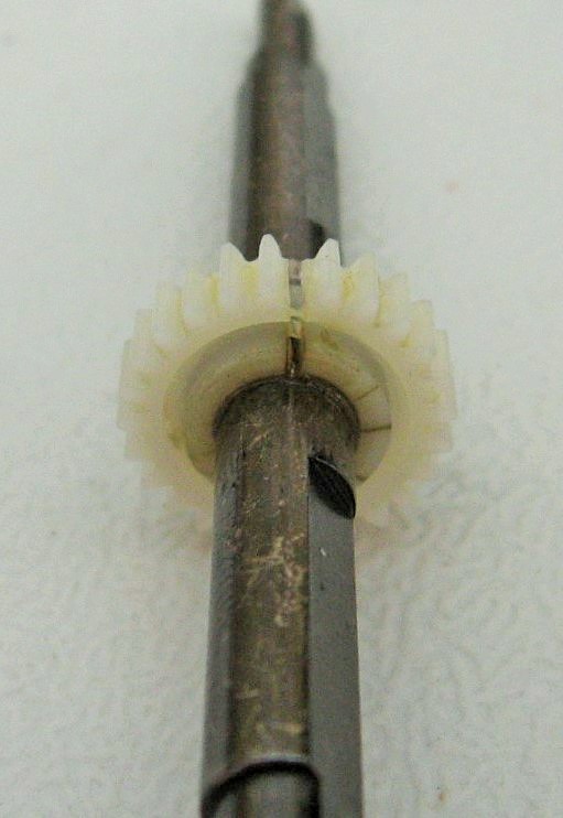

It's a known issue with Farish gears :(, hence my previous comment. It just seems to happen randomly, other manufacturers are not affected in the same way.
Here's an example:
Farish (Bachmann) split gear by Rail Squid, on Flickr
(head of the screwdriver is pointing at the split).
Loco still runs, but with a "clack clack clack" sound, and if kept running would quite likely lock up, which would damage the motor.

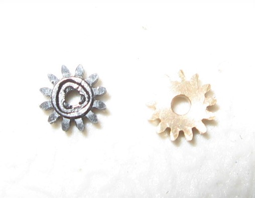

This is why I have a baggie of these:
Bachmann 16 tooth gears by Rail Squid, on Flickr

Farish aren't the only brand which suffer split gears though they seem to have had more than their fair share.  I have replaced a few gears in Arnold, Minitrix, and Roco locos,  and even one Fleischmann loco.
If I can, I replace with brass gears by firms such as KH Modellbahnbau.  If I cannot find a stock replacement I'll get gears made up by Kkpmo Mikroantriebe. Not cheap but reliable delrin.
The main cause of splits seems to be an overtight interference fit. Over-oiling doesn't help either.

Quote from: railsquid on November 28, 2020, 01:57:26 AM
In old Pre-2000 locos this is largely true, but the newer locos it's much less common, and very very commonly linked to a moulding deficiency.
Halving a split gear, you'll find it very common to see a moulding bubble or void at the point its split - I've seen this repeatedly on post-2000 models, and almost always when a newer model has a split. Fortunately it happens much less commonly - but it is a manufacture issue, and still happens across the Farish range - even new tool DCC ready tender drive models, I've seen a couple split gears - those being a completely new moulding, different diameter and tooth count.
Farish seem aware of the problem though - there seems to have been a gradual move to white nylon gearing more and more - which is good if they keep that up as those seem much less prone. Honestly, if this is more expensive, I'd rather just pay, knowing that it much diminishes the risk of future failure.
When replacing, use a taper broach to ream out the central gear hole to lessen the stress on the gear - thus if the replacement also has a void or a weak spot, it should be much less prone to splitting again. Plus, it makes them easier to get on the axles! Ideally they should slide on reasonably easily, but you also don't want to make them too loose such that they risk slipping on the axle.
HTH,
Alan - replaced two on Farish class 46s last night!

The vast majority of my Farish collection is Bachmann-era, if memory serves correctly all the split gears I've experienced until now are among the older Bachmann locos (all diesels) which came in the boxes with the grey foam inlays (whether split-chassis or DCC); this is the first one I've experienced on a loco from the more recent transparent box-in-a-box runs (for reference this is 371-088, date stamp on the cardboard outer packaging is July 2014).
Quote from: Dr Al on November 28, 2020, 11:11:59 AM
So, I just went to replace the gear, and the first one I got out of the little baggie pictured above fitted very tightly onto the axle and was impossible to push over the raised section in the middle. The next one I tried fitted firmly as per previous replacements (all of which have been just fine). Which makes me wonder if there's some degree of variation in the diameter of the hole with some being a little too tight (but forced onto the axle during manufacture) and the slight excess pressure causes them to eventually split... As far as I can tell the offending gear is a straight split with no obvious bubble/void.
