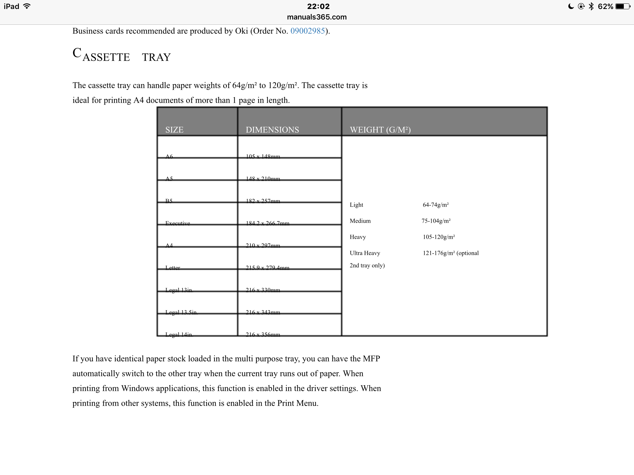

I want to laser print to OHP transparency film, but my printer does not have a specific Transparency setting.  Not wanting a fuser gummed up with melted Film I phoned OKI support, useless, all he could ask was "what is the weight" I tried explaining that a transparency would probably need a lower fuser temperature than paper (having spent ages pursuing the topic on Google) but all he did was repeat "what is the weight". I've also tried Acco the suppliers of the transparency, awaiting an email response from them.
Apart from weight settings from Light to ultra heavy the other settings are for Labels or Glossy plus some User options with no info on what or how to set them.
I'm tempted to use "Glossy" but the gummed up fuser vision ... ... ...  :help:

I've got Laser printer film, the printer is an OKI C531dn colour laser; I've printed OHP film on a previous colour laser, but that had a transparency setting option, what I'm after is an equivalent setting on this printer.

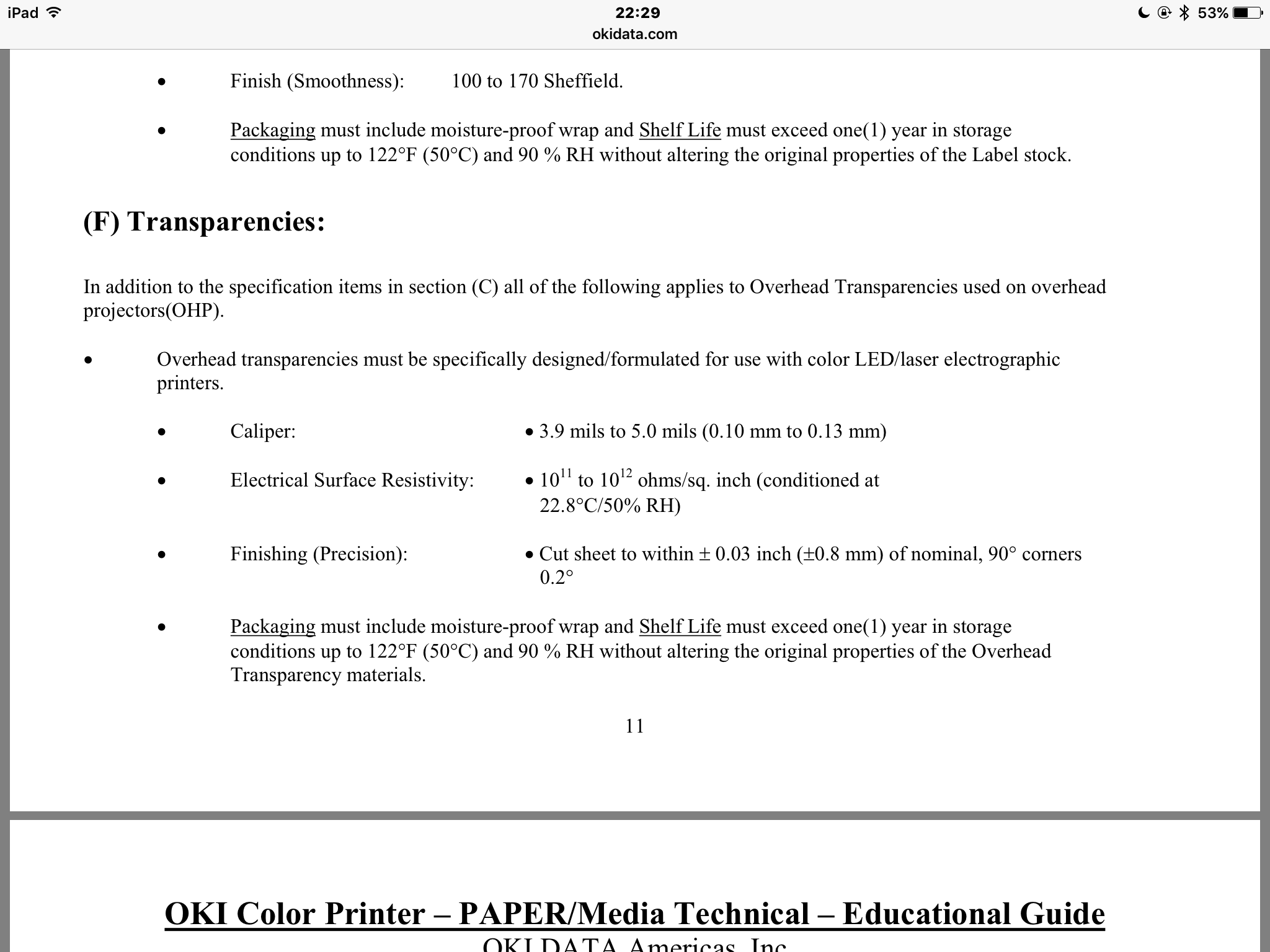

The only reference I can find on the Oki site is this
Transparencies should be of the type designed for use in copiers and laser printers.
We strongly recommend Oki transparencies (Order No. 01074101). In particular, avoid office transparencies designed for use by hand with marker pens. These will melt in the fuser and cause damage.
I suggest that the pack of transparencies will specify a weight/M2 and hence you can set the paper / transparency weight in the App
Or ring Oki again and ask for settings for their sheets? Colour sheets seem to be fairly standard ( 0.10-0.13 mm thick) for a range of printers
http://www.okidata.com/documents/downloads/oki-media-guide.pdf

The transparency film is labelled for use with Laser printers, there is no weight quoted on the packaging nor on the info sheet in the package. Some printers have a transparency setting in the setting up menu, mine does not. I saw that info you posted when googling the subject yesterday, I don't consider it has  sufficient information. I've had problems with OKI Tech support before, I also print quite a few labels, there are two options for labels, when I asked what the difference was and which I should use they did not know what the difference was, they suspected it was weight but did not know for certain, nor could they suggest which was light weight and which heavy.
I taught electronic servicing both in the RAF and industry, I also was employed for a few years on repairing printers so I consider I am reasonably conversant with the subject. That is one of the reasons I am reluctant to just load the transparency and hit print without trying to find if there is a known correct setting which will not result in a ruined fuser drum. Wouldn't be surprised if a new toner unit turned out to be more expensive than a new printer!
