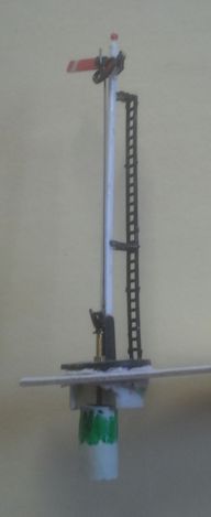

I'll start by stating the obvious in that I'm not real good at photos! The main photo of the signal below looks a bit odd because of the angle (or something). It looks better in real life. This is also my first attempt at uploading photos, so please bear with me!
I'll start with a photo of one of my signals out of the layout:
This is based on the Ratio 260 lower quadrant (GWR) signal, but should be adaptable to the upper quadrant version. I wanted to make signals that I could remove easily from the layout. This was achieved by making it so that it would fit snugly in the hole drilled for it in the baseboard. I have removed it from the layout and mounted it on a sheet of card for this photo.
A section of white styrene tube (around 11mm diameter) is glued to the signal base, after cutting away a section to leave room for the weight that you can see hanging down below everything else.
The Ratio kit is made as per the instructions, taking care to leave the signal arm free to rotate on the pivot. I used a Peco track pin for the pivot. Control is (from the top):
-   a length of 15 thou piano wire with a double bend at the top
-   looped through, and glued to, the loop at the top of an M1 (or so) eyebolt
-   the nut on the thread of the eyebolt gives the adjustment for the horizontal position of the signal arm
-   the bottom part of the eyebolt goes through the hole in the Ratio signal base and screws into the cylindrical weight. The weight is made up from Milliput or similar and also acts as the push point for the servo.
-   the servo is mounted next to the signal with its axis horizontal. To turn the signal on the servo pushes up from the bottom. Adjustment for the on position (slanting down) is done by adjusting the servo travel. The servo travel is only critical at the 'on' end as the signal arm stops at the off position anyway.
I use the 'standard' cheap Towerpro 9g servos that many of us use. The servo controllers are MERG Servo4s.
The holes for the control apparatus in the signal arm and the base are as provided in the Ratio mouldings.
None of the dimensions and sizes mentioned above are critical.
The lenses were made using Micro Krystal Klear (as often used for road vehicle windows) coloured with food colouring. I've made no attempt to provide a light, but that would probably be fairly easy to do with the small pre-soldered SMD LEDs that are available these days.
