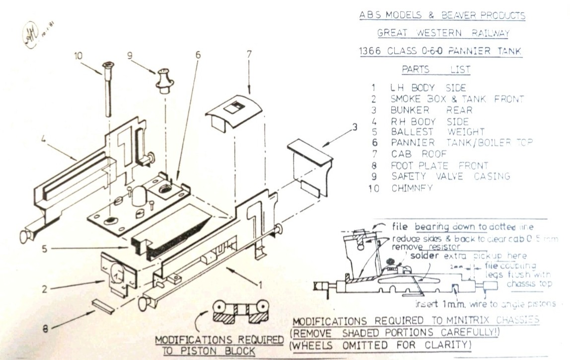

I bought another white metal kit many years ago and it came with the wrong (Foolscap!) instructions...
So, it seems the original Minitrix motor was 1mm too tall for the kit. You can compare your motor height with the Tramfabriek replacement before filing the chassis. Alternatively if you can live with a loco 1mm too tall, use a 1mm washer to hold the front end up to match the cab!
