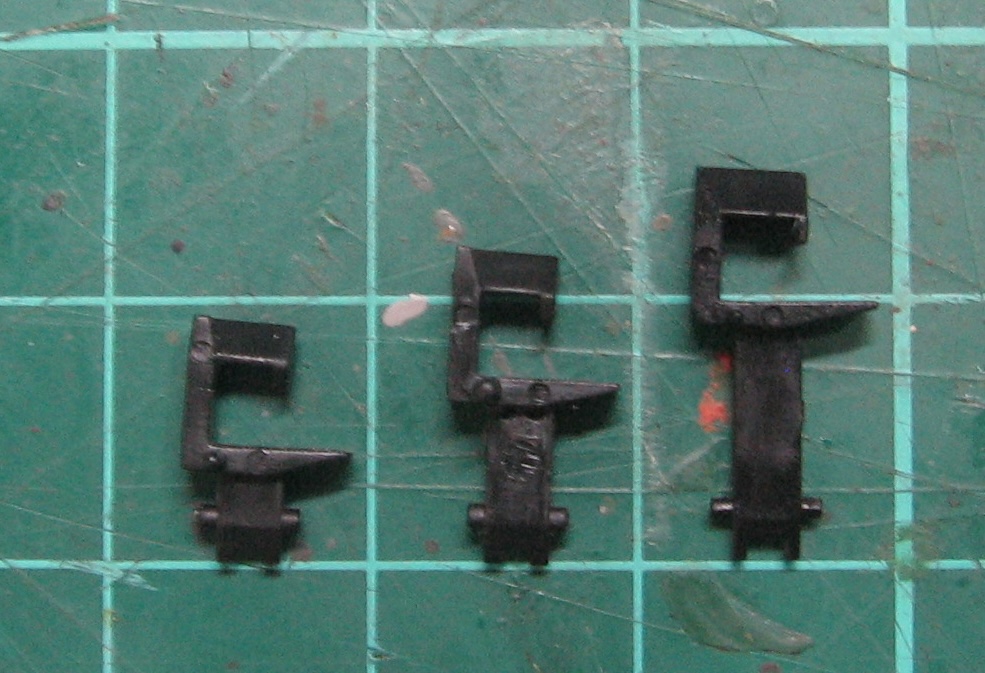

I usually keep 3 different lengths of NEM shank Rapido couplings in my spares box.  The middle ones in this photo are Farish "standard", I forget where the others come from though I think the long shanks are Dapol (for the 67?)   5.75mm difference between shortest and longest.

Quote from: ntpntpntp on May 18, 2026, 04:15:33 PM
I think the left hand one is Farish's short coupling - 379-402.
