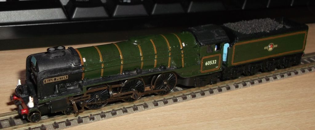

Quote from: Roy L S on January 08, 2026, 11:47:23 PMand my kit-built 60532 "Blue Peter" (a resin kit but I can't remember by who),
Roy:
I think the resin kit for your Class A2 Blue Peter model was probably manufactured by a company called Fifty-Six and a Half Inch Model Railways (long since out of business).
I bought the same resin kit (but from a different supplier) but never got it past the primer stage before GF came out with their A1 and A2 models.
Ian

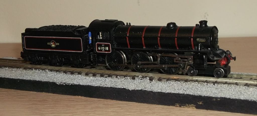

Hi Ian
Yes, that was it, I believe the locos were also made ready to run by a company called "Pro Models" (not sure what googling it would come up with and I do not intend to find out :D ). Mine languished in primer too for a long time but I did finish it, a loco I did a pretty decent job of if I say so myself.
The loco I am probably proudest of is B1 "Gnu", this Langley kit sits on the much better BachFarish A3 chassis, the airbrushing was done by my ex (a very capable modeller - better than me) I did the lining and lettering right down to the power classification and Route Availability which was pretty eyeball straining!
Both locos were made well before there was any prospect of either being done as a RTR model, at a time where if you wanted something that wasn't available you got on and had a go, or didn't have one! It is easy to forget just how spoiled we are for RTR models these days...
Regards
Roy

@Roy L S
Roy:
Your models of the A2 and B1 look absolutely superb!  I also have a Langley B1 but mounted on the then Langley recommended Black 5 chassis.  I think I built this around 1980 before I had the confidence to try lining, so my model has remained in unlined black.
Am I correct in thinking that you may have posted photos of your A2 on the old N Gauge Yahoo group or some other forum? It seems very familiar.
I am not sure if the Pro-Models RTR A2 was a resin model from Fifty-Six and a Half Inch Models.  The only reason I say this is because Les Richardson reported on the N Gauge Yahoo group many years ago that he had bought one from Pro-Models and the body was a metal casting but the tender body was resin.  He stated that the Pro-Models loco used a modified GF V2 chassis.
I would be interested in learning more about these relatively obscure companies and their N gauge kits.
Ian

Hi Ian
Thank you for your kind words. Amongst my collection I also have another B1 which I converted to tender drive using the Union Mills tender and mechanism (I may well have been the first!), Fred H did the paint job on that one, no other than preserved 61264.
As to the A2, my "Blue Peter" was definitely a "fifty six and a Half inch" kit and I think I may well have posted it's picture on the Yahoo Group before. I feel 90% sure "Pro Models" did the Peppercorn A2 RTR using this kit, but I recall they also did a RTR model of the very different Thompson A2 which used the Farish V2 chassis, this a loco I would love to have a model of, but I didn't have the £250 odd they cost back then and I doubt it will ever be done by a mainstream manufacturer these days (Hornby making it in OO).
Yes, I would like to know more too, and wish I had paid more attention at the time, of course there were also lovely RTR models made in the late 90s by Duncan Hazledene (can't remember the company name) of LMS prototypes too, and Fred Hempsall planned to do some resin models under the "Cempro" brand some of which I think my have appeared. My last recollection is that originally Union Mills also mentioned plans for locos like the V2 with outside valve gear in his early material, but clearly decided against them.
All in all, the early 1990s to about 2005 was in it's own right an interesting and much overlooked period for N models, and in terms of history, not very well documented...
Roy
