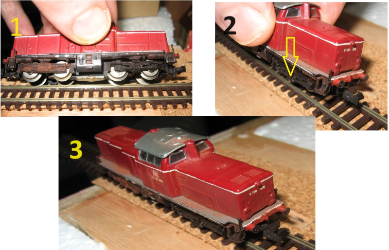

A re-railer is a very useful tool if you have one. It doesn't need to be one of the expensive powered ones, just the standard plastic version will do. Don't push the loco down the railer onto the track, instead place the loco on the re-railer and then pull the railer away while holding the loco still (like the old "tablecloth" trick :) ) That way you're not applying strain on drive wheels or traction tyres etc.
As we discussed by PM, I was taught as a very young lad by my Dad how to place a loco on the track by laying all the flanges of one side onto the rail first then tipping over. This is great for locos with many wheels and/or floppy bogies.  For a simple shunting 0-6-0 or similar loco it's usually easy to just plonk it on the track.
