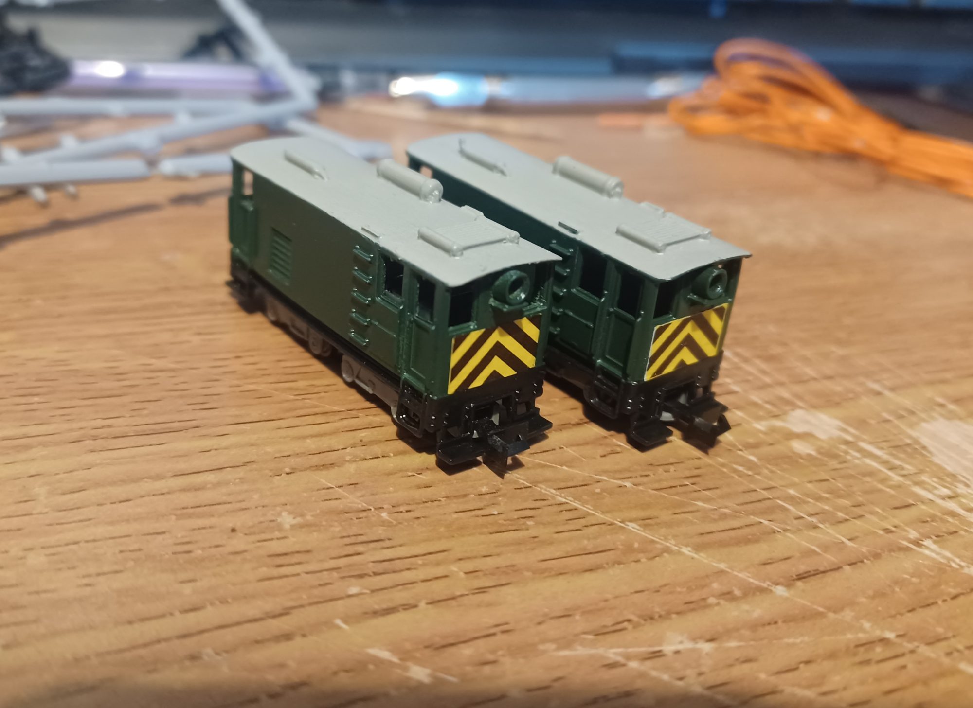

A good introduction to Nn3 is to start with an American nn3 boxcab by T R Knapp, they are designed to go onto the Rokuhan chassis that cost about £10 from Japan. You can order these 3d prints from this link: https://3dptrain.com/products/box-cab-diesel-n-scale
You may need a little plasticard to get the body on level.
Here are two that I am currently working on, one motorised and one unmotorised.
Also a link to one of the shops in Japan that sell the chassis: https://www.1999.co.jp/eng/10495646
