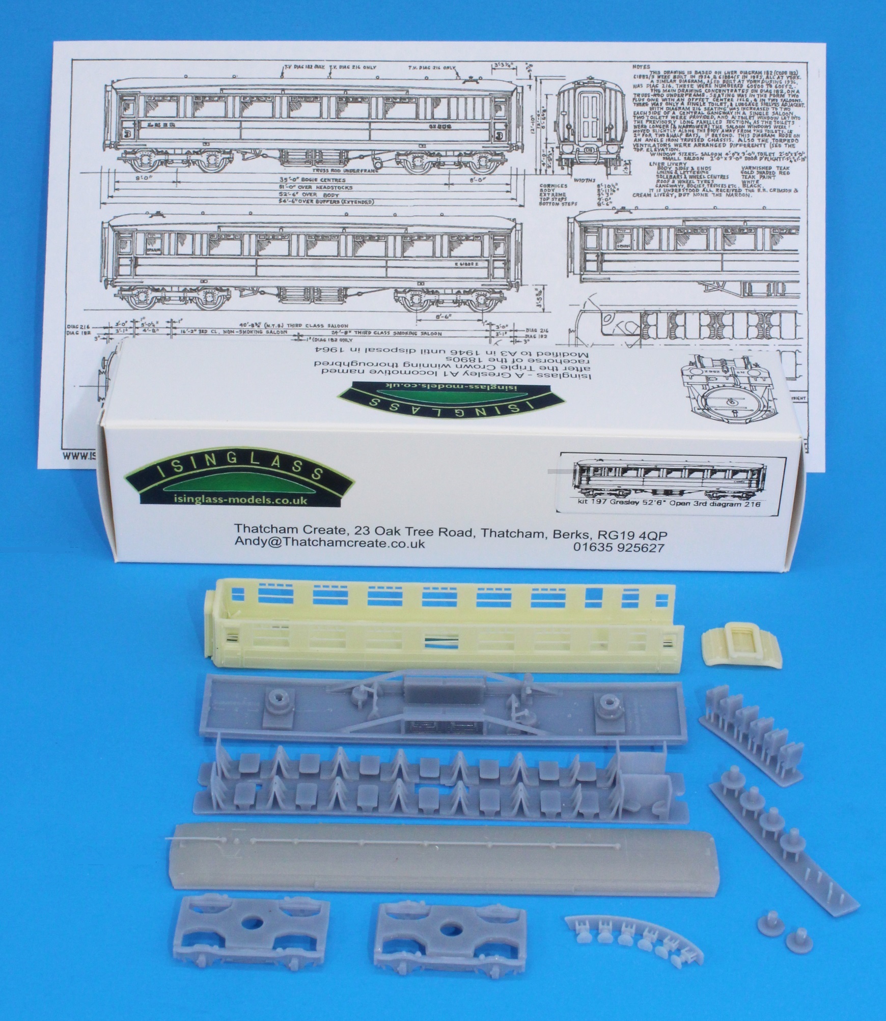

Full Disclosure:  I am not a coach kit builder.  The last (and only) coach kit that I ever built was a BR bogie luggage van from Highfield Models in the late 1960s.  This was a card kit with coloured lithograph sides.**
Reasons that I have not pursued coach building include the fiddliness of trying to get two coach sides, two coach ends, a floor/underframe, and a roof all nice and square and the fact that RTR coaches have generally been of very good quality.
However, as I am running short of new projects, I decided to buy an Isinglass 52'-6" Gresley third open (diagram 216) kit (see photo below).
I have to say I am very impressed for the following reasons:
1. The print is very clean with none of the annoying print lines characteristic of the old Shapeways prints.
2. The print consists of both coach sides, the floor, and one end as a single piece. Only one coach end needs to be secured in position.
3. The roof and underframe are clip-fits into the top of the coach and the underside of the floor respectively.
4. The underframes have been designed to work with either Isinglass or NGS bogies.
5. The bogies, underframe, coach interior, and a scale drawing can all be purchased separately so you do not pay for items you do not need.  (I purchased everything with my kit to see the overall quality of the kit).
6. A Dapol underframe can be used on certain kits.
7. Certain coach types available in 4mm scale not listed on the Isinglass N gauge products page can be ordered in N gauge.
8. The instructions and the hints and tips for resin kits included with the kit are good.
More details are available on the Isinglass website:  https://www.isinglass-models.co.uk/
Obviously, a lot of thought has gone into the design of these kits and I can thoroughly recommend them, especially to novice coach builders like me.
Ian
** I did mount the sides of the NGS Gresley D113 full brake kit on a Dapol Gresley coach (after removing the coach sides but leaving the Dapol coach ends in place).  The sides fitted perfectly.

Ian,
thanks for the review. It is encouraging as I too have generally avoided coach kits having attempted very few and rather tended to stick to wagons (I am also not a great one for loco kits and I very much admire those who can do those well).
Since I have been looking at the Isinglass site for a while your post may well push me over the edge to purchasing.
Of course it will still leave me with my perennial concern of painting teak (its like tartan paint, very difficult to apply with a single brush stroke  :smiley-laughing: ) ,
Colin.

Thanks for the further update, Ian, and best wishes for the build.
I don't need any more coaches, but could be tempted by a 52'6" corridor one-these were built for the GE section which I model, and were long lasting.
The early builds were dual braked, and as time passed, the 'short' coaches became more widespread.
As you say, lots of general information on the website, and it seems they would listen to scaling down any of the 4mm designs.
Martyn

Yes, I sympathize.  It seems that LNER modellers all have a different way of applying teak colour.  It's like their "secret sauce."
I have a similar problem with my Isinglass coach kit for the BR era   According to the drawing notes that were included with the kit:
"It is understood that all received BR crimson and cream livery but none the maroon."
Living outside of the UK gives the perennial problem of trying to match BR Colours.  Shipping from the UK is not possible due to regulations.
Unless anyone has any ideas, this will require more research and probably more trial-and-error purchases.
Any suggestions for BR crimson and cream colours from paint brands that are available in the United States?
Ian
