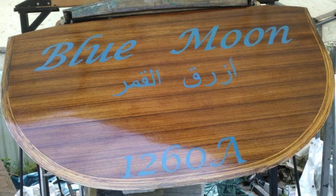

I've used and still do use many layers of yacht varnish.
And so have plenty spare to use in the burns on Tiree.

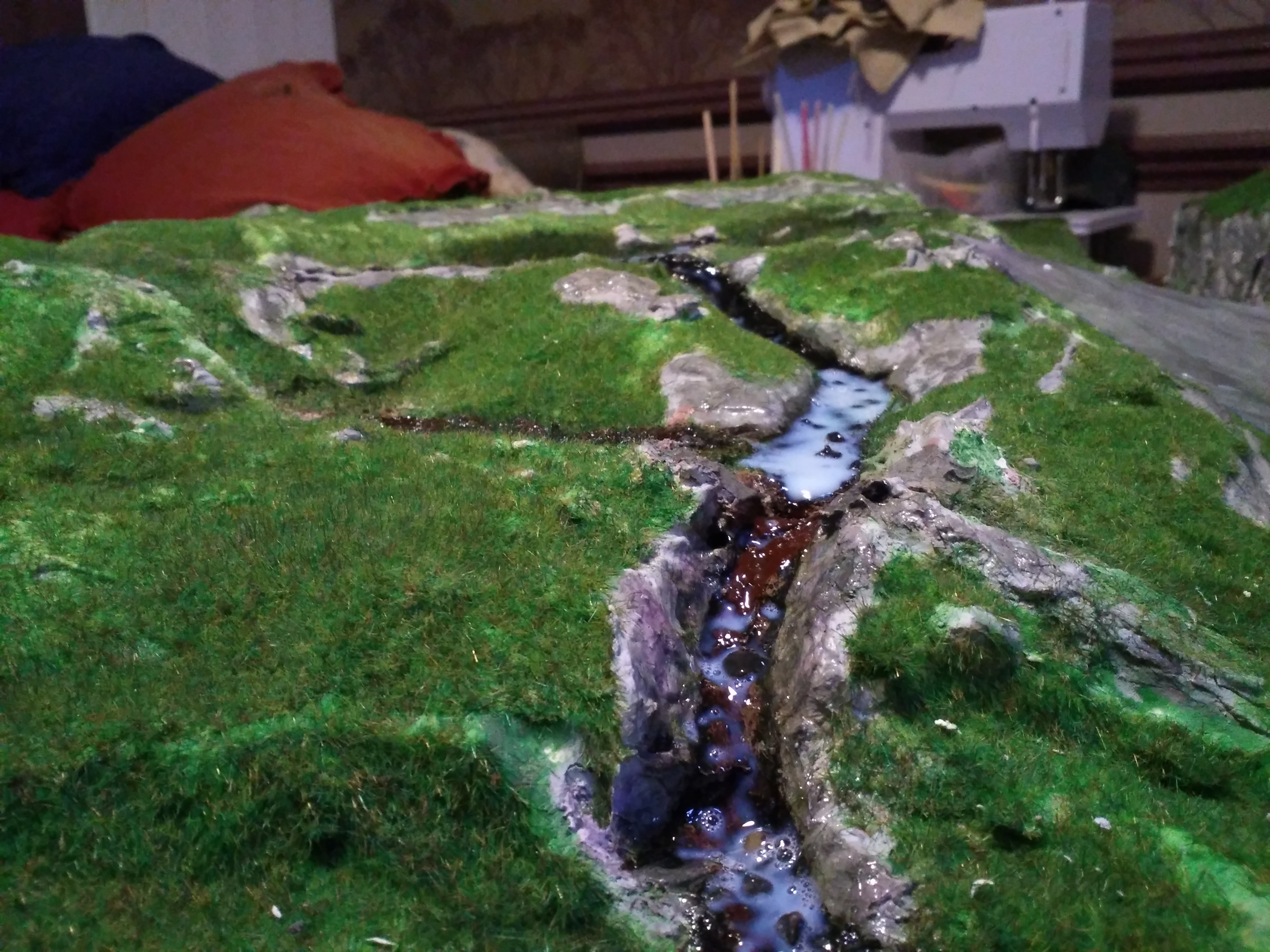

For deeper water I've recently tried resin used for fibreglass with some success, I was looking for the deep see through peaty brown loch water of the Highlands and Islands.
You do have to use the particular dyes for the resin though..

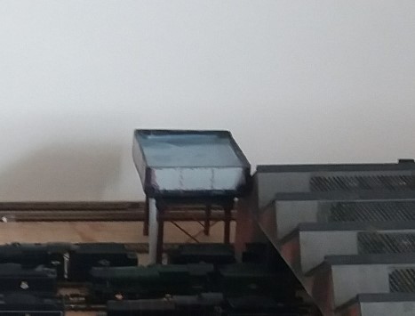

i just use cheap white pva glue from poundland--it costs a £!--and dries clear.  I built up several layers just pouring it on where i wanted it--and let each layer set clear first.  You can create quite a clear depth to the water--as well as adding weeds junk and crap as you go.
water tower---

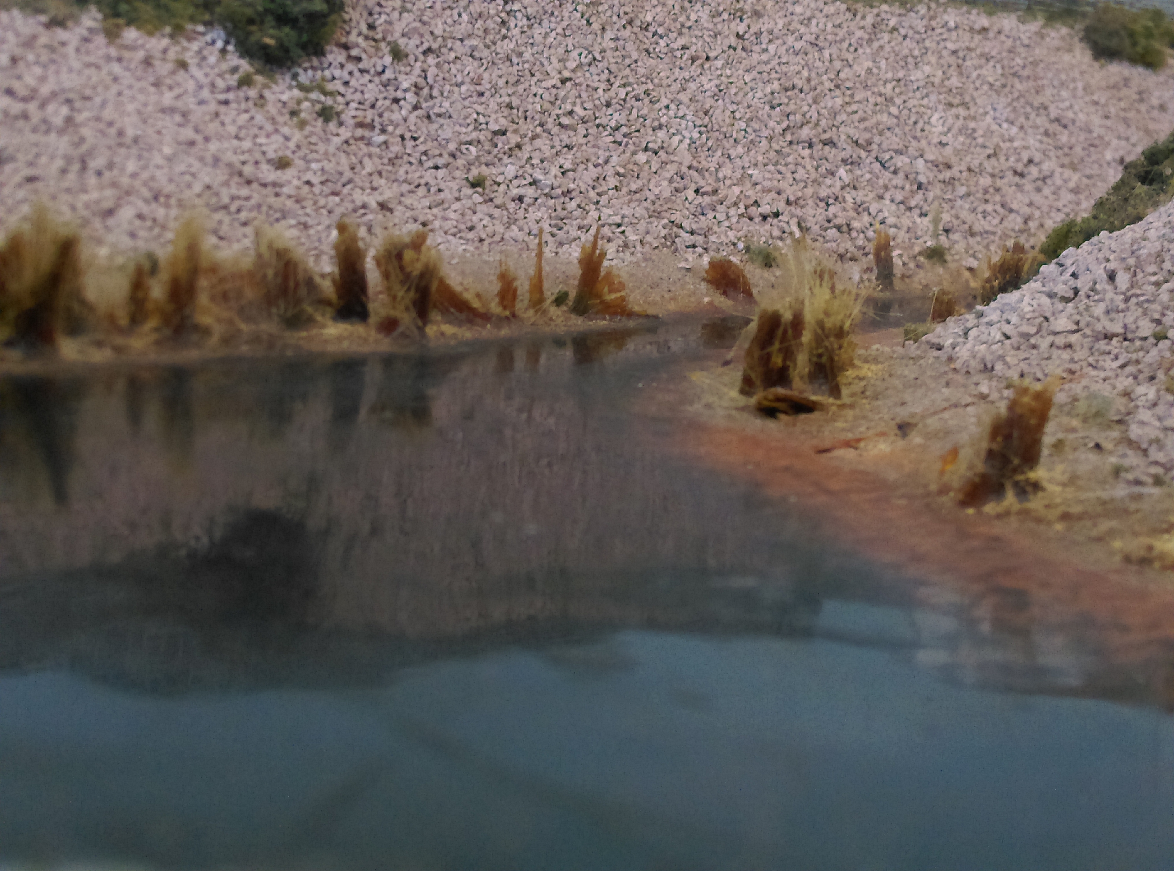

I have used varnish on my own layout, as it pre-dates the excellent Woodland Scenics products.
One trick I did learn from America though, is to not paint the water blue. It is not blue. In fact if you look at photos, water often appears black, especially if it's deep.
I therefore use black, which, with a gloss finish, acts as a low grade mirror that reflects it's surroundings, as real water does.
This is a flooded quarry on my layout:
