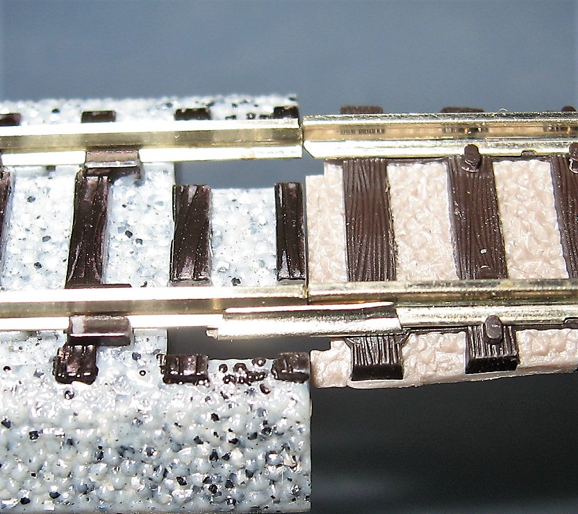

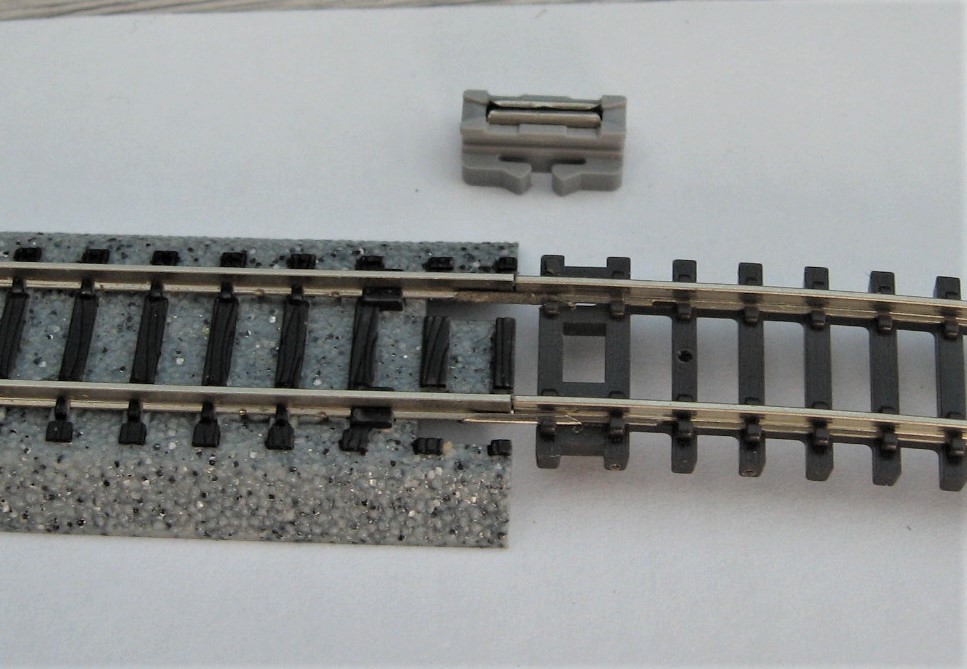

As the other posts have said,  you can join other N gauge track systems to Kato Unitrack without the need for conversion / adapter pieces.  If the rail is code 80 (80 thou high) then it should be a good match, you'll just have to work out which rail joiner works best as some rails have a wider "foot" than others.
Here's Peco Setrack joining to Unitrack using Peco joiners (Unijoiner removed)
Here's Fleischmann Profi-Track joining to Unitrack using Fleischmann joiners which are a little loose on the Unitrack rail due to Fleischmann's wider foot.
You do have to keep in mind that the track geometry of the different systems probably won't match: different curved radii, different angles of points, different lengths of straight track etc.
