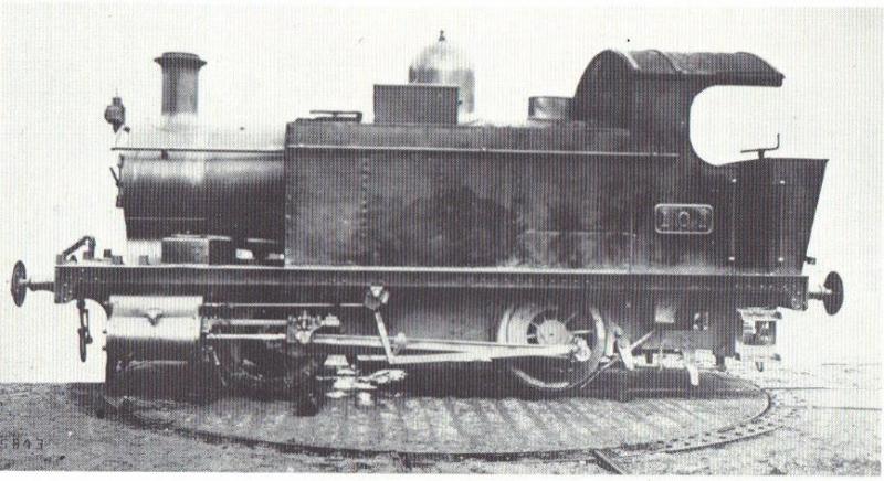

It had wheel diameter of 3' 8" and a 9' wheelbase. I don't think the Japanese one would look right somehow...

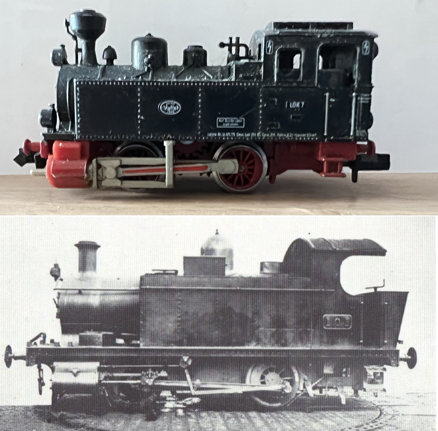

If you look at them in side profile, the Fleischmann 0-4-0 isn't too far off (other than the shorter wheelbase). The slide bar on it isn't quite the same as the motion on the 101 but it does have the same feature of hiding the front wheels pretty well.
With the 101 being longer you could probably even get the doors and open roof in.

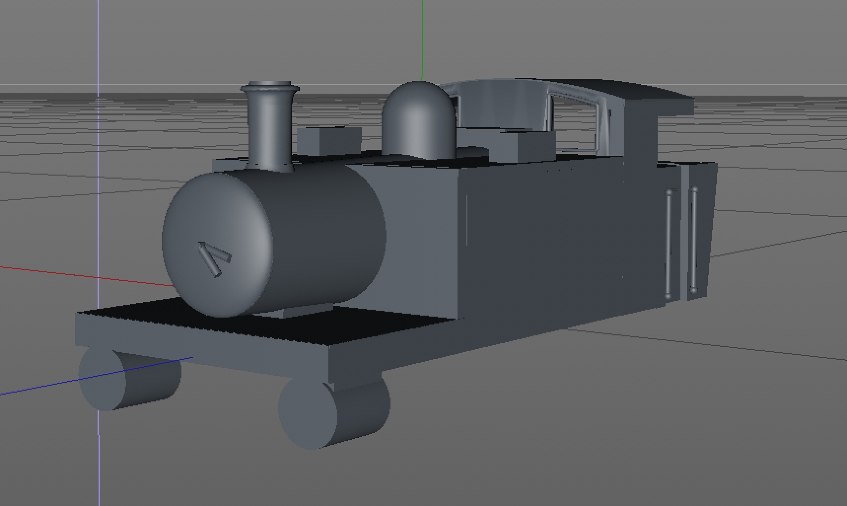

I had a bit of time to kill waiting for my GWR loco to print, so I kind of kit-bashed bits from its 3D model into a version of the 101 that would fit on the Fleischmann 0-4-0 chassis I have.
Visibly it is a little wide compared to the sleeker lines of the Hornby model, but you would be able to get the open cab of the protoype.
If you deliberately increased the height (I based the height of mine on the photo of the prototype), you'd get a thinner look without it being a particularly big loco.

Very nice!   I was contemplating doing something myself, but if you've got access to the chassis already I look forward to seeing where you go with it! :)
Ross.
