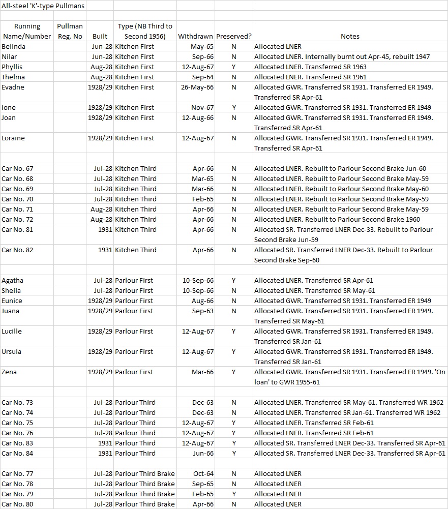

talisman56
#54
A list of all the All-Steel 'K'-type Pullmans and basic info, including where they were allocated.
Note: Cars No. 73 and 74 were named 'Ceteia' and 'Melandra' repectively between Sep-62 and Oct-63.
'Belinda' received LNER-pattern bogies at an unknown date.
'Thelma' and Cars No. 73 and 79 received replacement vestibule doors with smaller windows c1952.
Quando omni flunkus moritati
