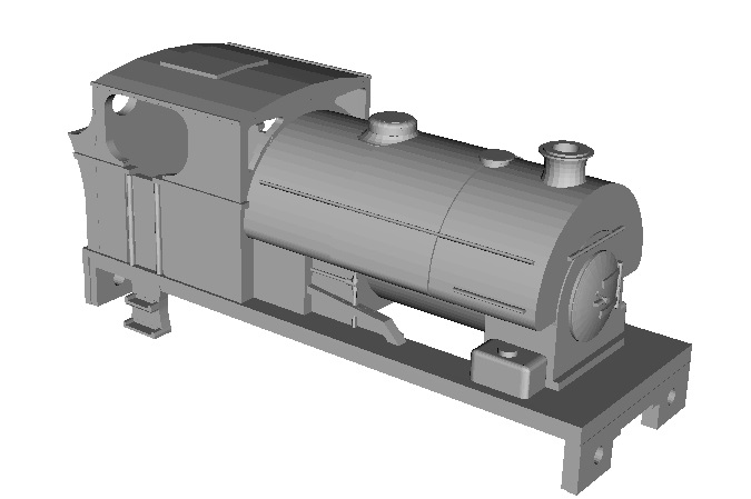

Here's the first draft body superimposed on a blank of a Minitrix 0-6-0 chassis I use to ensure fit.
The brown areas are where the blank and body intersect and will need some attention.
The Monster's wheelbase is approx 11'6" - the chassis' is 20mm. Wheels are 4' 0.5" - Minitrix 6.5mm.
The real thing tends to rock and roll on dodgy track - so will this!

OK, well that's the body shell design more-or-less done:
Unlike my previous Pecketts I've added some details like safety valves and a reversing rod, but I don't expect these to survive through cleaning and finishing. We'll see.
I've decided to add cylinders under the footplate which will replace the Minitrix cylinder block. If my measurements are right, the longer footplate means the new cylinders can be angled upwards without the piston rods fouling the buffer beam. Again, we'll see...
