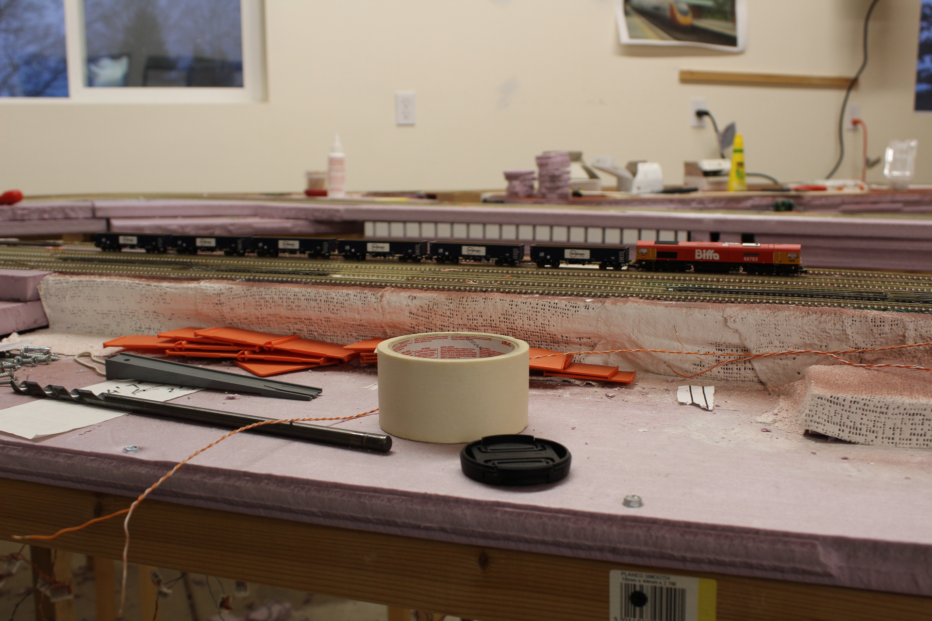

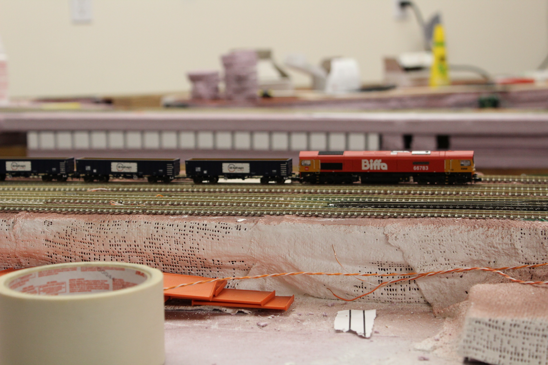

So first here it is posed straight out of the box with some wagons.
The livery looks good to me and everything is printed pretty well.

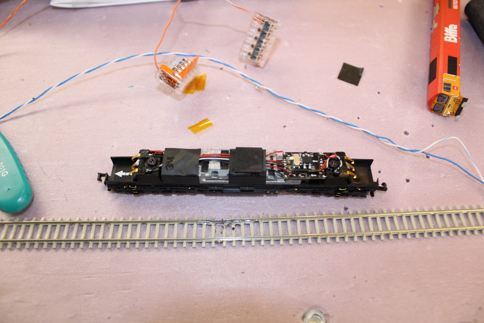

As I use DCC the next task was to pop the body off to add a chip. The body came off easily and revealed this.

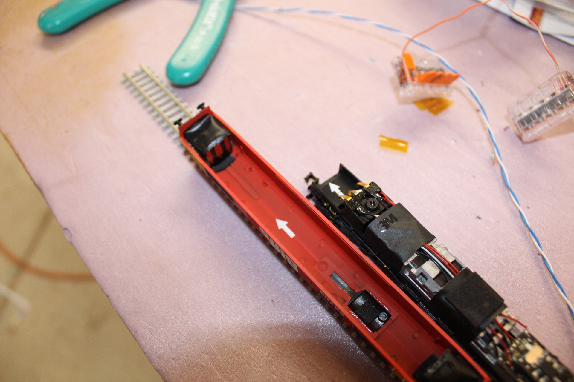

A brand new PCB design and as an added bonus they have got rid of those awful 3 wire connectors and replaced then with 3 copper contact strips to transfer the lighting signals to the body shell. This means that it should be much harder to b**ger the lighting when removing the body shell. I have 3 class 86's waiting lighting repairs for this very reason.
In addition the body halves have helpful arrows so you don't get back and front mixed up.

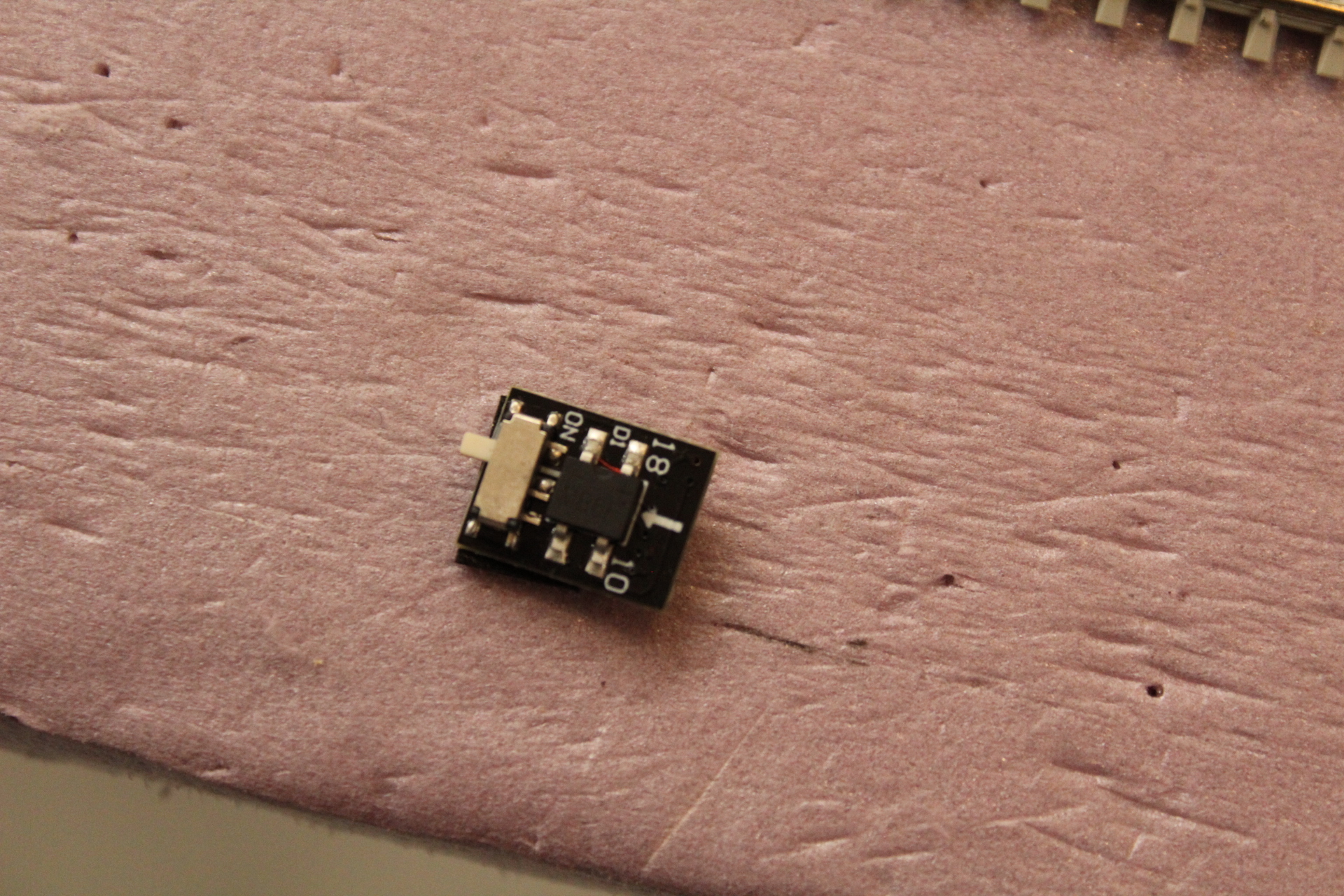

And the DCC blanking panel includes the lighting switch for those operating with DC.
Once the loco has been chipped (Zimo MX618N18 for me) F0 turns on the directional front lights, F1 turns on the rear headlights, and F2 turns on the rear tail lights. As I use a Z21 then that's all I need to do for DCC for now. If you use a DCC controller where F2 is a non-latching button used for the train horn, then some function mapping/CV programming will be necessary to get the rear tail lights to turn on and stay on.

Anyhow here's another shot with some wagons received from my kids for Christmas
I follow up on its hauling capability in another post.

they are a lovely loco, and the new pcb makes a big difference to me. only down side I could point to was the advertising mentioned all wheel drive where only the outer wheels of each bogy drive. Still has reasonable pulling power.

Thanks for the pics of the internals on these. Glad to see the awful lighting wires replaced with contacts.

Agree, thatís a major improvement! Shame thereís not speaker space.
