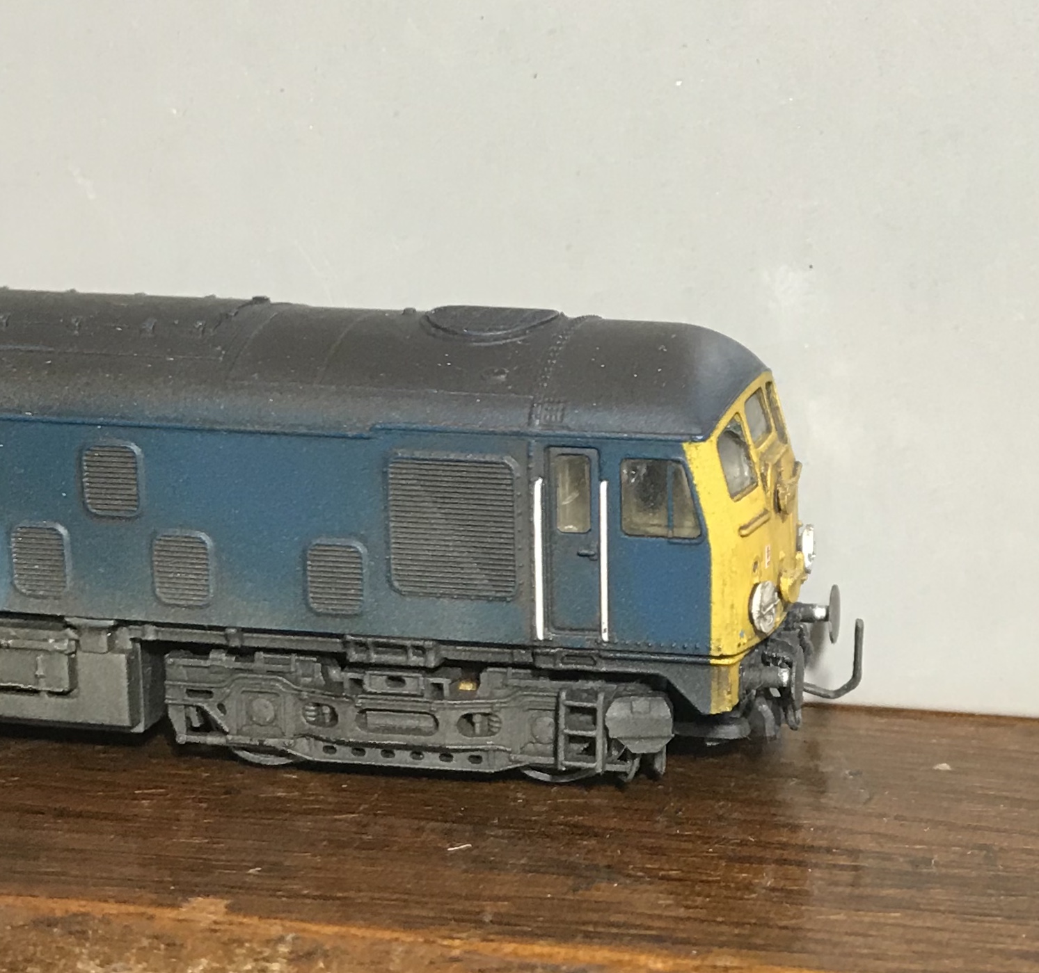

Having returned from holiday, I have been completing my work on this to-night.
Here is the appearance of the detailed end with working coupling:
Farish class 47 with detailing and coupling by James Petts, on Flickr
This is what it looks like coupled to a carriage:
Farish class 47 by James Petts, on Flickr
And this is a comparison of it next to a class 50:
Farish class 47 and Dapol class 50 front ends compared by James Petts, on Flickr
As we see, the pipes are swept aside somewhat to allow the coupler to travel around the corners. Whilst this does not look as good as the pipes hanging straight, it looks better than having no pipes at all.
This definitely seems to be the way forward for these locomotives. Next, I will have to investigate the equivalent detailing packs for the carriages. I am interested whether anyone has any experience with these.
