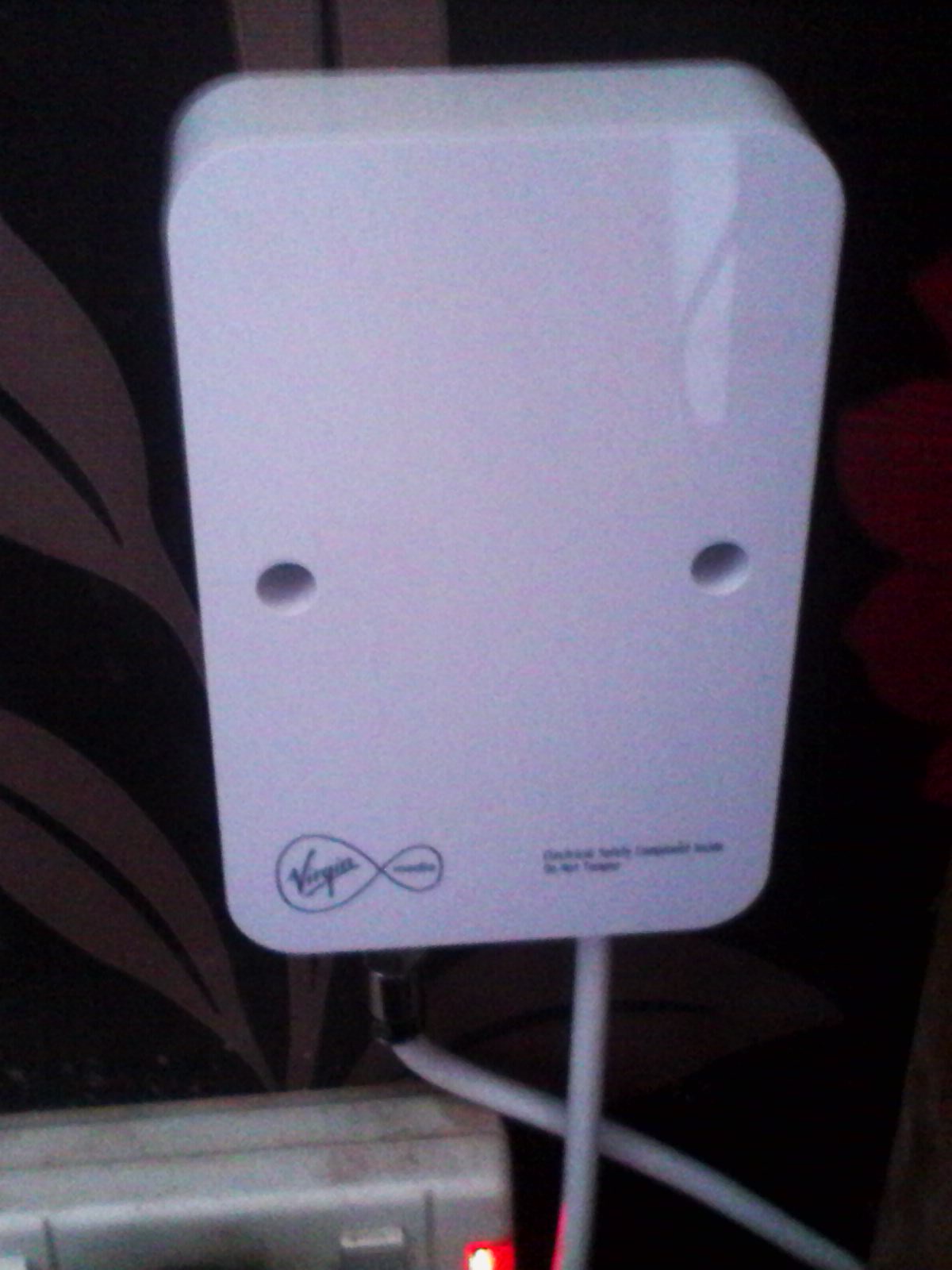

if of any help, this is what the kit looks like.
cable in through wall into back of this

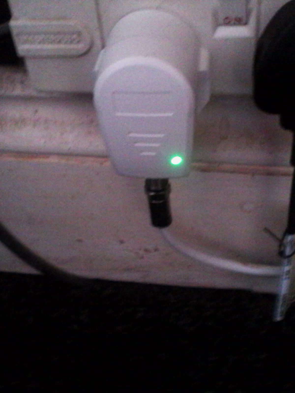

this has a weird 3 pin plug feeding into it which must be left switched on at all times, apparently

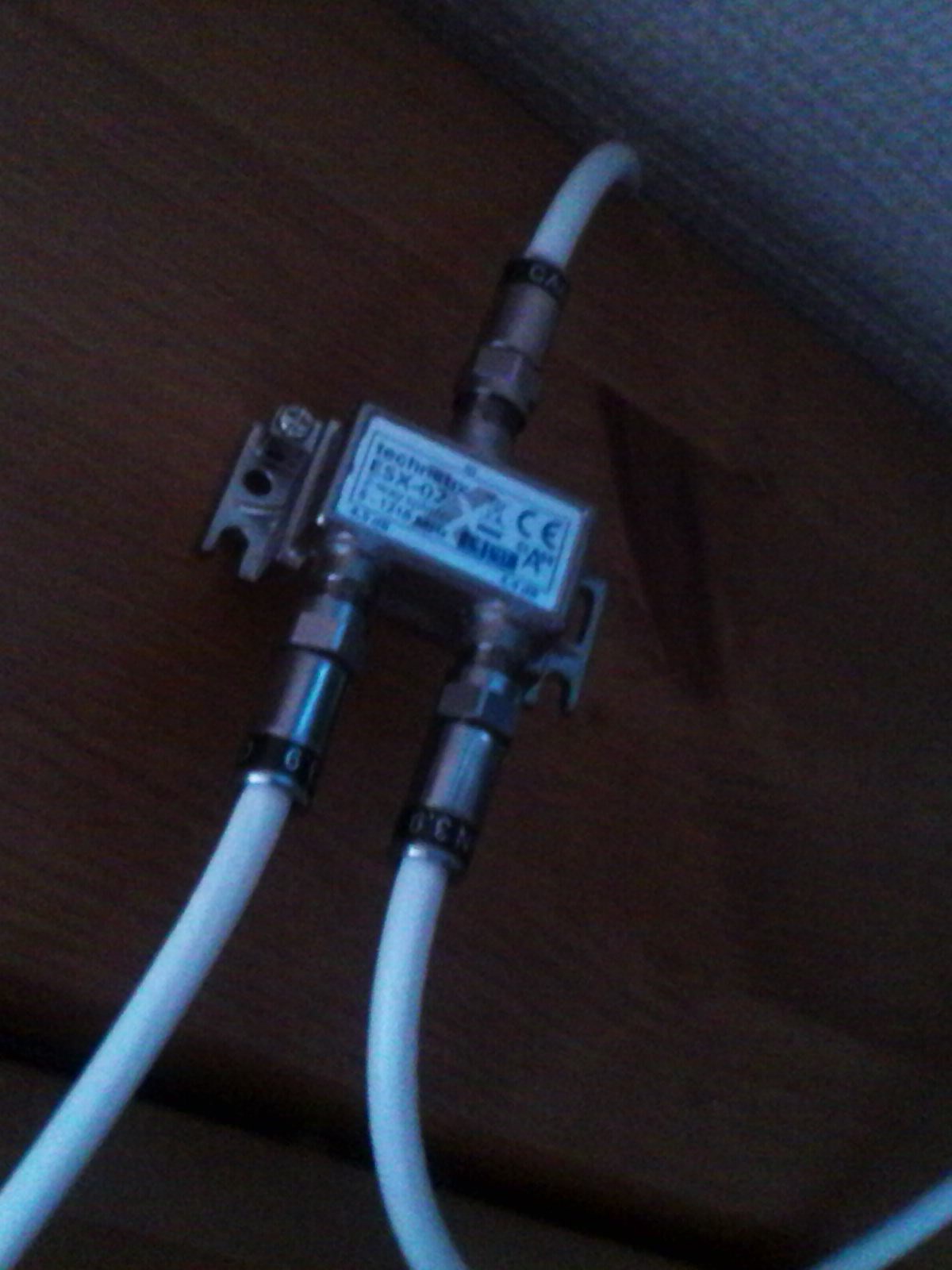

second cable from the white box leads to this, one wire then going to the black box, the other through to the sitting room and the TV box

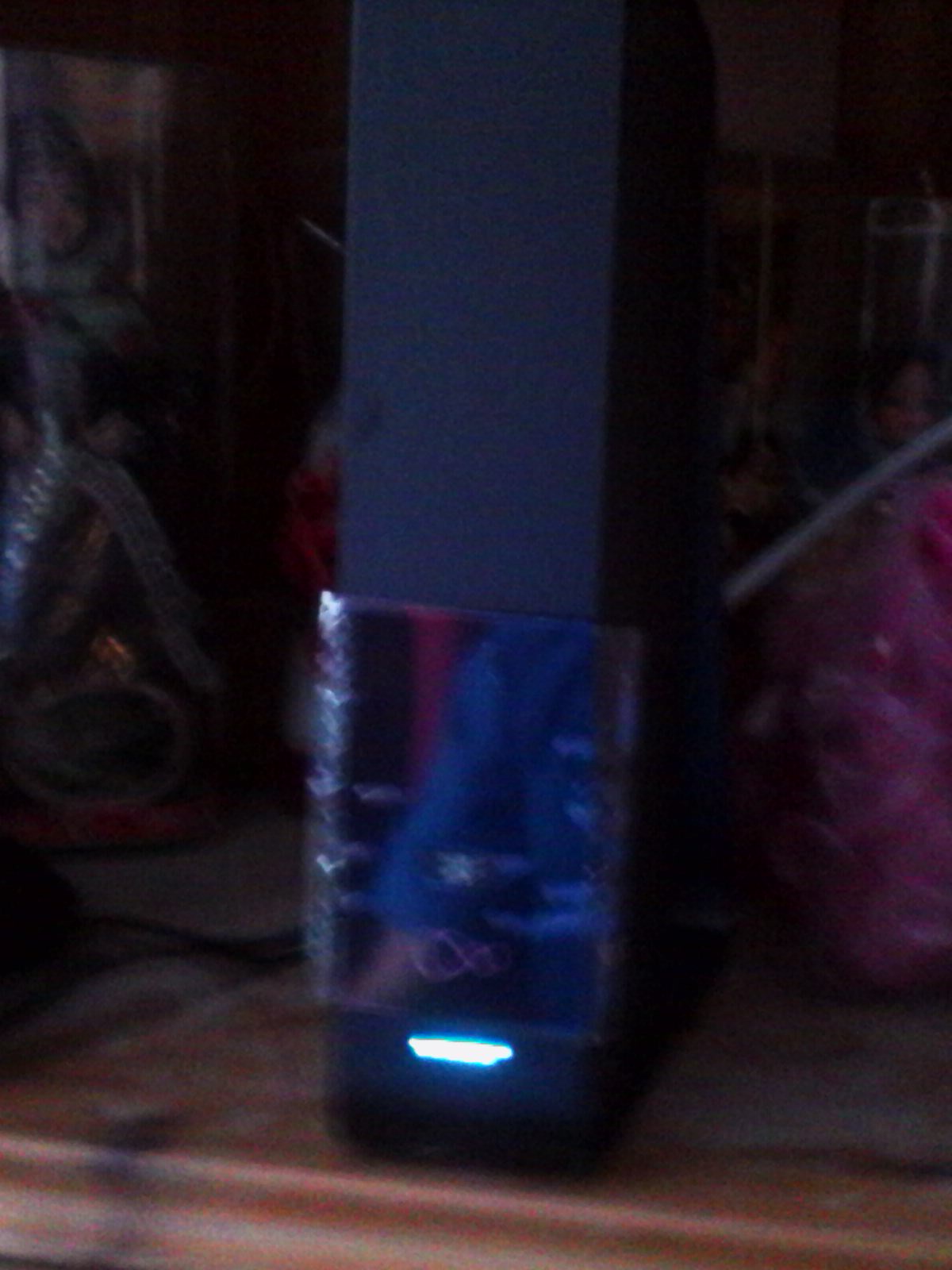

and this is the black box, or at least front of it
not sure if it a modem, hub or what.

The white box is the BT convertor
The splitter then splits the cable, and are known for being installed incorrectly
One cable will go to the Tivo the other to the Hub3
The black box is the Hub3
There is a lot to go wrong there
I have had to rewire a splitter before, the engineer was called out for that, confirmed it was over 5 years old and had to be replaced
What you can do is connect the Hub3 to the connection output from the white box, and then compare
totally confused as to why I have a BT convertor ?
is [supposedly] connected directly to the Virgin fibre cable, which runs to their cabinet down the road, then via their own network.
BT network shouldn't be involved, should it ?
I'll try connecting the hub directly to the white box in the morning.
