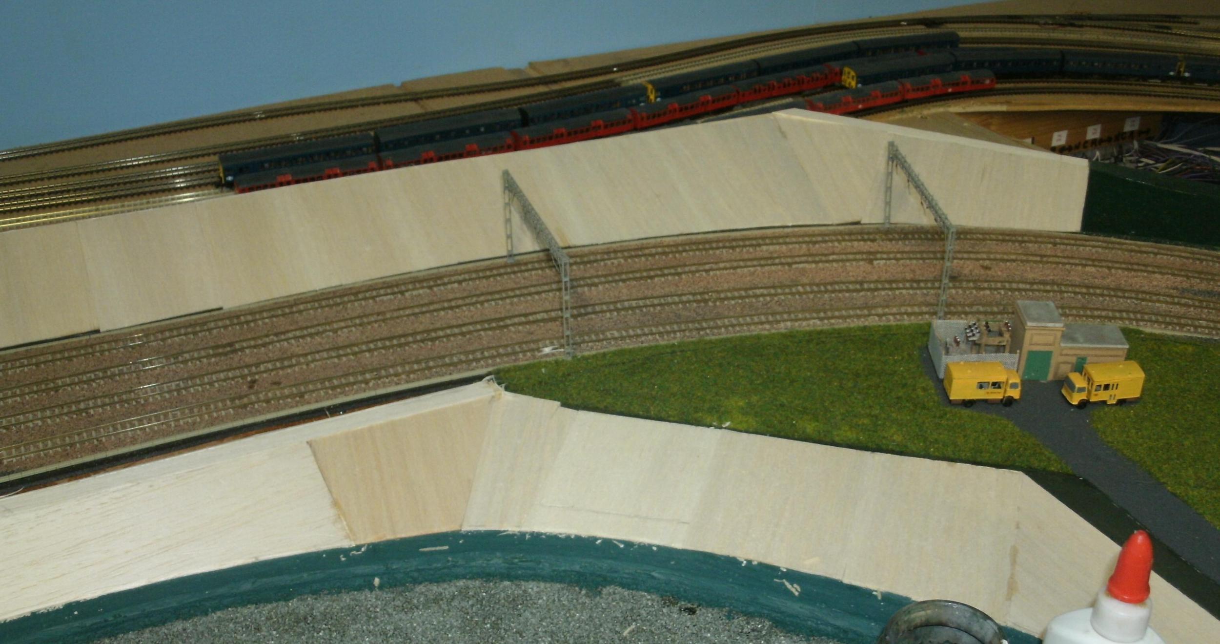

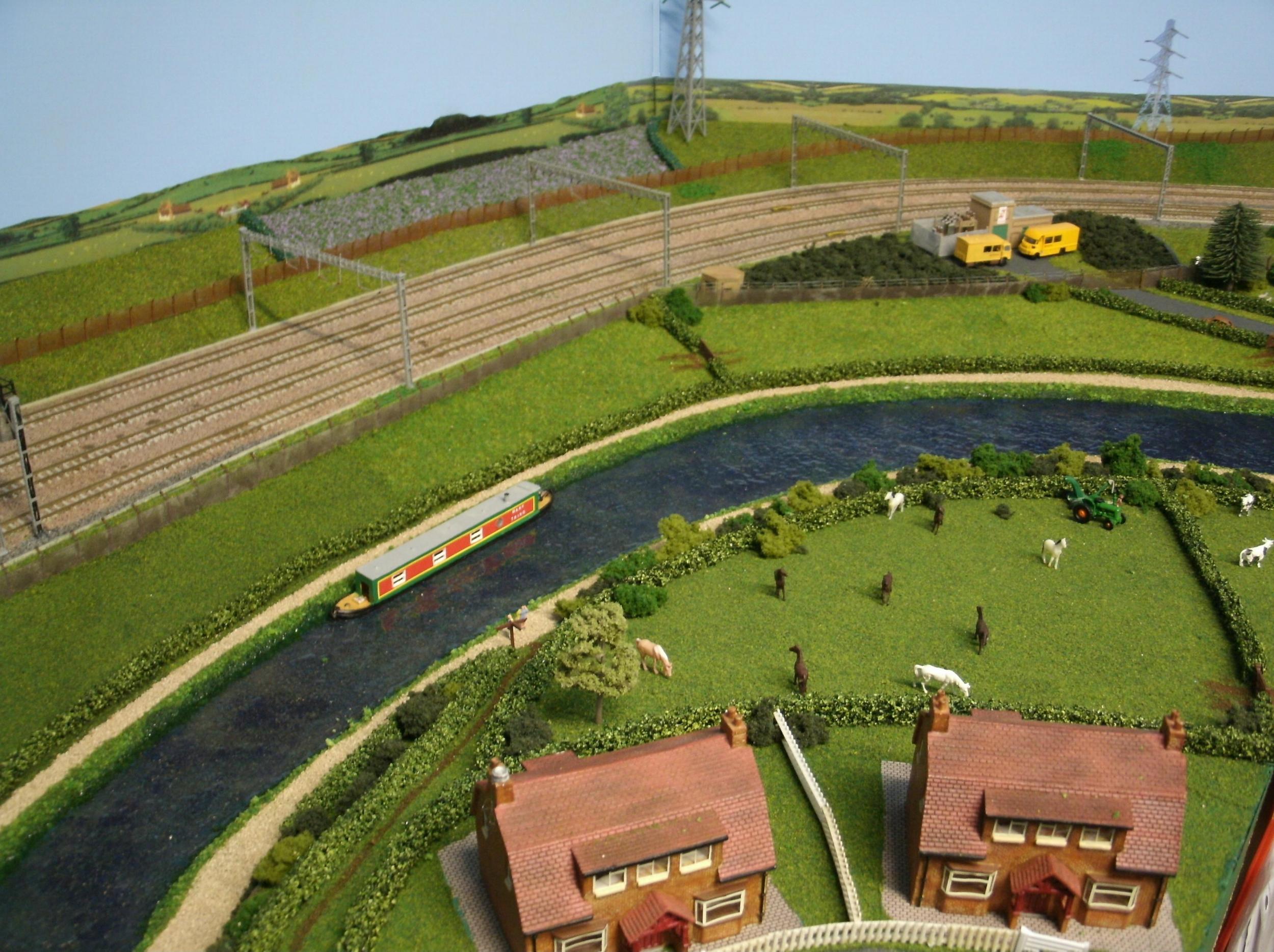

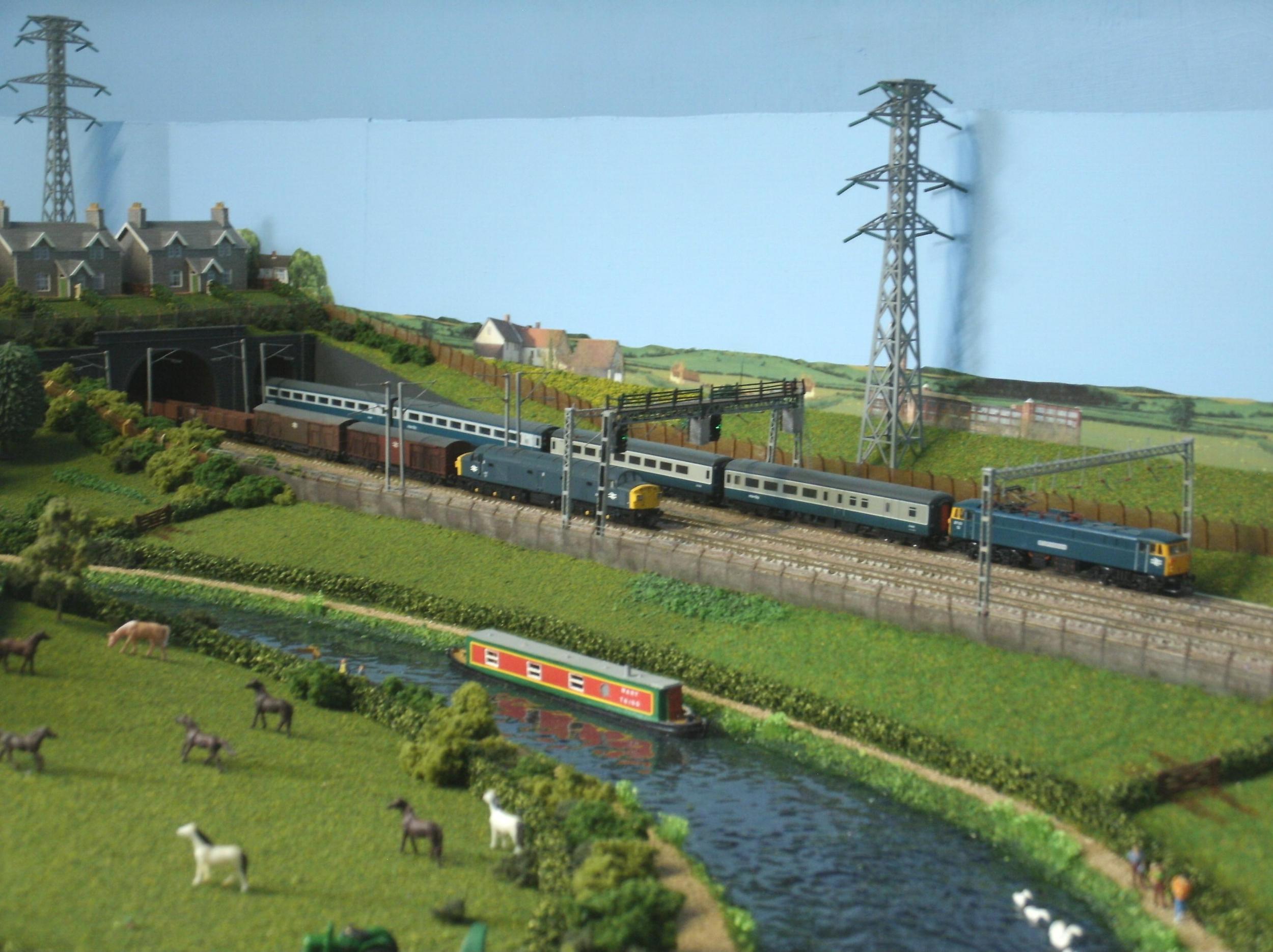

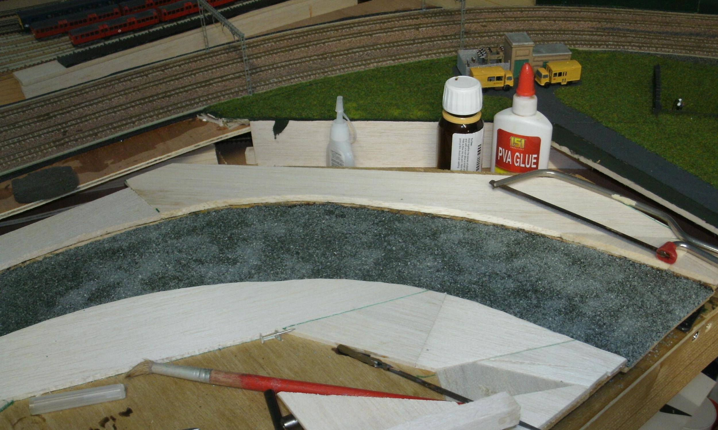

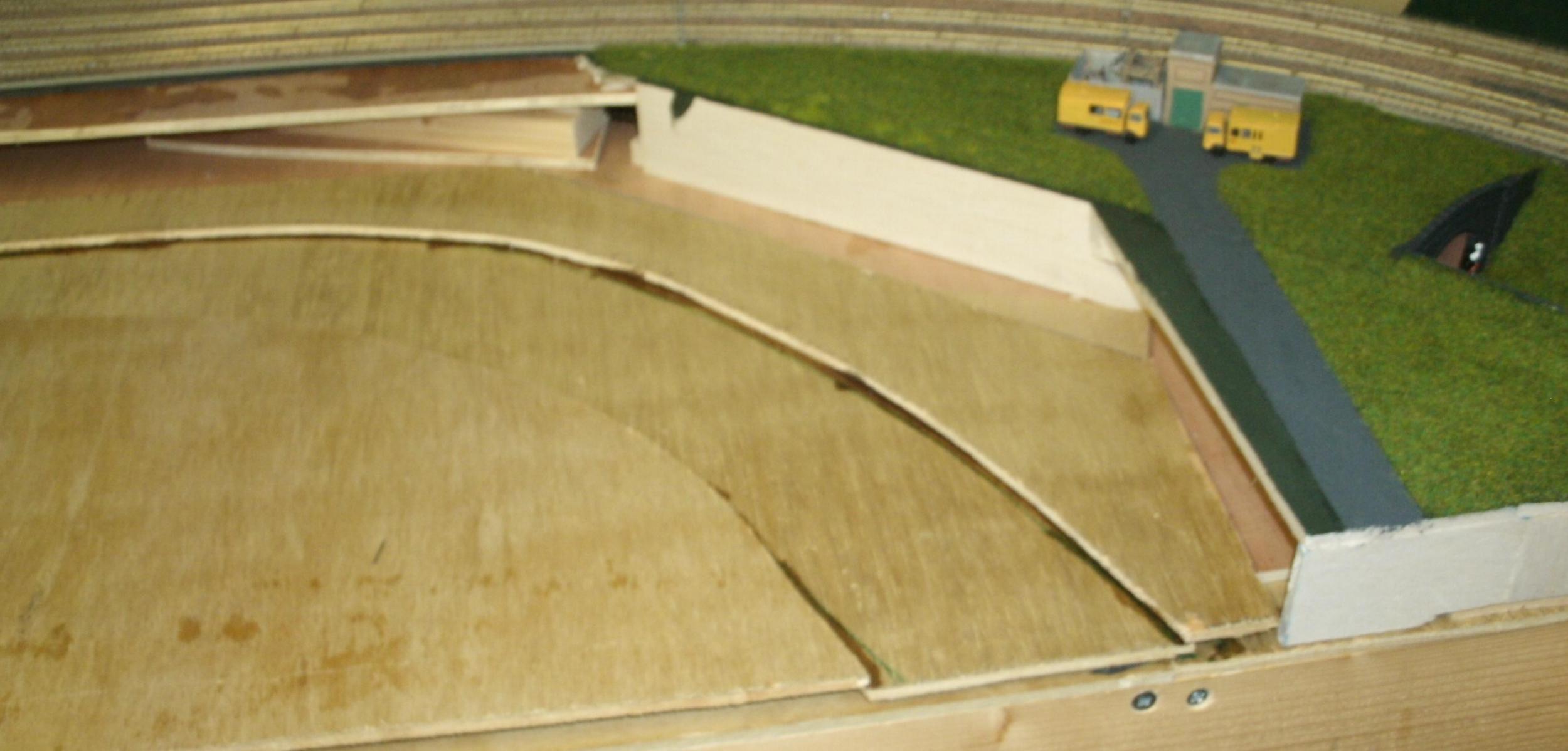

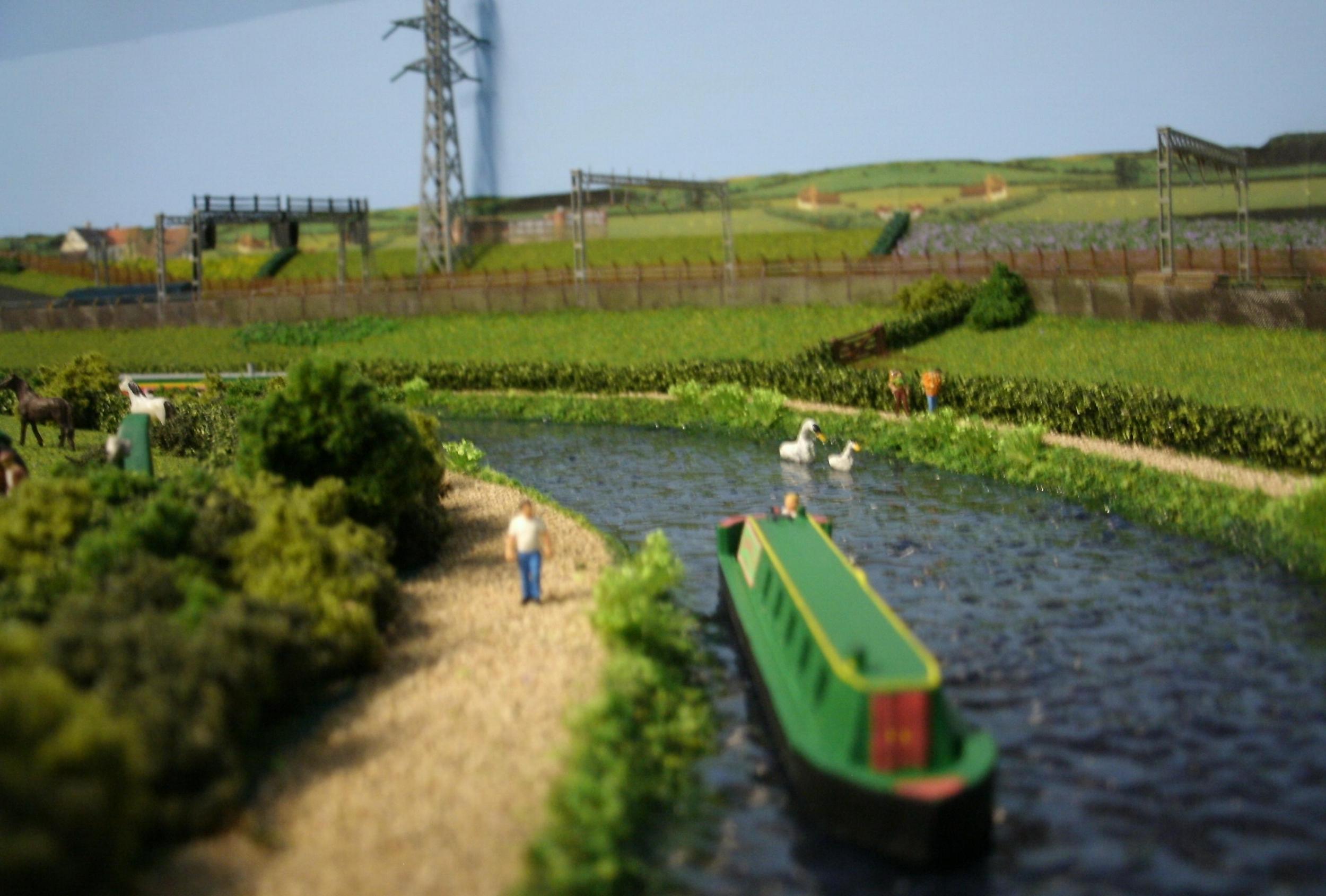

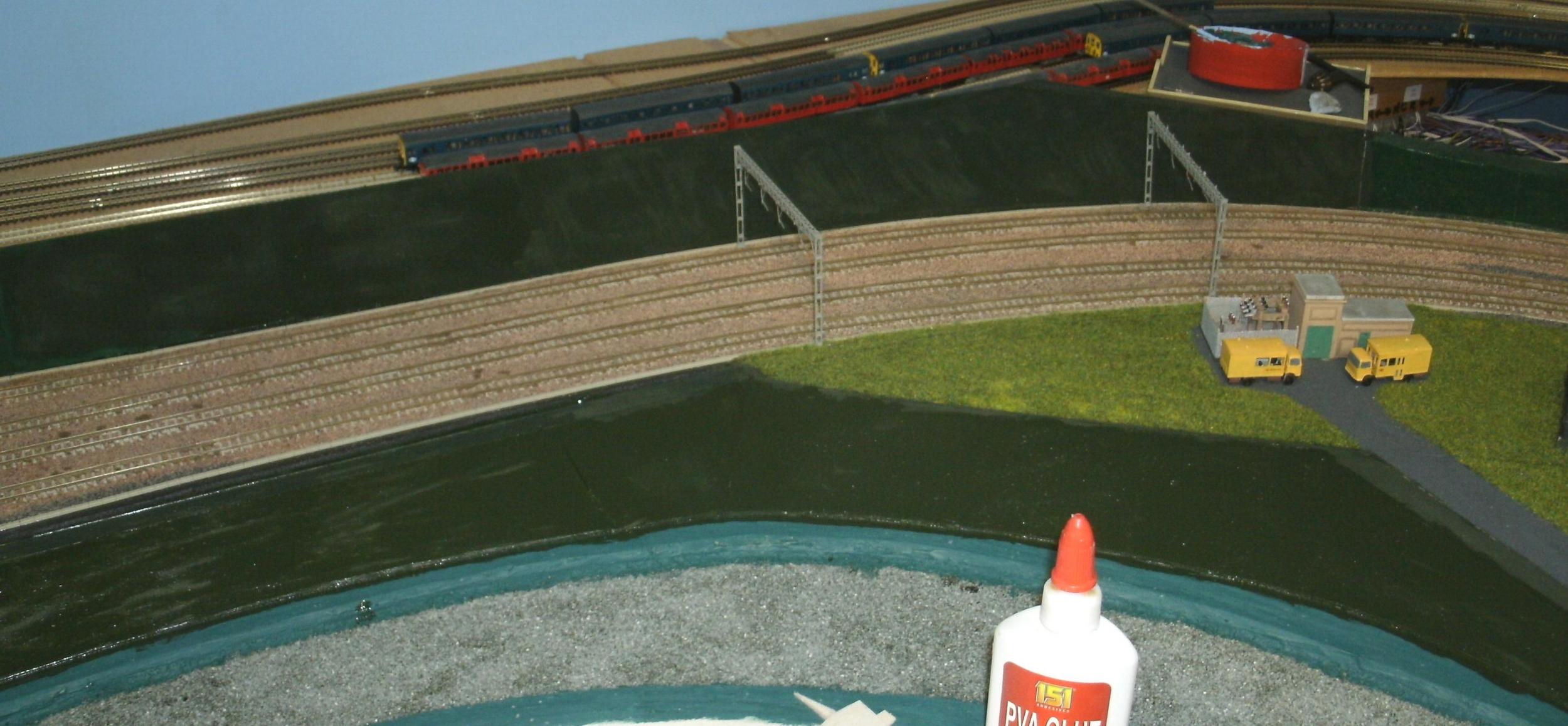

Here's how I made my canal.
5mm plywood, cut out and then inset.
5mm balsa planking used to raise the canal bank. Rough stone chippings stuck to the canal bed.
More Balsa planking added to form slope down to the canal tow path. Thick paint used to seal the balsa/plywood joins in the canal bank.
Painting the embankments dark green before adding the grass.
Stones in canal bed were painted varying shades of light and dark blue to simulate sky/cloud reflections. Woodlands 'Realistic Water' added. The first layer dried slightly flat.
After applying the second 'fill' of water the stone base created the slightly rippled effect on the surface. (This was purely accidental, and I hadn't planned the water to be other than flat calm).
Finished scene. I know some people prefer to make their canal water 'green'. I decided to go for blue instead.
Andy A.
Full story and pics at:-

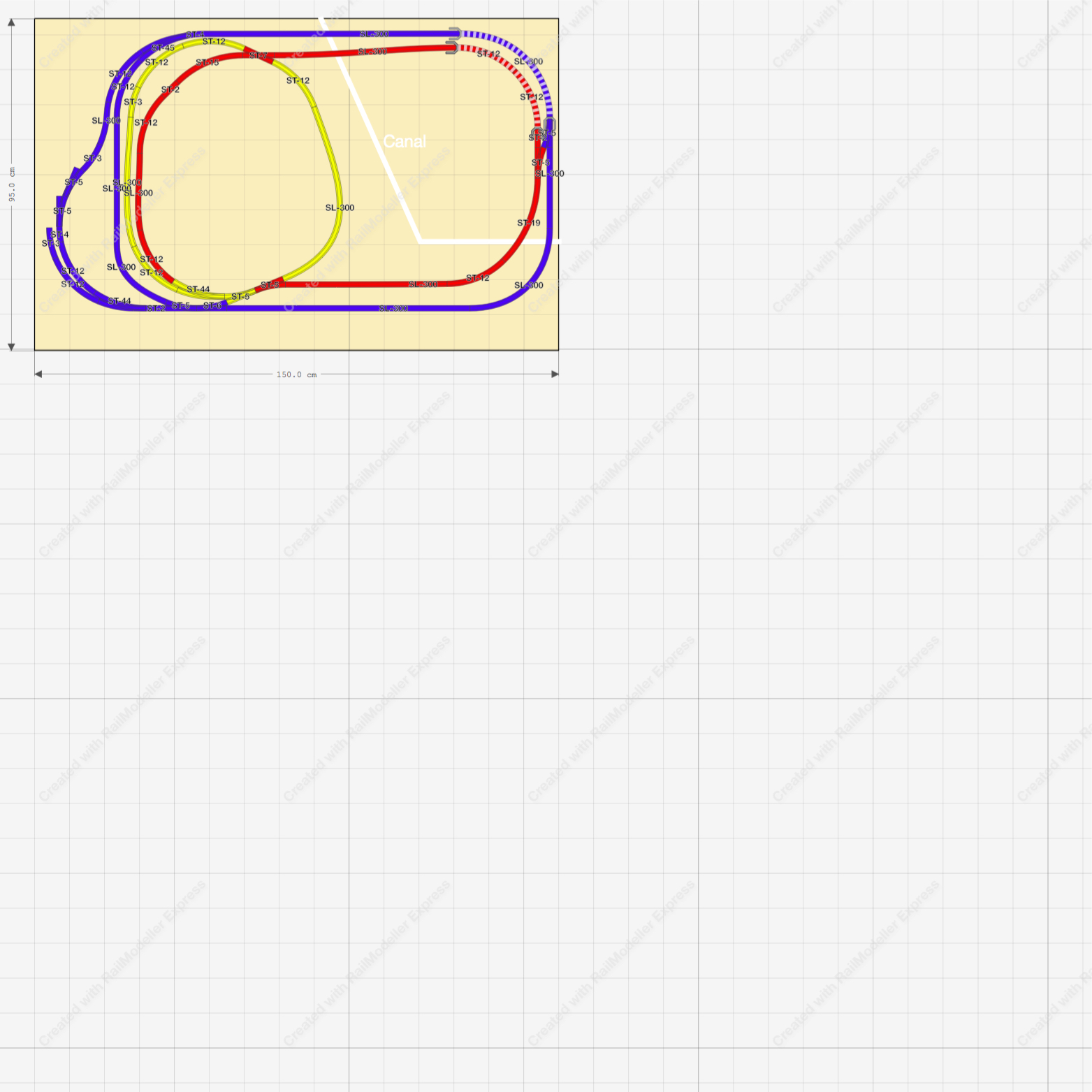

I have been on all day today creating a layout plan I will post on here if I figure out how to hahaha
stuy1982
#6
This was an idea I had not sure if correct or will work so ideas welcome think I am going to stay on one level and add tunnels keep canal stroke River and allow trains to pass over on bridges might simplify the whole thing for now the sidings will be to left but app I used only let me use 50 elements as free

As plans go it looks unusual but would appear fun to operate and have great scenic potential.
Caz
Welcome to the forum and as Mick says, a very unusual plan.
I'm guessing that top left is going to be some sort of terminus as you have 3 points shown without any track connections.  If so, one you leave the terminus there is no way of getting back except reversing or have I completely misinterpreted your plan.
Caz

stuy1982
#13
Hi caz the idea in the planned track was to have the engine sheds to the left but the planning software was only free and wont let me add more track elements to complete lol my idea was use the blue track as main outer line and this track allows entry to the inner lines via points and to go homeand finish the day the yellow line could move onto red line then onto blue then come round over top and back into the termus/engine shed lines
Hope this makes sense i thought it made for some fun i leaves plenty to do when trains or running or if only two trains online it carrys to full loops which with will run without monitoring. When 3 locos on it becomes a layout with points, junction stops, starts stations etc etc
