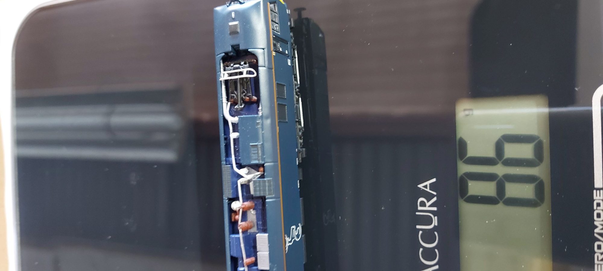

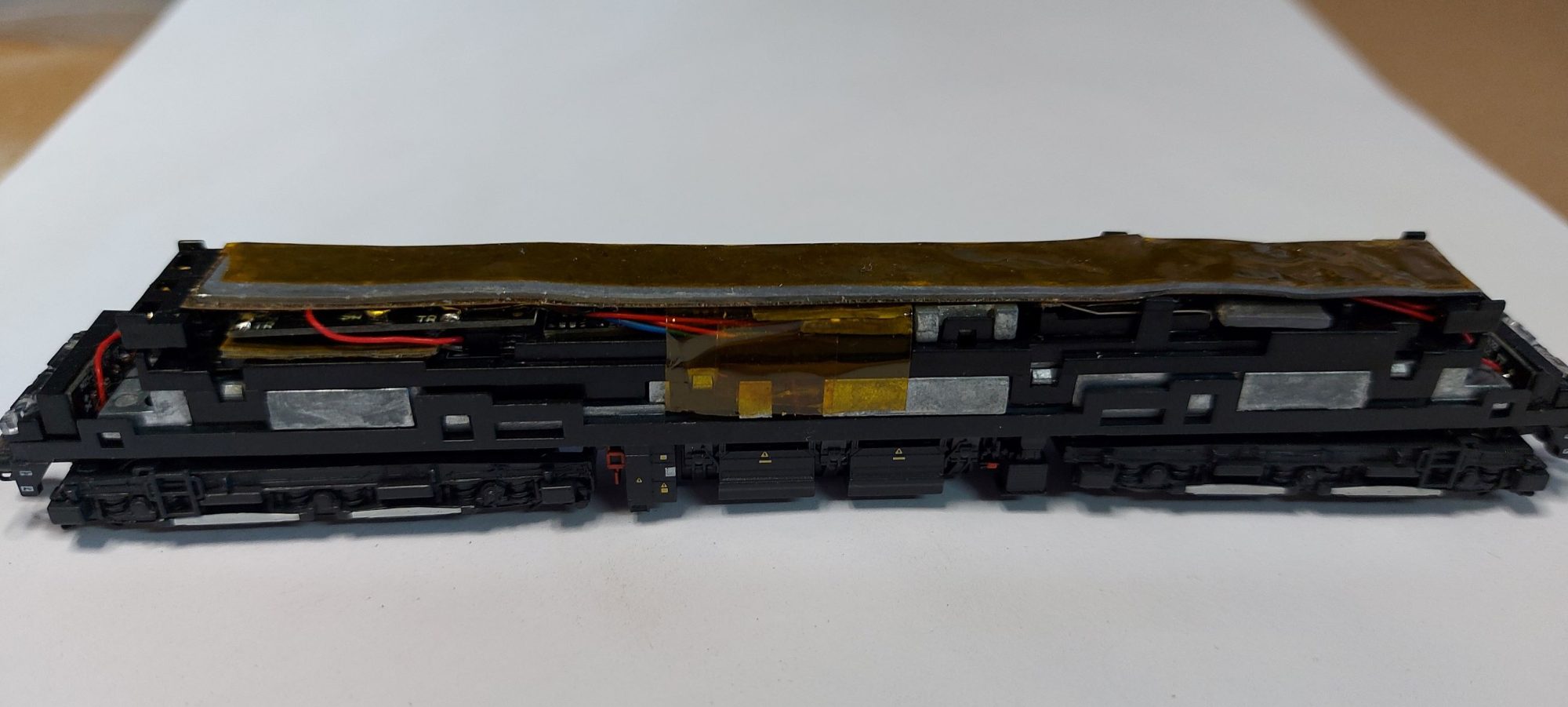

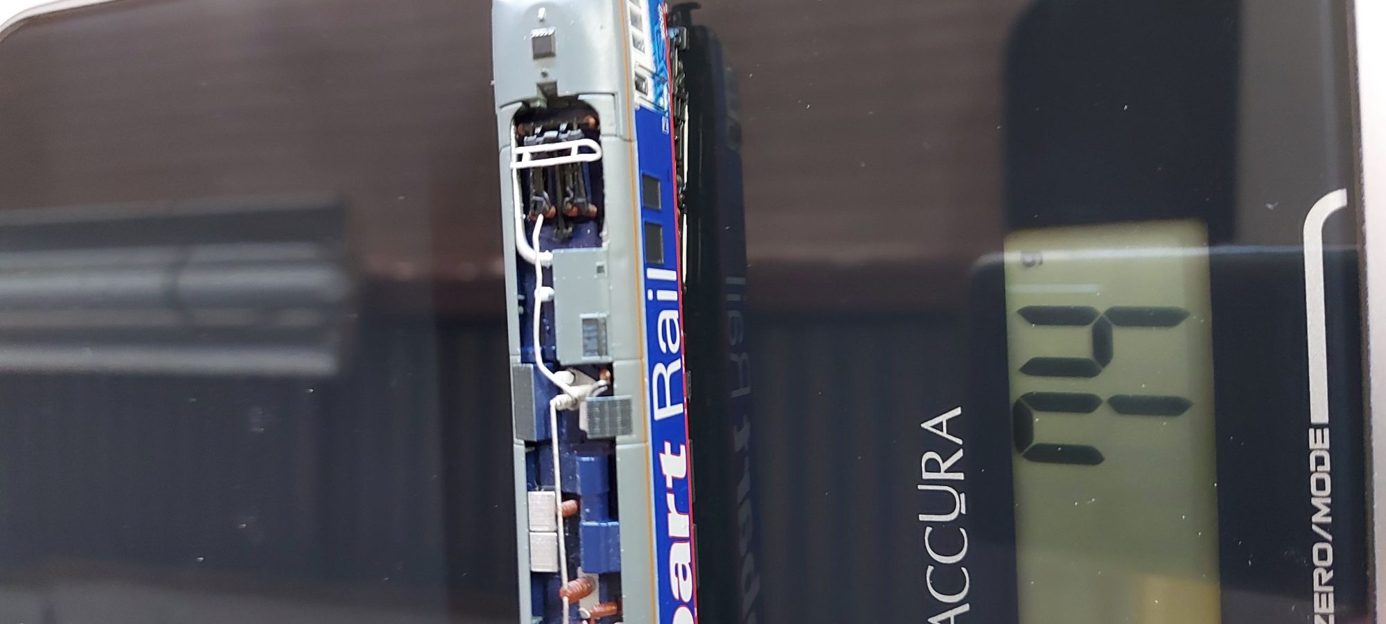

@jpendle and @njee20 as promised, here are some pics of how I added weight to the 92's. I probably should also add these to the 92 thread.
1. here is a 92 straight out of the box, this one is sound fitted, as can be seen 74g
2. this is after I have added the weight. non sound. and as you can see 86g
3. lastly this is all the weight added
all the weight added is basically lead sheet cut and hammered down to the size required then covered in Kapton tape to eliminate any shorting issues, on the large piece which sits on the top I have 3 layers of Kapton tape.
basically I am just filling holes with lead to help with the traction. It does help.
Roy L S

I added the weight pretty much within 3mths of receiving the 92's and they have run a lot since then with no problems.
When I mean a lot, to do a full circuit of the club layout takes approx 40mins at a scale 60mph, and these would have run for many hours on the layout. I would normally run 2 or 3 circuits on a club night so I think this speaks volumes for the reliability of the loco's and motors used.
cheers
Roy L S

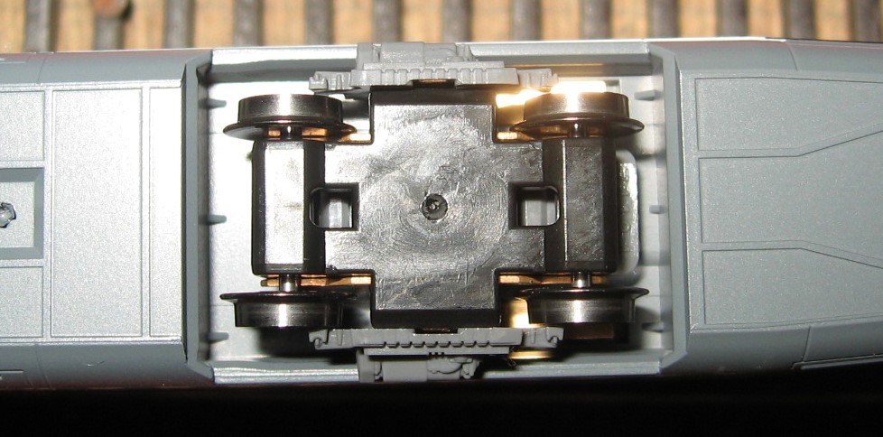

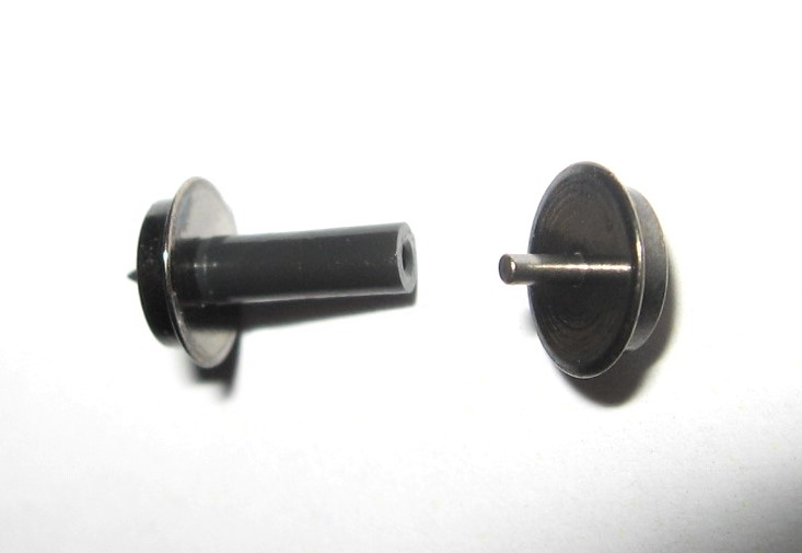

@jpendle Kato typically uses two half-axles (stub axles) pushed into a plastic centre which keeps them isolated from each other.  This then allows each wheel to be live as a pickup, with power transmitted through the pinpoint axle ends to phosphor-bronze axleboxes and then up to the mechanism. It's a reliable method which has much less drag than wiper pickups, and all wheels can pick up (some older designs of bogie pickups  eg. older Fleischmann, Minitrix have only one wheel live to the metal axle, with a wiper contact to the axle. Thus only 2 wheels of a bogie pick up power)
Here's an example of the pinpoint axle version
In the case of these ICE 4 inside bearing wheels there are obviously no pinpoint axles, but just behind the wheels you can just about see they're supported in thin metal strip bearings.    I would imagine the separating collar is different to that of the pinpoint axle version, given that there needs to be some bare metal axle for the bearing.  I expect it's still a plastic tube but with a definite plug in the middle to maintain separation and to keep the required back-to-back distance.
I've not actually had a bogie apart to see the full arrangement, and don't intend to fiddle unless something misbehaves in the future. For now they are running nicely - not as freely as pinpoint axles do but definitely much better than other brands of coach which still use wiper pickups.  Give one of these a gentle push and it glides for up to a metre without any obvious  immediate friction effect.
It stands to reason you won't want to be lubricating these bearings as you'd risk the build-up of non-conductive crud as we see in locos with stub axles and chassis bearings.
