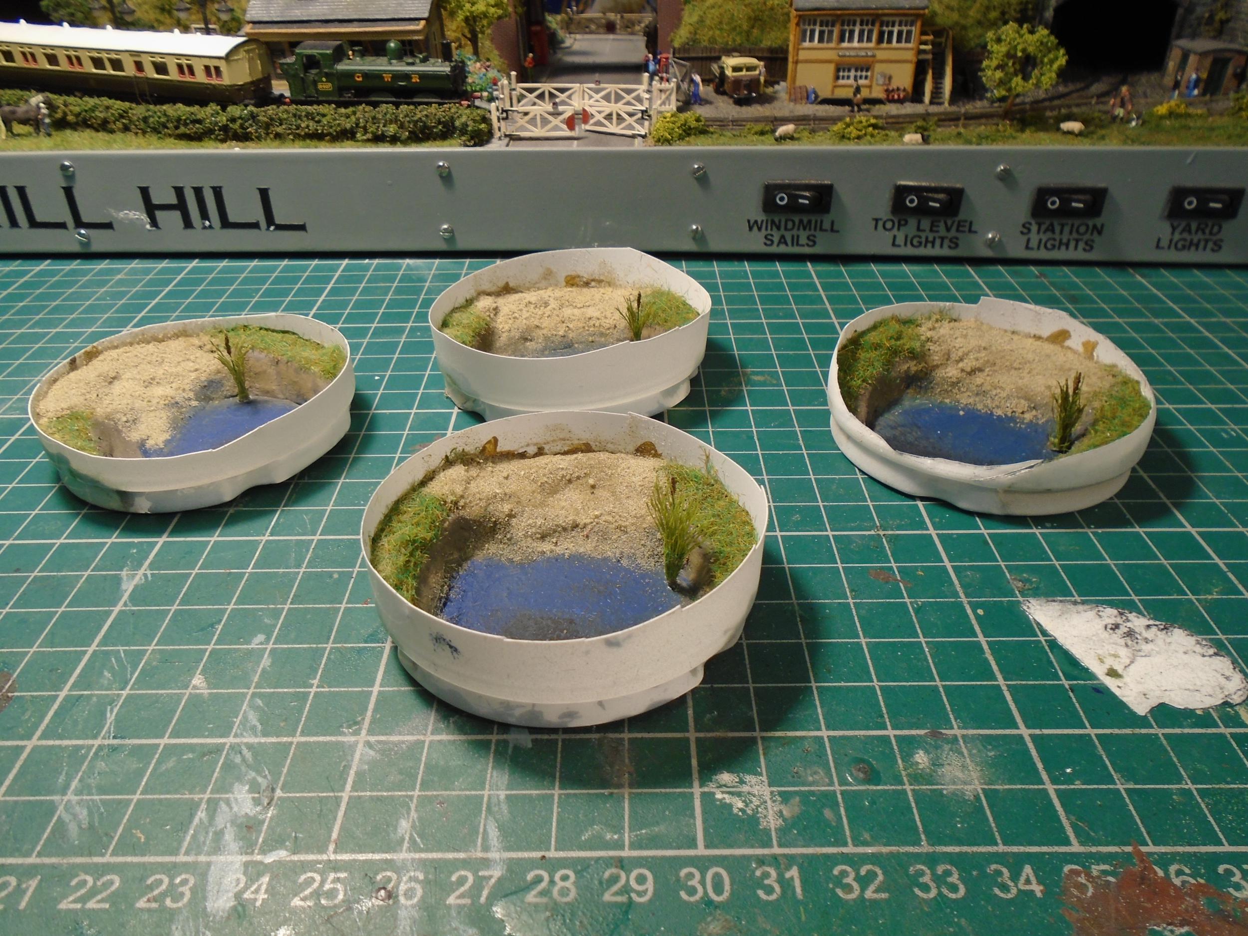

When I filled the lake on Windmill Hill, I used Woodland scenic solid water, which I believe is a very similar ( if not identical  ;) ) product.
I painted the bottom of the lake with enamel colours, making the centre darker to show it being deeper. All the stones, gravel bits, and foliage I glued down with superglue. Then I checked for leaks, this is really important. I poured water into the lake. This reassured  me there were thankfully no leaks ( thinking about it, that was probably a bit stupid, as I'm not sure what I would have done if there were any  :-[ :worried: :-[) It did however show me the water level when full  :D. The water was then soaked up with a paper towel.

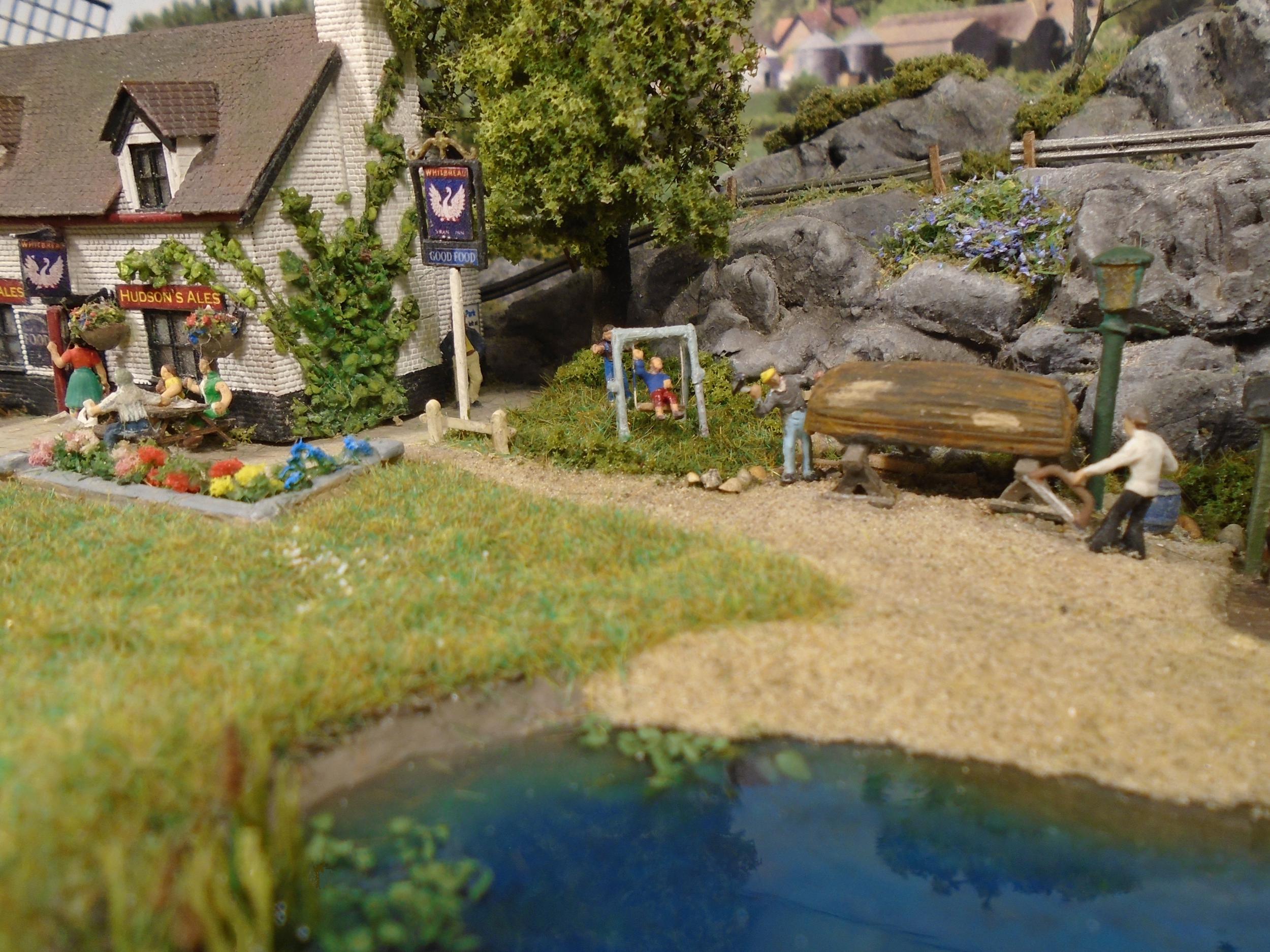

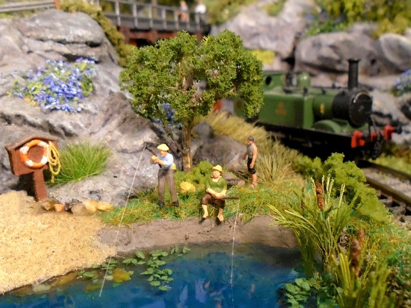

This is the "dry" lake. The bulrushes are these, and look really good when trimmed a bit. The fishermen's lines are my own hair, superglued to the bottom of the lake.
https://www.modelscenerysupplies.co.uk/N-Gauge-Bulrushes

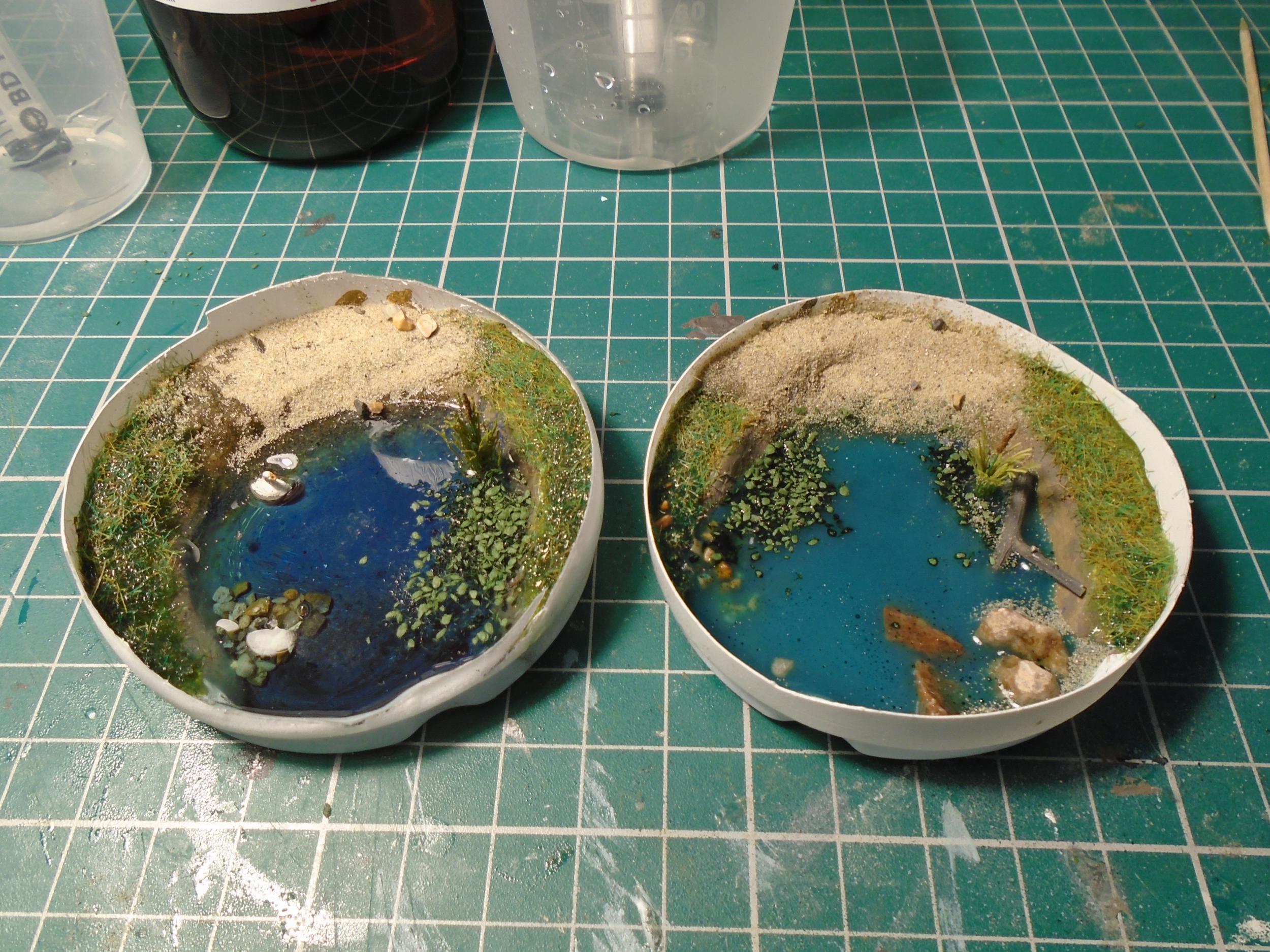

Then I made a few "Mini lakes" to practice on .....

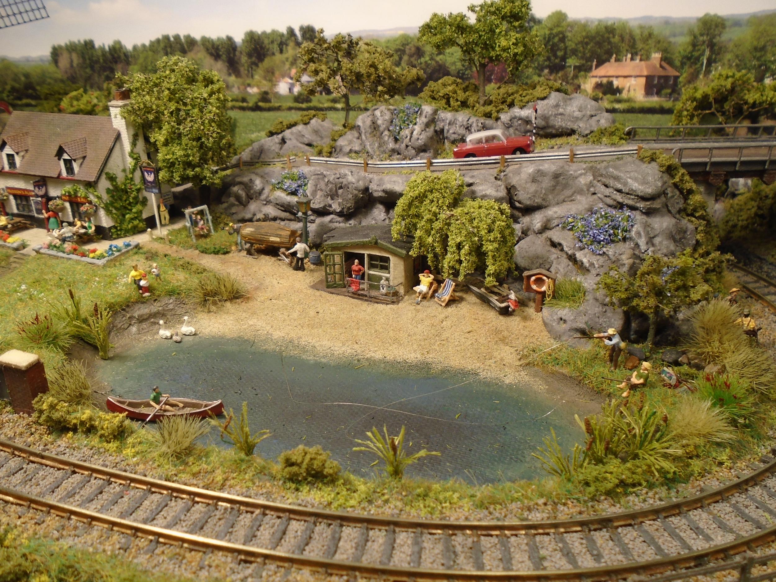

This is the look of the lake I wanted to portray, with the water colour taking on the reflection of a blue summer sky
I mixed a few colours to find what I thought looked best, and these were the most successful. Be aware that you need VERY FEW DROPS to colour the resin, so don't go mad  :no:
Another thing I found was more dye in the resin made the water more cloudy / opaque as seen on the right hand pond.
The water lillies were these leaves ....
https://www.howardscenicsupplies.co.uk/products/NOCH-07146-Leaves-%252d-Dark-Green-50g.html
Then the resin was mixed for the lake pour .....

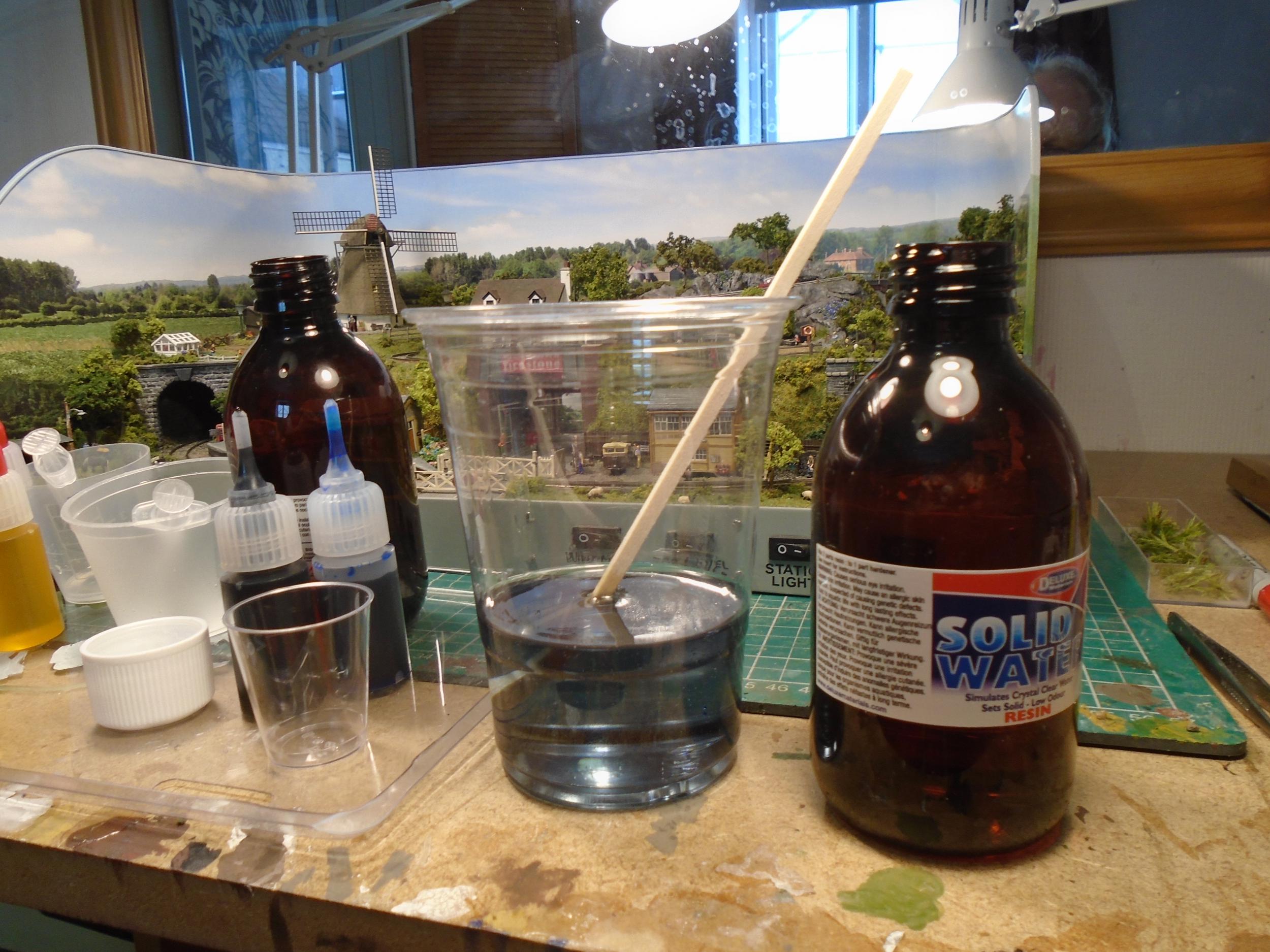

DON'T use these throw away plastic beakers to mix the resin in. With a concentrated cup load the resin gets very hot, and will melt the plastic ..... I know  :-[ (I didn't photo that as I was rather pre-occupied with mopping up spilt resin and melted cup :doh: ) I used a washed out tinned vegetable can second time. Maybe it was to do with the depth of resin, and the "Deep Water won't do that, but I would be careful.

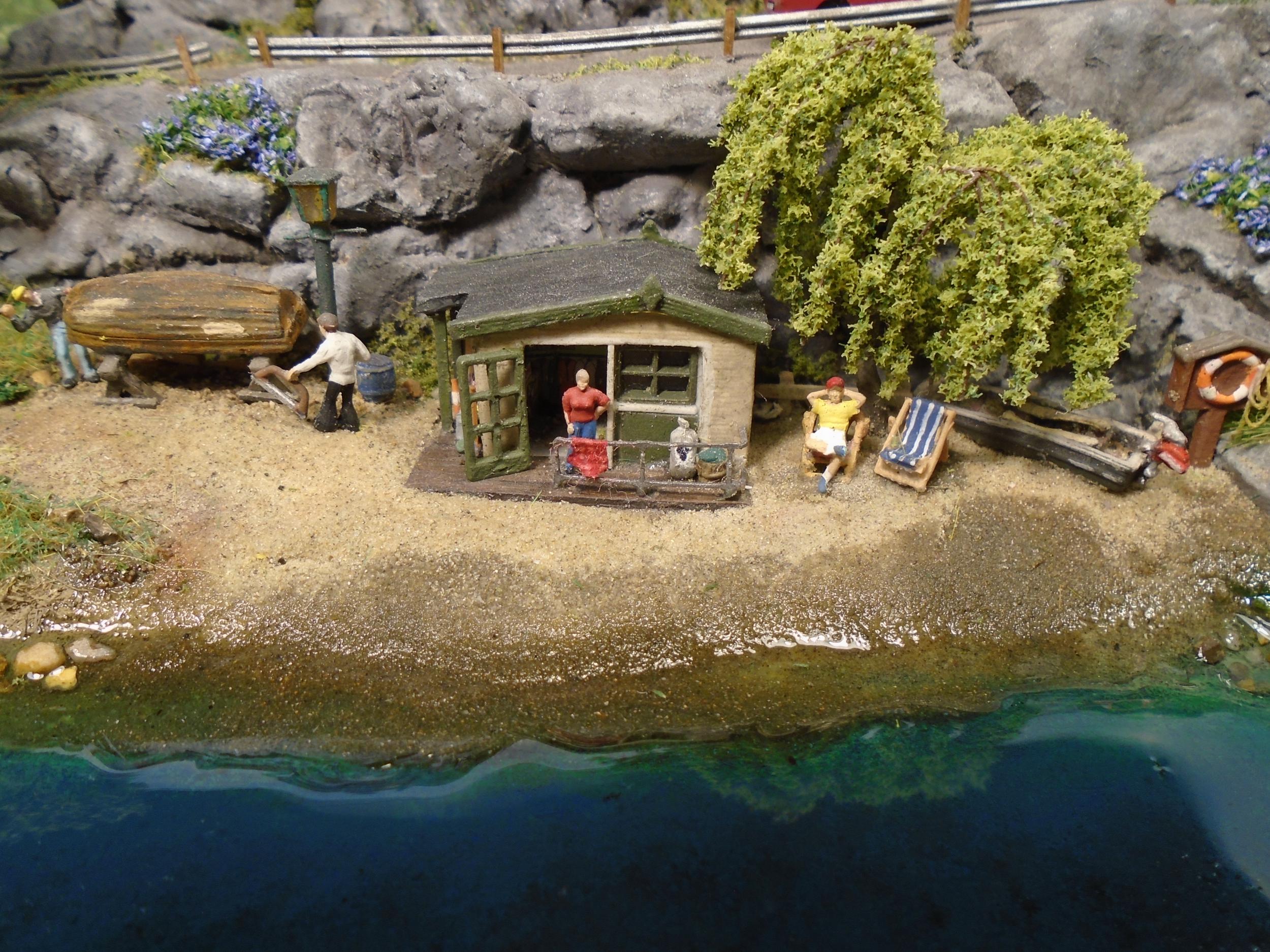

The resin had soaked into the sand and static grass round the lake and looked awful  :(

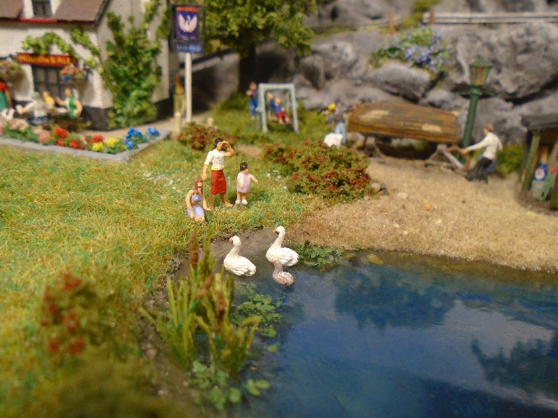

Although I was pleased with the colour, and the transparency showed the underwater rocks, I had to sort this, so I waited 48 hours to make sure the resin was absolutely hardened, and I took everything off the beach and put down a new thin layer of sand, and trimmed back and re did the spoilt grass. Here is the bit where thefamily feeding the swans will be .....

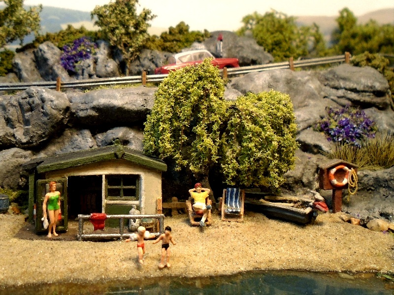

The waterlillies I glued in place with diluted PVA, to which I added a little brown acrylic so when dried would make the water round them look a little cloudy, and I added just a little gloss varnish along the waterline.
Here's how it looks now ....
Sorry I seem to have rambled on a bit, but those were my experiences with Woodland Scenic Water. Boiling it down to one main bit of advice ...... practice off layout, 'cos once it's down that's it  :D ;) :D
