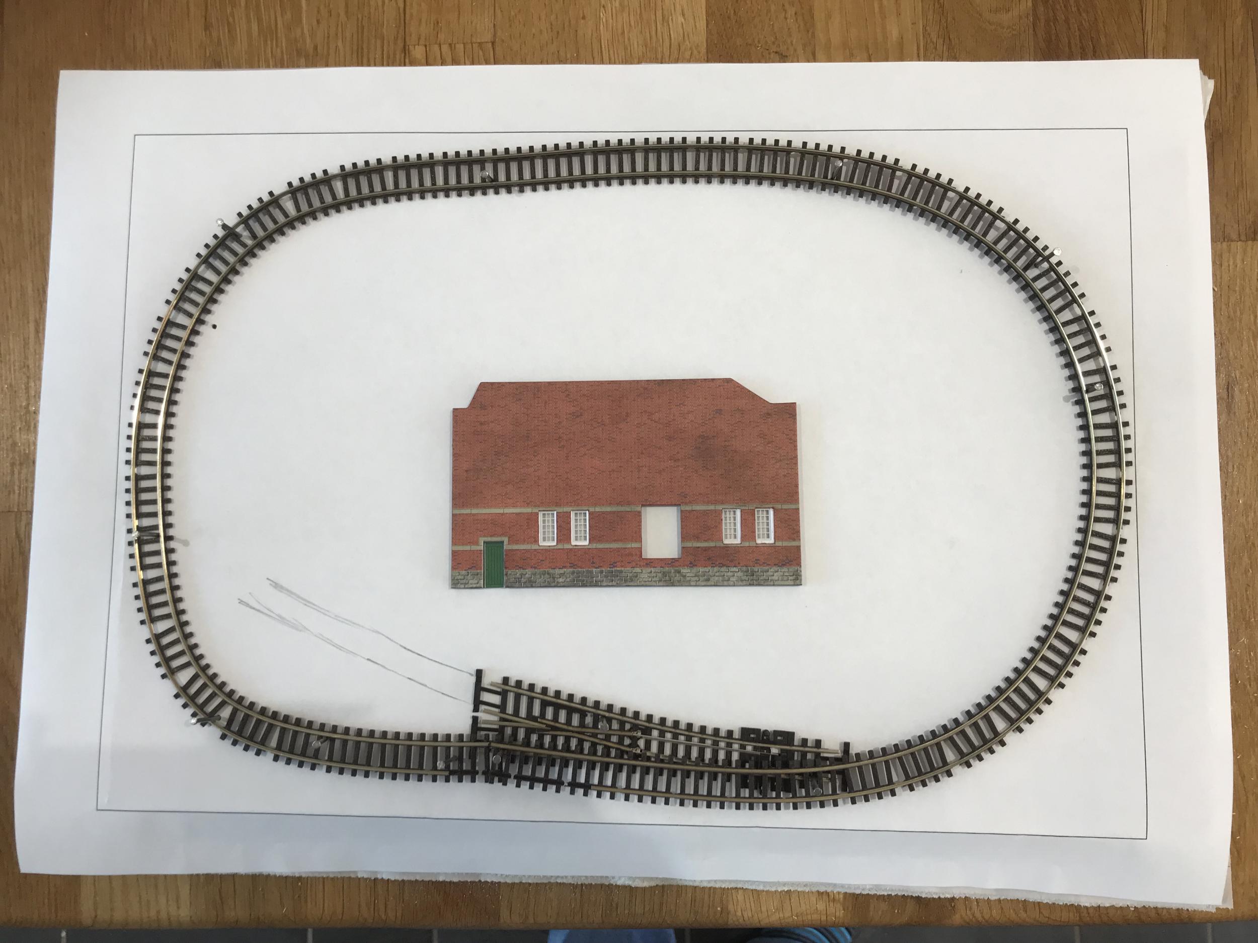

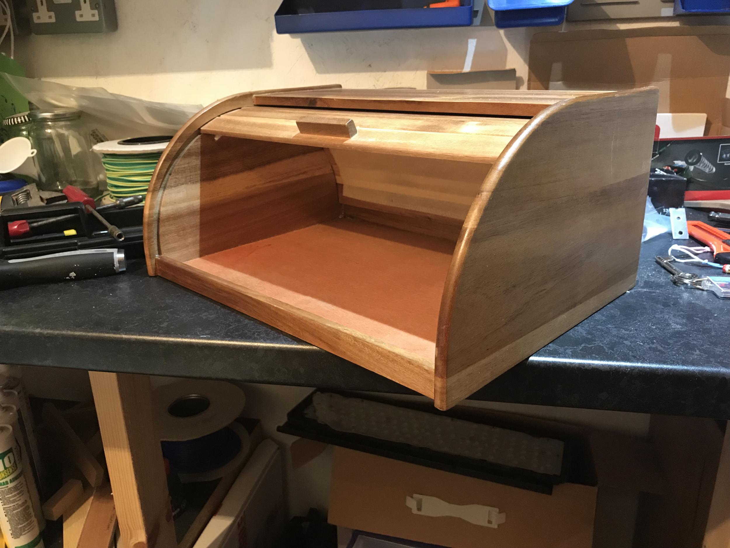

So the layout measures 360mm wide by 245mm deep (14” x 9 ½” for those who are that way inclined). There is also the obvious height restriction which varies because of the curved shape. I had a few simple “goals” for the layout;
It should have a roundy-roundy loop;
I’d like some form of operational ability (I want to play trains!);
It will be a night scene with lighting built into the layout (possibly activated by the lid);
The bread bin must not look any different from the outside with the lid down;
“Rule 1” applies. Not limited to an era or geographical accuracy (It’s just a bit of fun);
I also stated on the planning thread that I’d like it to be battery powered but on further thought for both space and cost reasons; I will now be mains powered. After a few simple plans both scribbled and in CAD I decided on a simple loop with a turnout sending deliveries into the middle of the loop to the bread factory (it just had to be didn’t it).

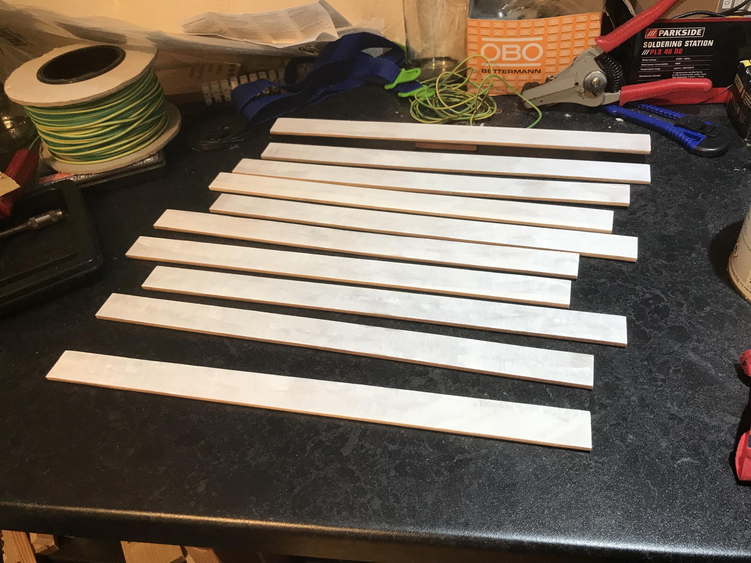

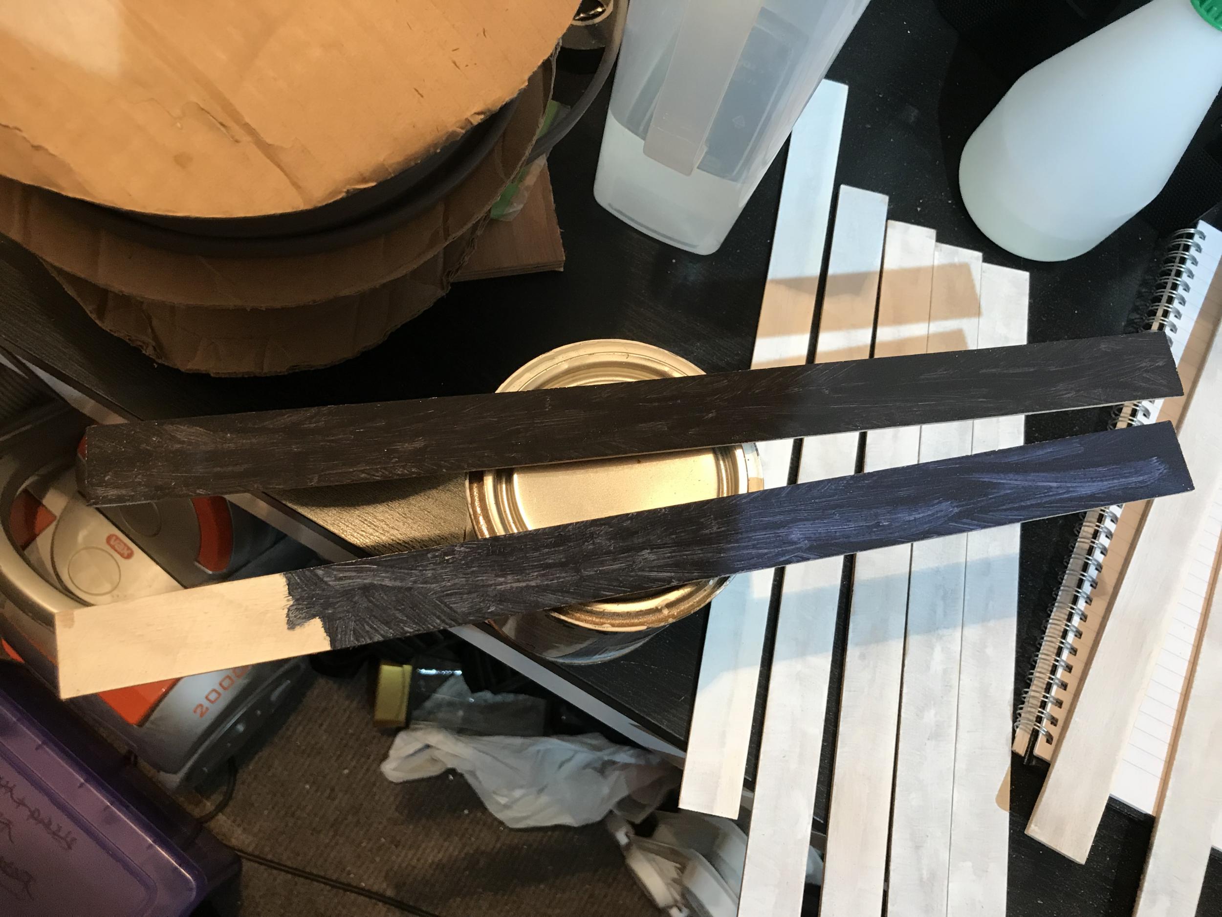

The slats have been removed and primed for painting. This also gives me more room to work.
I have had a little play with night sky colours but nothing is decided yet.

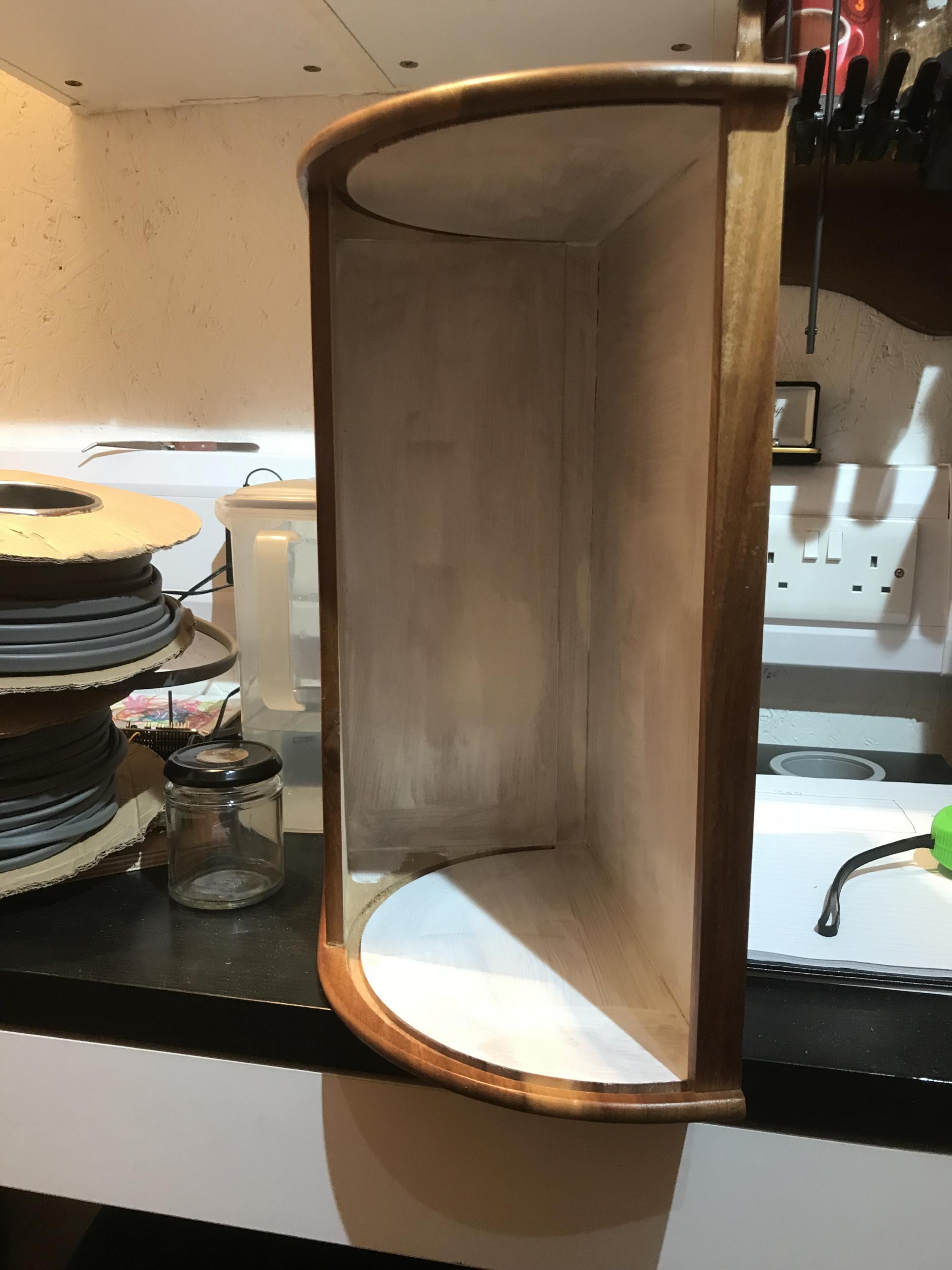

The bin itself is primed

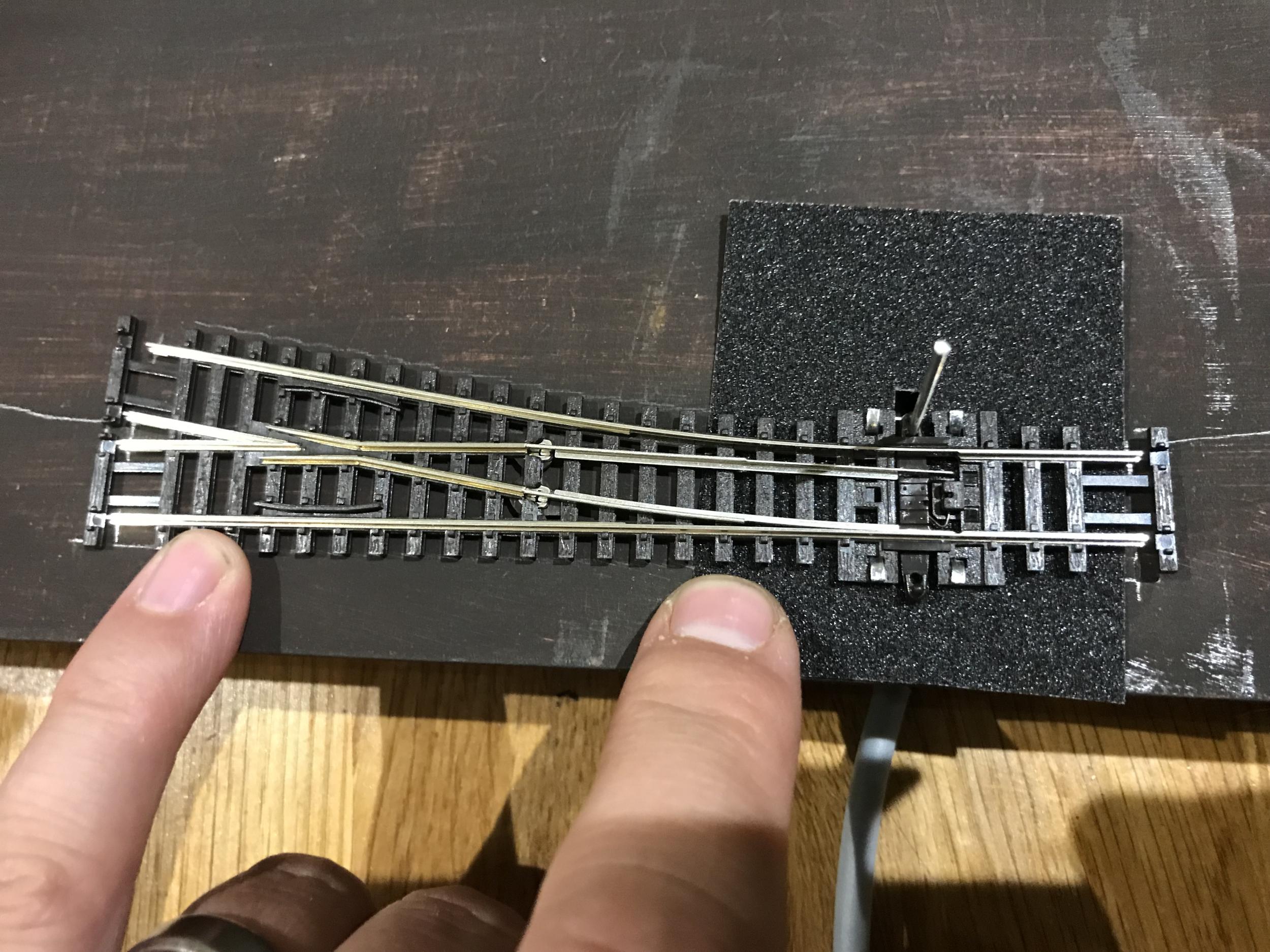

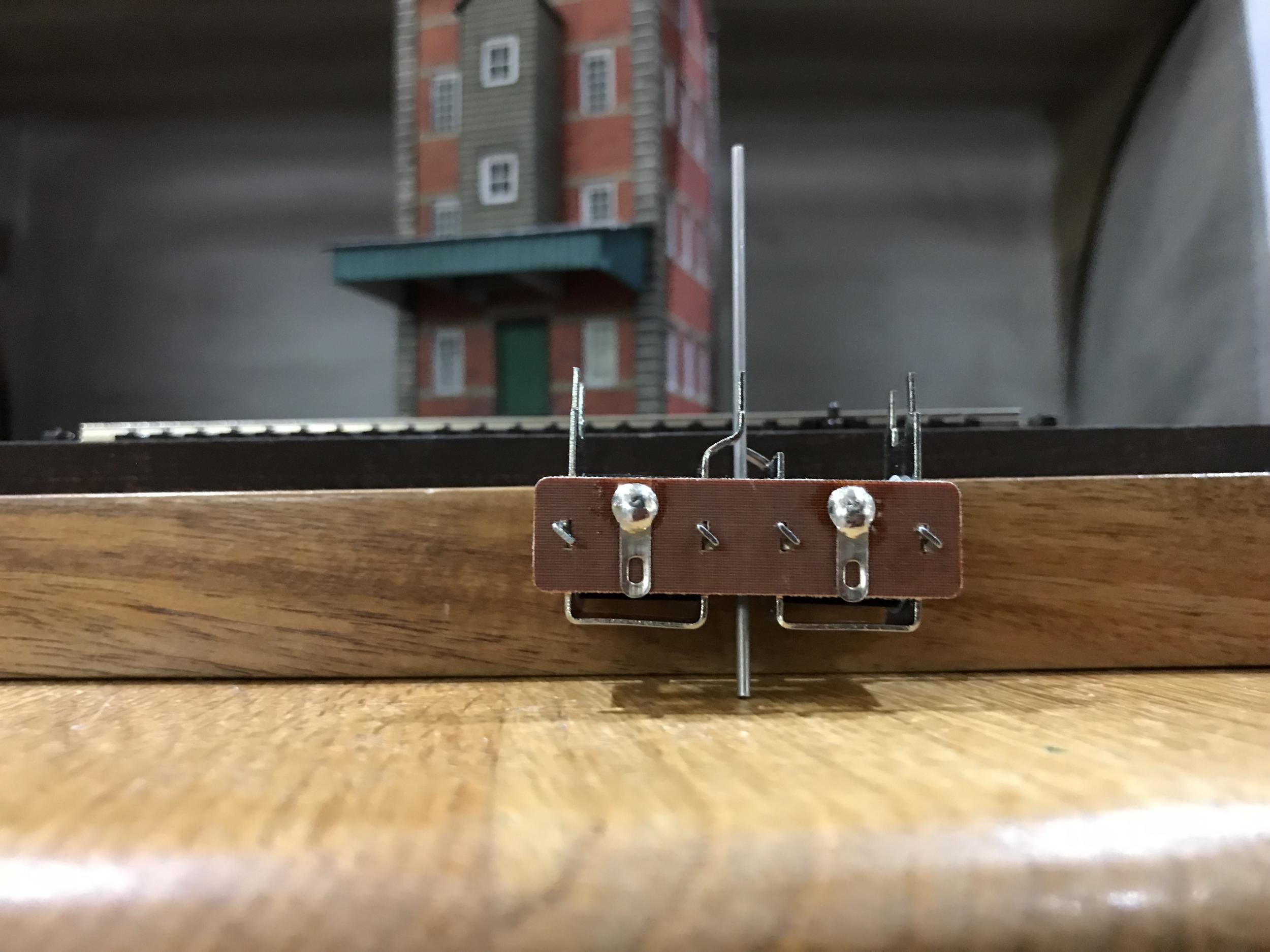

The baseboard is primed, painted and has the turnout fitted. Because of height restrictions I kept it as thin as I dared and also had to fit the turnout directly to the track which was a first for me (in fact turnouts are a first and so too is Peco track. I’ve only used Kato Unitrack before this project).

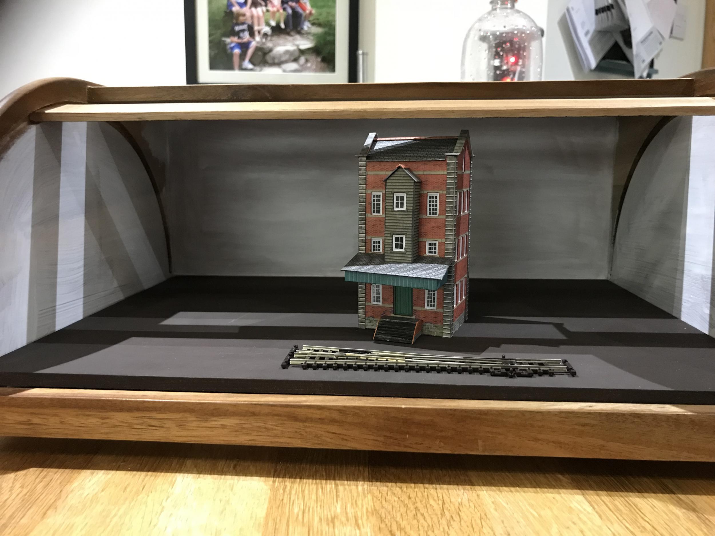

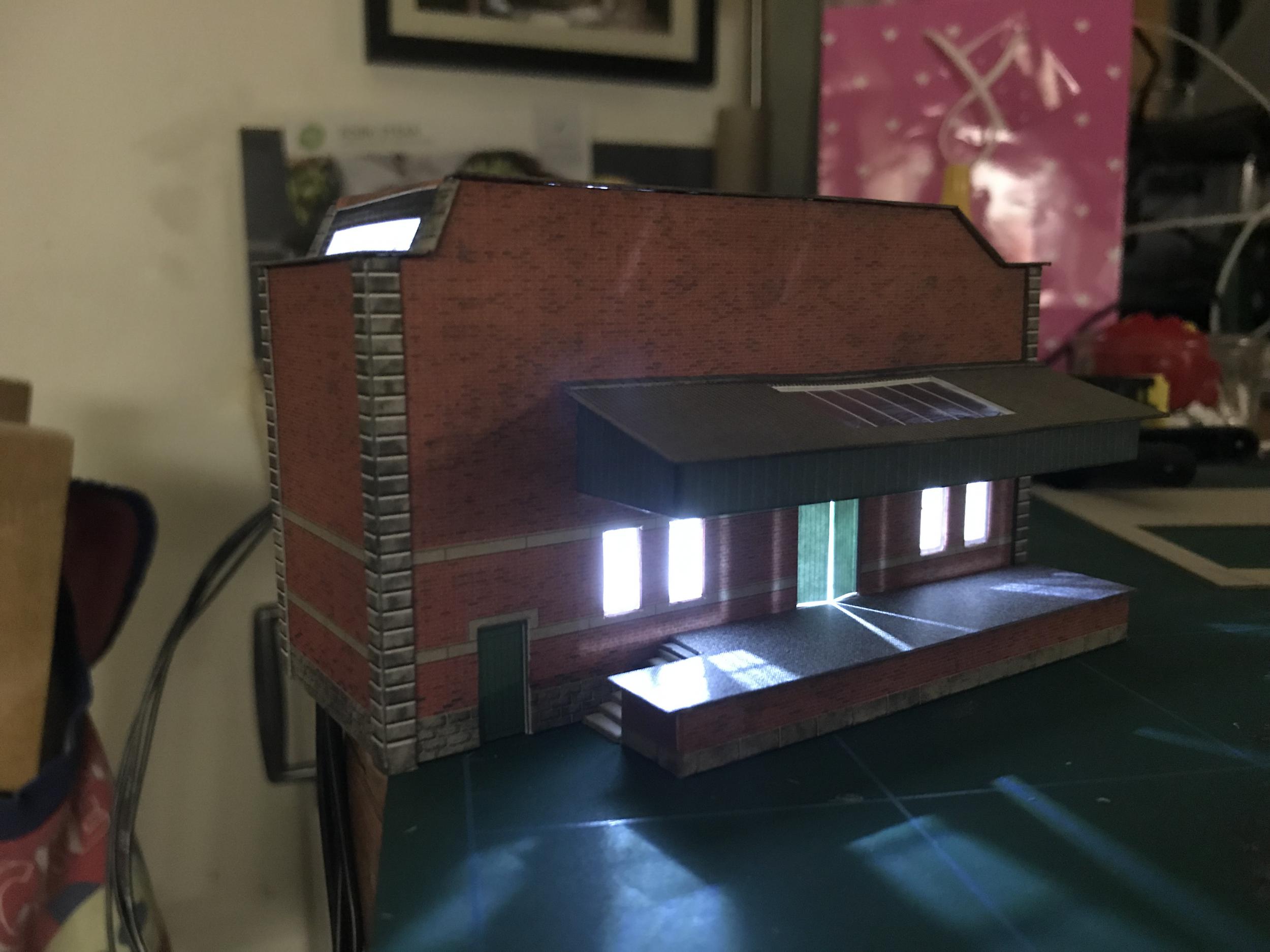

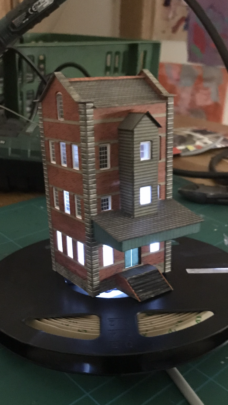

As you can see from the pic above I have gone for the metcalfe small factory as the “centre-piece”. I have modified building B to look more like the company offices than a warehouse and have been playing with lighting. It’s my first try at building kits so it’s taken a while and I’ve made a few mistakes but hopefully nothing to noticeable (if you do notice anything then please don’t tell me  :-X )

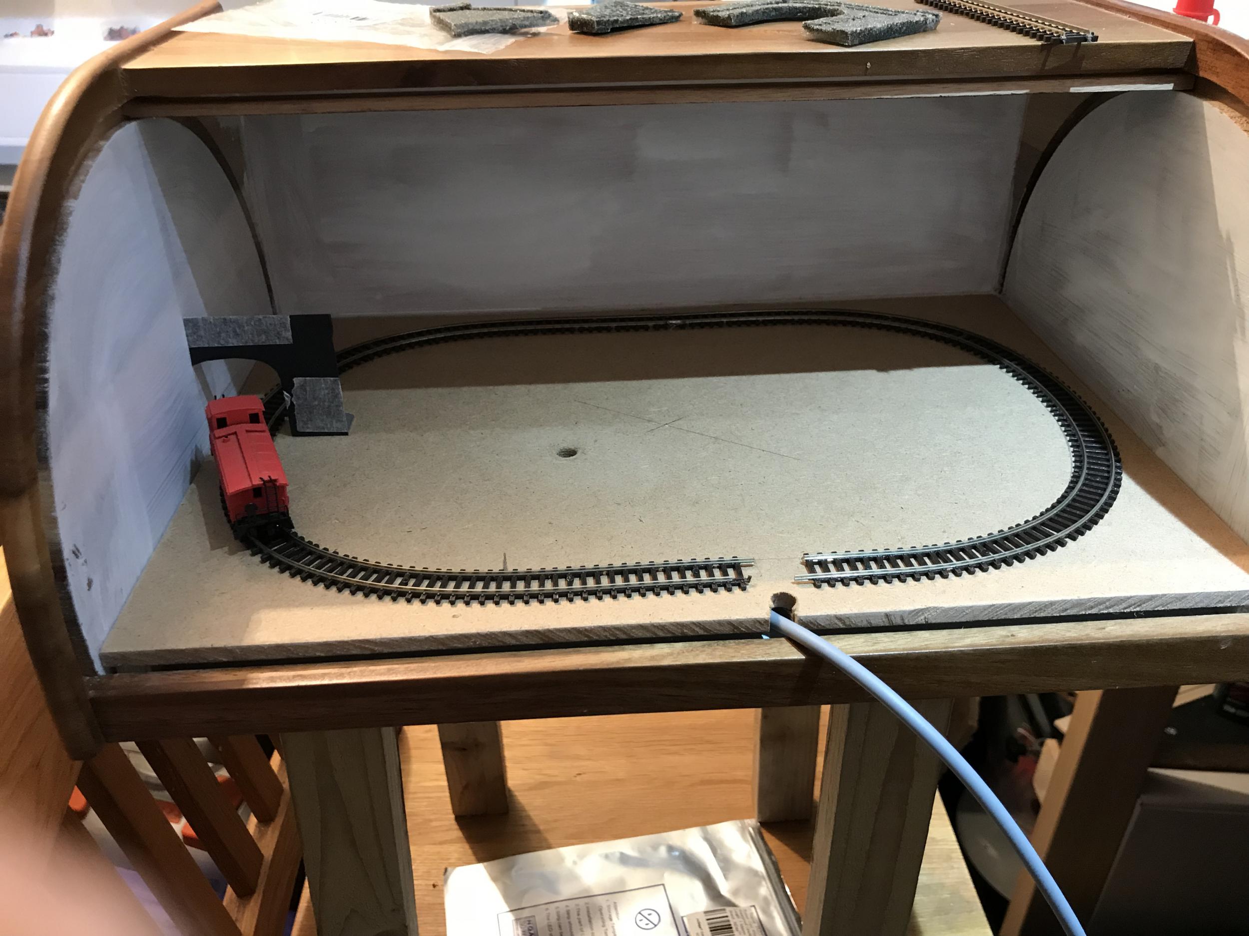

Today I mocked up the loop on a temporary baseboard to test the loco and rolling stock when they arrive later this week. This seems a bit frivolous but that’s the beauty of a micro layout I guess. Reading lots of other micro-layout threads and taking advice from those that know I wanted to be 100% sure of the loco running well on the tight curves and check clearances before committing to the final track position. My little non-powered caboose runs nicely around it so that’s a good sign!
There will be a tunnel providing a scenic break on the left hand side. The current plan is to have low relief industrial buildings along the back to hide the back section of the loop but I’m still undecided on the right hand side. I like the idea of a level crossing providing access to the factory yard/employee entrance but I’m not sure yet how to make the track “disappear” before going behind the buildings along the back…… I’m still planning as I go so any suggestions/advice would be very welcome.

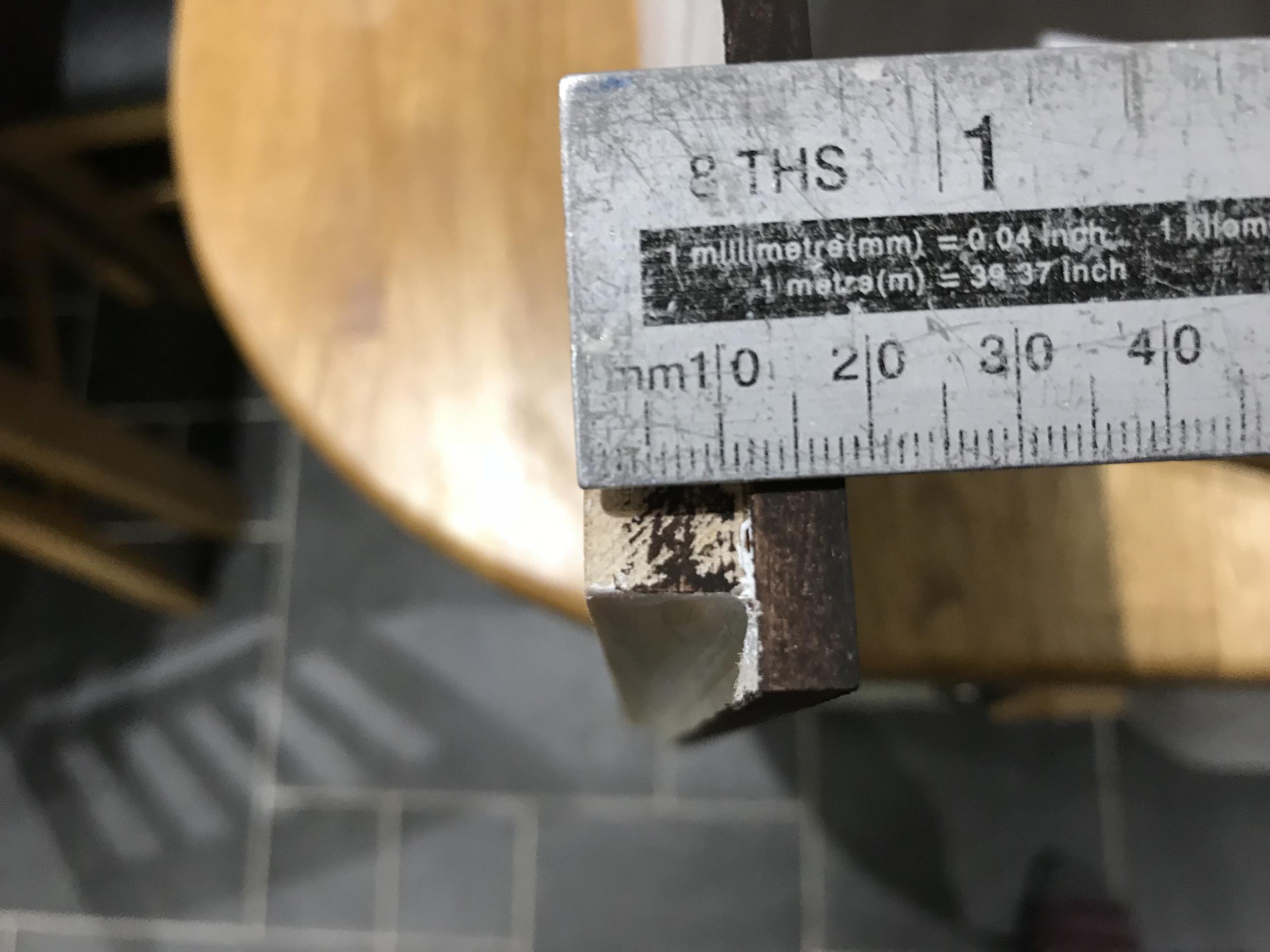

I forgot to mention the front edge of the baseboard which is exposed in the pics above. I have already broken one of my rules... but only very slightly and only the most eagle-eyed of bread bin aficionado's will notice it. The bottom slat with the handle will be bumped up one and one slat will remain fixed at the bottom to cover the front edge of the baseboard.....

The post lady came bearing gifts today!
My little eBay Arnold shunter and the rolling stock from Hattons;
I’m pleased to report that the train runs smoothly in both directions. It looks better running slower at 9v than 12v so I’ll have to remember that when planning the electrics.  8)
Next job is to lay the track on the main layout with the point fitted and hope it runs just as nicely!
