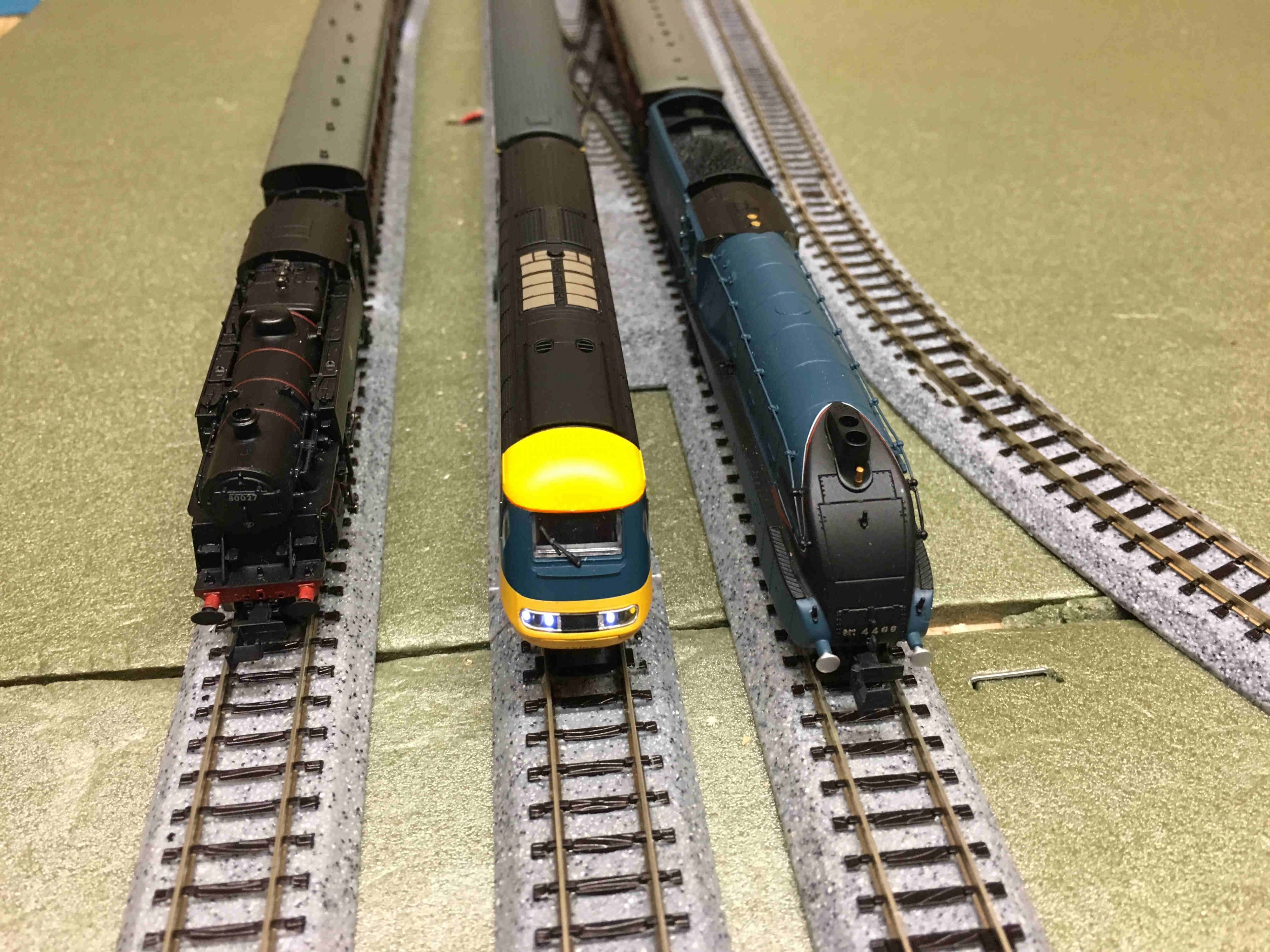

I was on the Hattons watchlist for one of these and they emailed last week.  I snapped it up.  DCC fitted, the coaches in the set had light bars fitted (as did the second hand MK3 I bought at the same time.)  I also bought two new mk3s so will fit light bars to them next month.  It's fantastic!  Incidentally, the trailing car shows white light for forward and red when trailing, but the power car only light when going forward.  Is it just unlucky that the red led isn't working or is there some DCC jiggery-pokery that will sort it?

Two things at play here...
Lights in the dummy reversed - as Only Me says put both on the programme track back to back (that bit’s important) when you program them.
No red lights in the powered car - the red LED on the lighting board has probably failed or the wire’s come unsoldered, both relatively easy fixes, if a bit fiddly.

The cause would seem to be a disconnected wire, looks like the soldering has gone.  A small, fiddly job and i'm not much of a solderer.  I might build a mock-up to practise on first (or I might just leave it)
