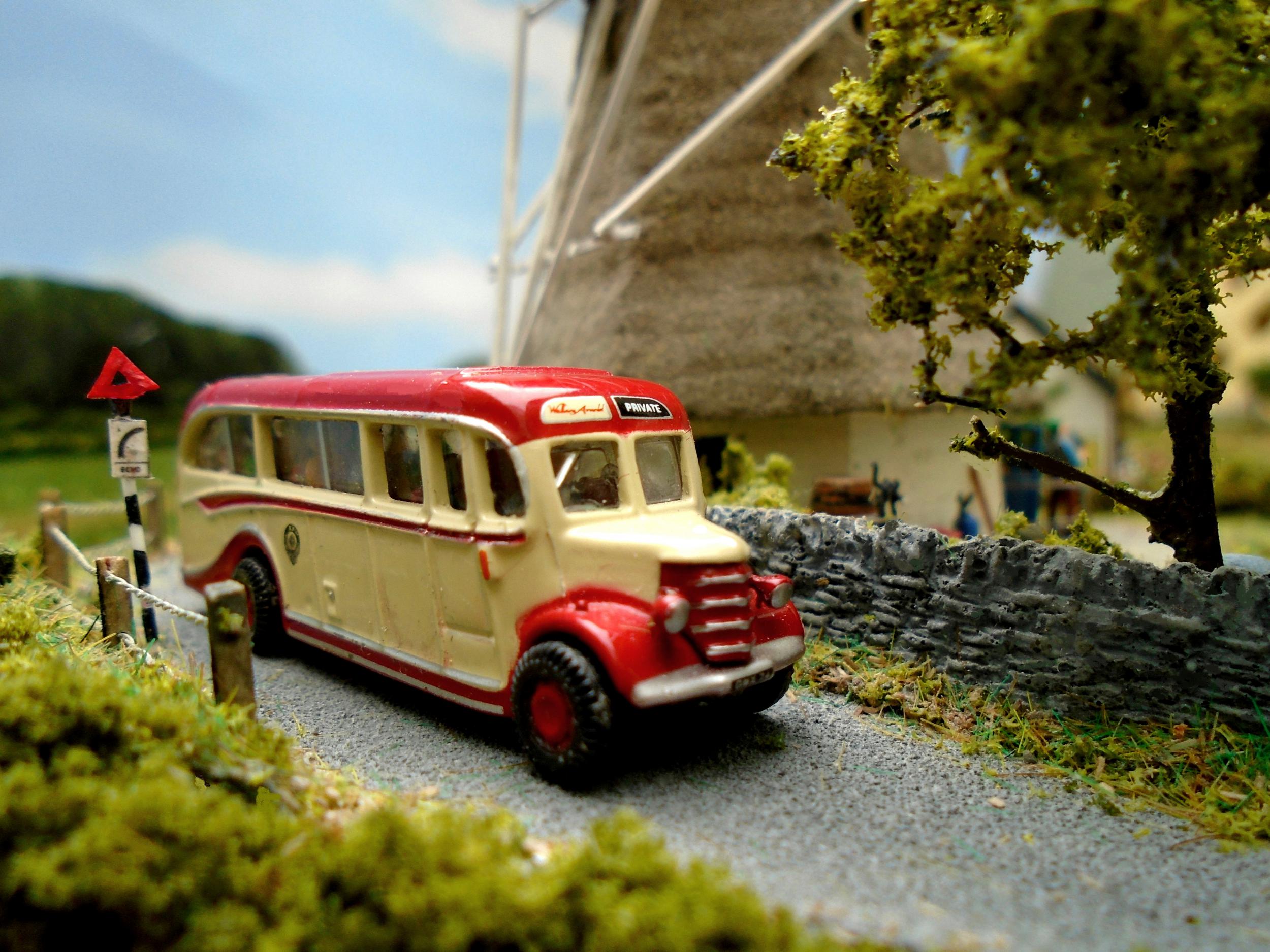

Ages ago I bought this Oxford Diecast coach, and had a go at putting a driver and passengers in it. Although they probably would not be seen in real life on the layout, I thought that photographs would show it to be empty, and it would look wrong.
It was a nightmare getting the people in, as the coach was riveted together, and really difficult to get into.  :worried:

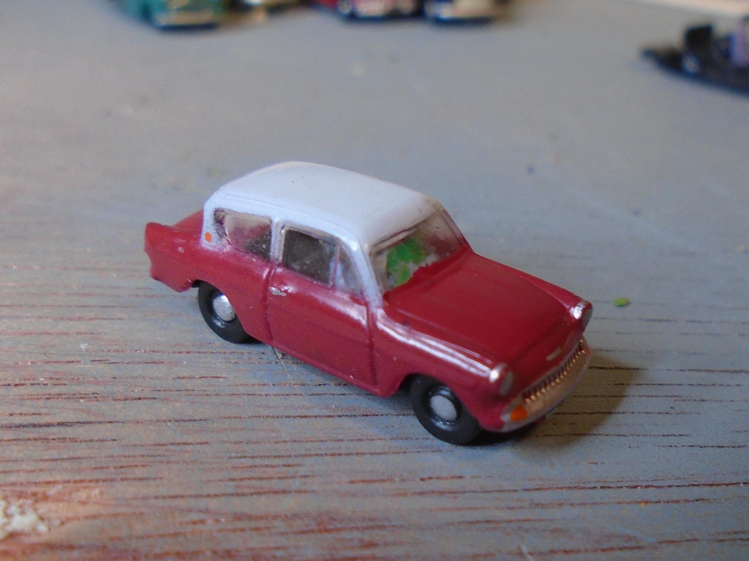

This made me wary of trying to get people into even smaller cars, so I avoided it by having cars parked, or people standing outside them , like this  :D ......

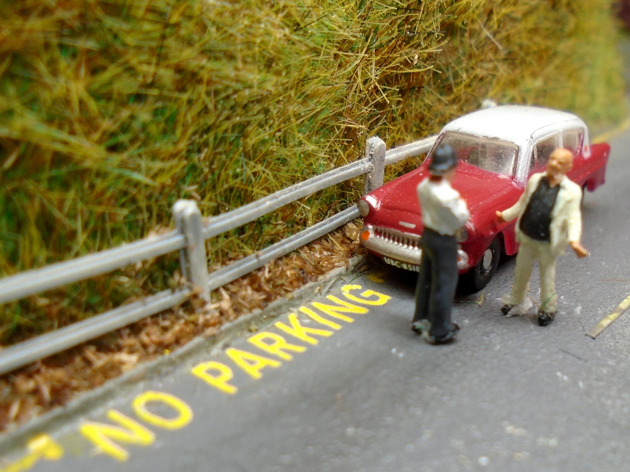

However, after taking photos like this next one, I thought I would have a go as you can clearly see the car is magically driving itself  :confused1:

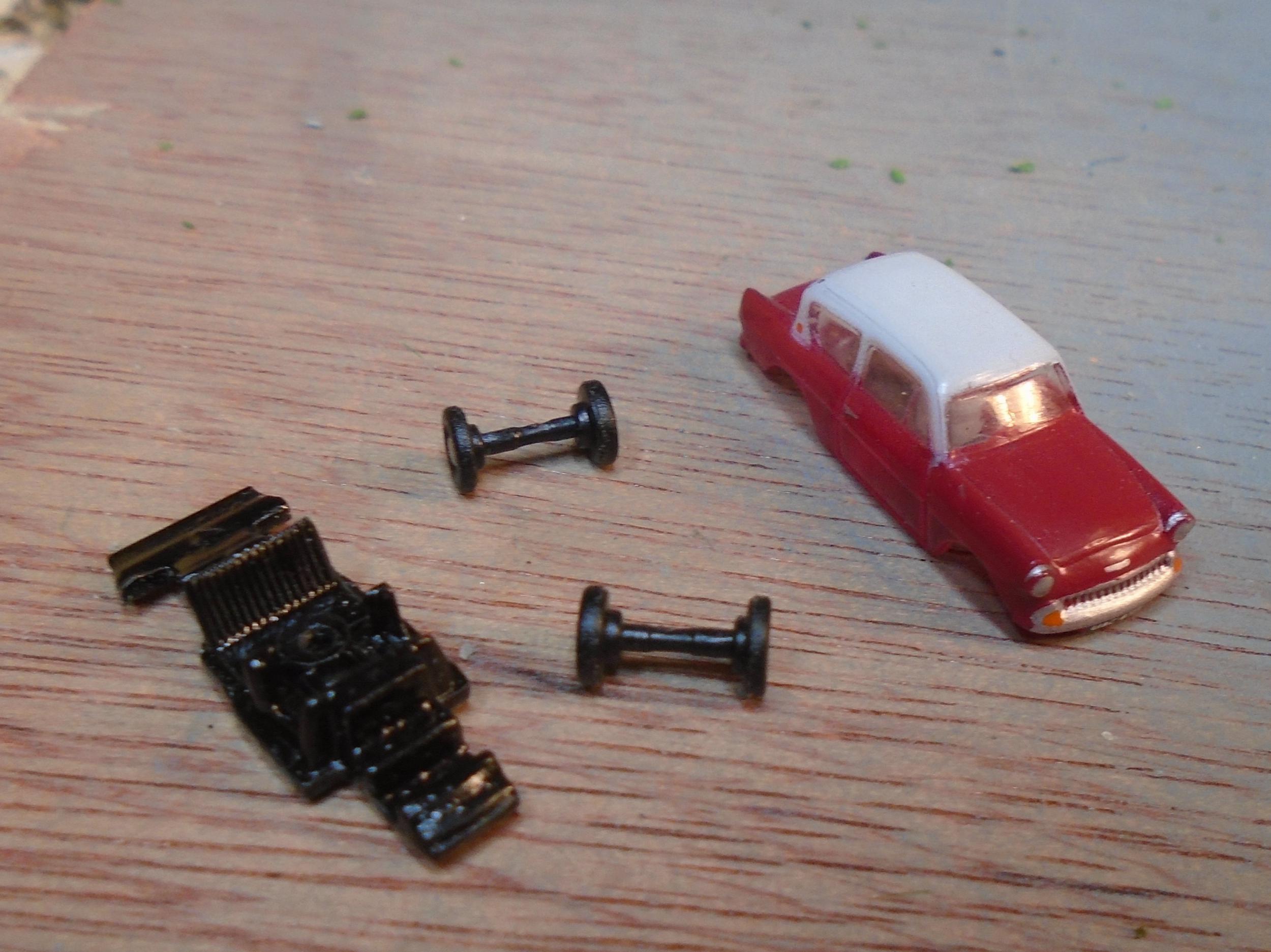

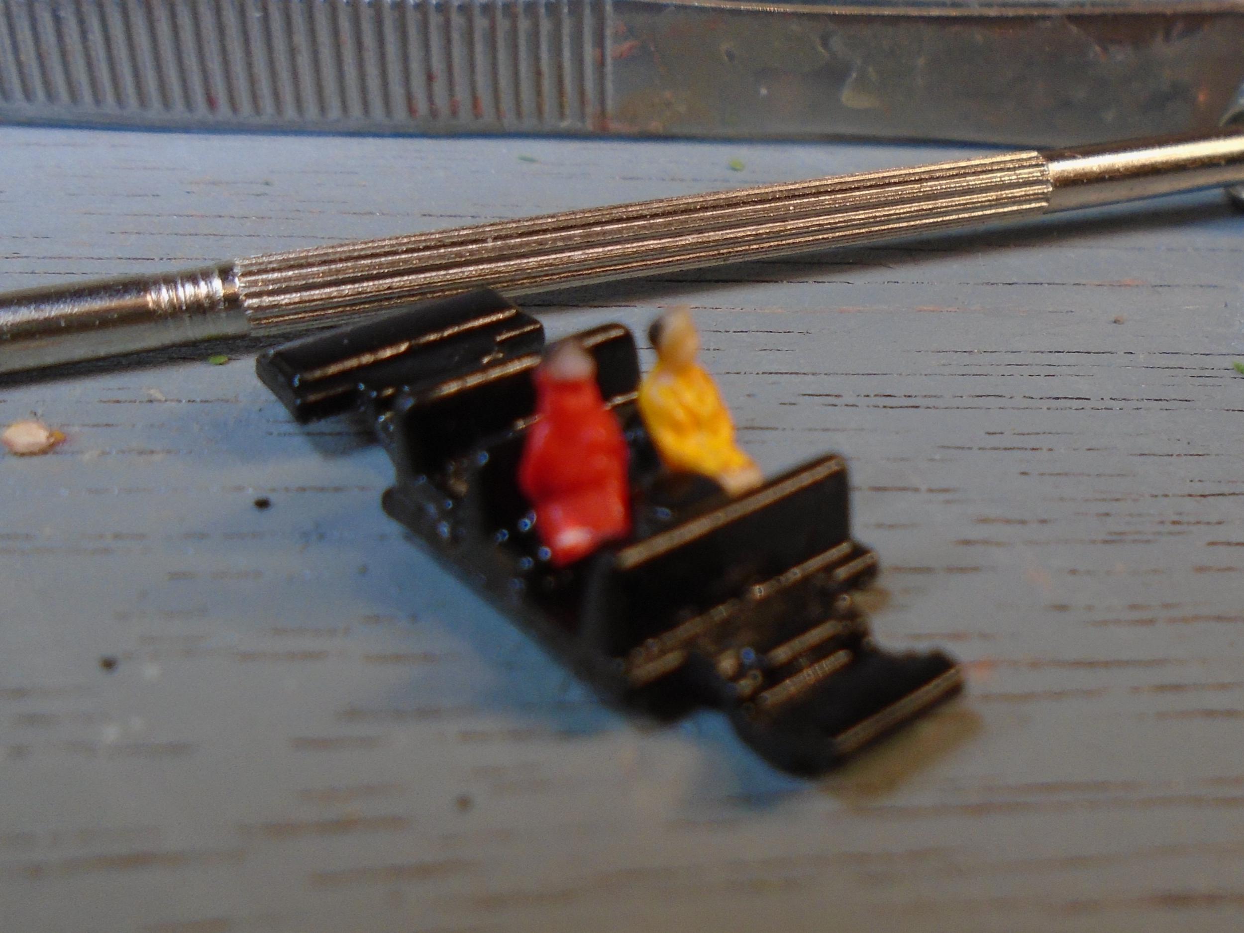

The cars are so easy to disassemble, as they are held together by just one single screw. When unscrewed with a tiny cross head screwdriver, these are the parts you get. The glazing and body stay together as one.

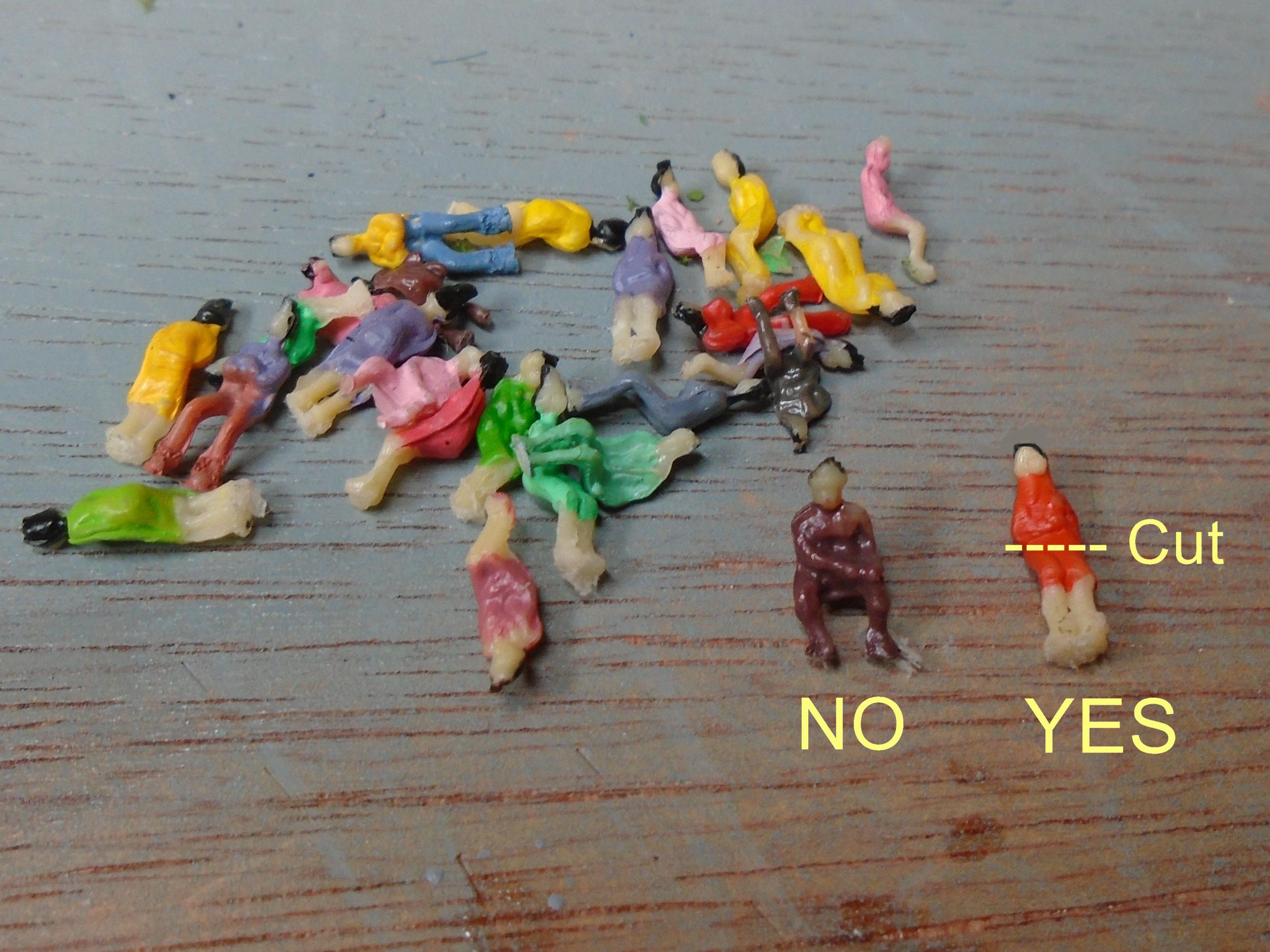

The figures I used are seated figures, from China via Ebay, and very cheap (as they are really nasty  ;) )

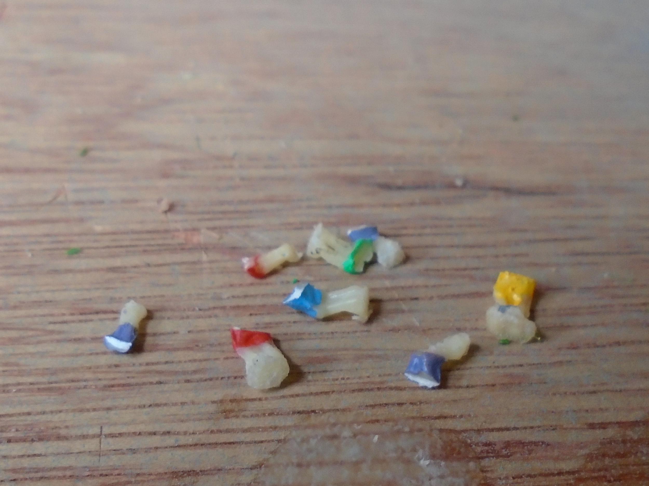

There are two main types. Fat ones (like the brown one) and thin ones (like the red one). The thin ones fit better, especially if you are going to have driver and passenger. Also, the bright colours are an advantage, as they can be seen better. Once you have chosen the people, they are then cut in half at waist level.

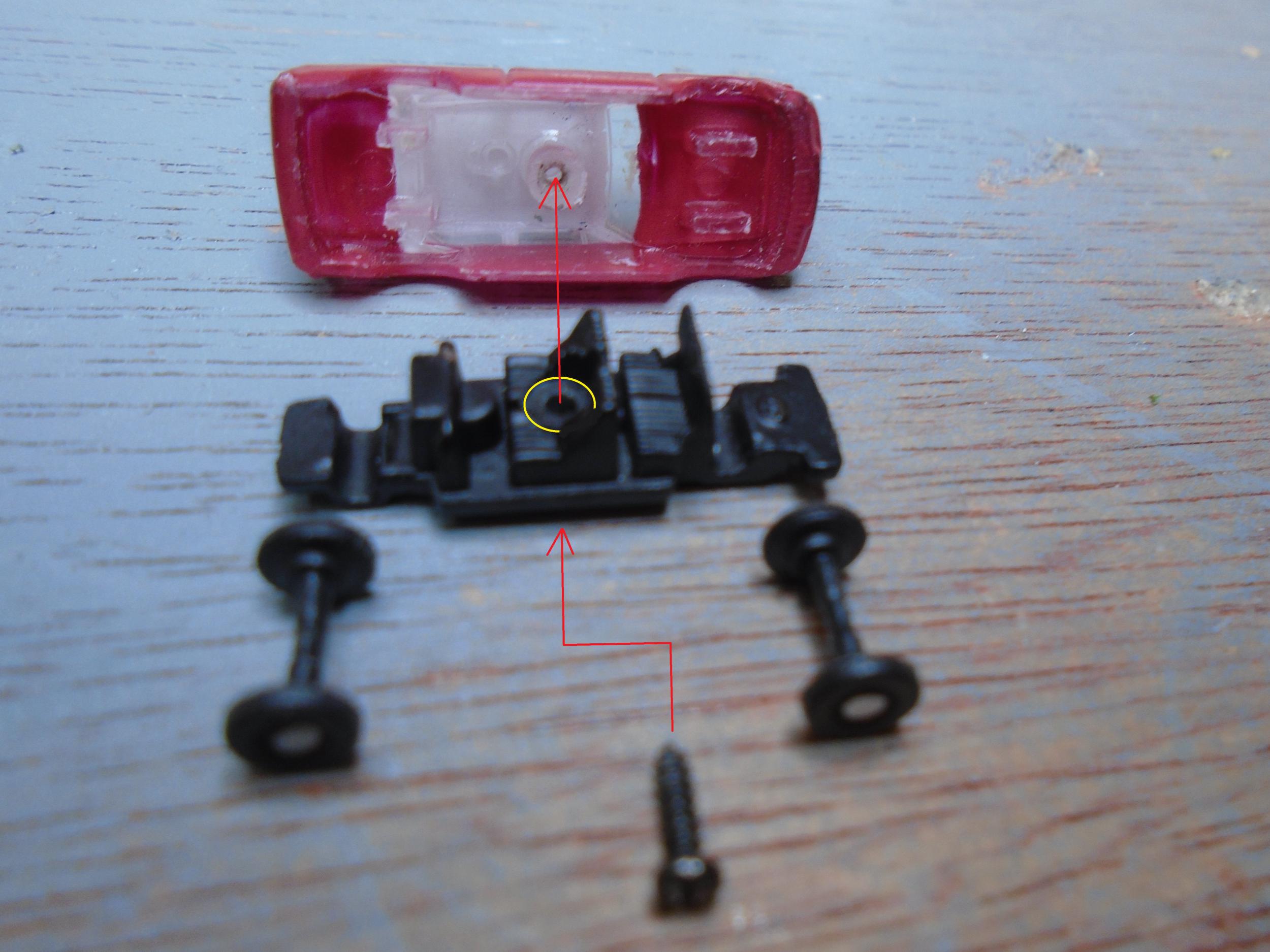

This is how the car fits back together, so when the cut figures are glued onto the chassis, make sure they are clear of the area outlined in yellow. This is where the "stem" of the glazing bit goes when you screw it all back together.
This is where it is an advantage to use thinner people .....
Then all is put back together ....... Easy Peasy  :thumbsup: :thumbsup:

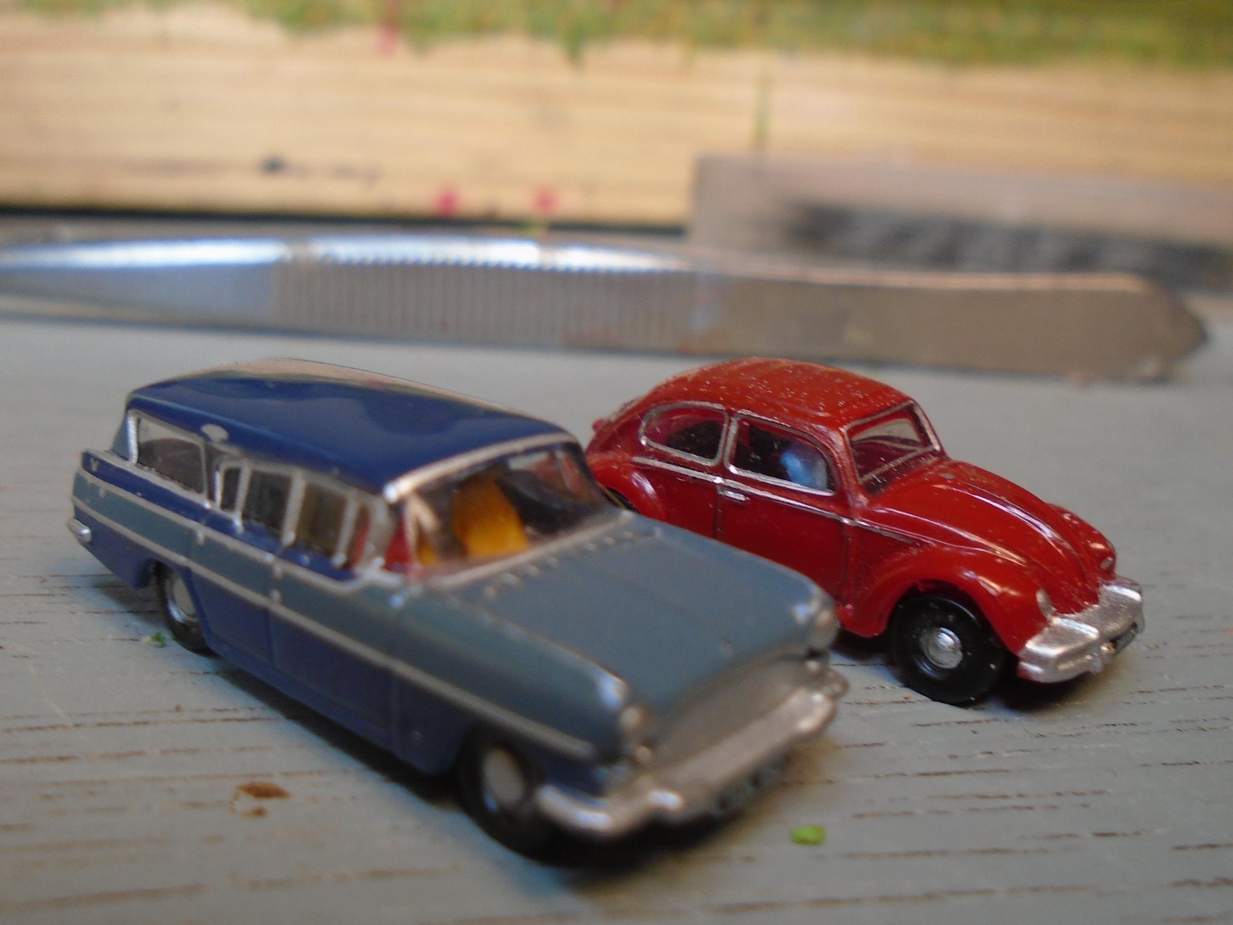

Here a couple of brighter ones are used. One thing to watch is not to make the figures sit too high, or you will not get the body on ......
As you can see, the brighter colours can be seen easier ....

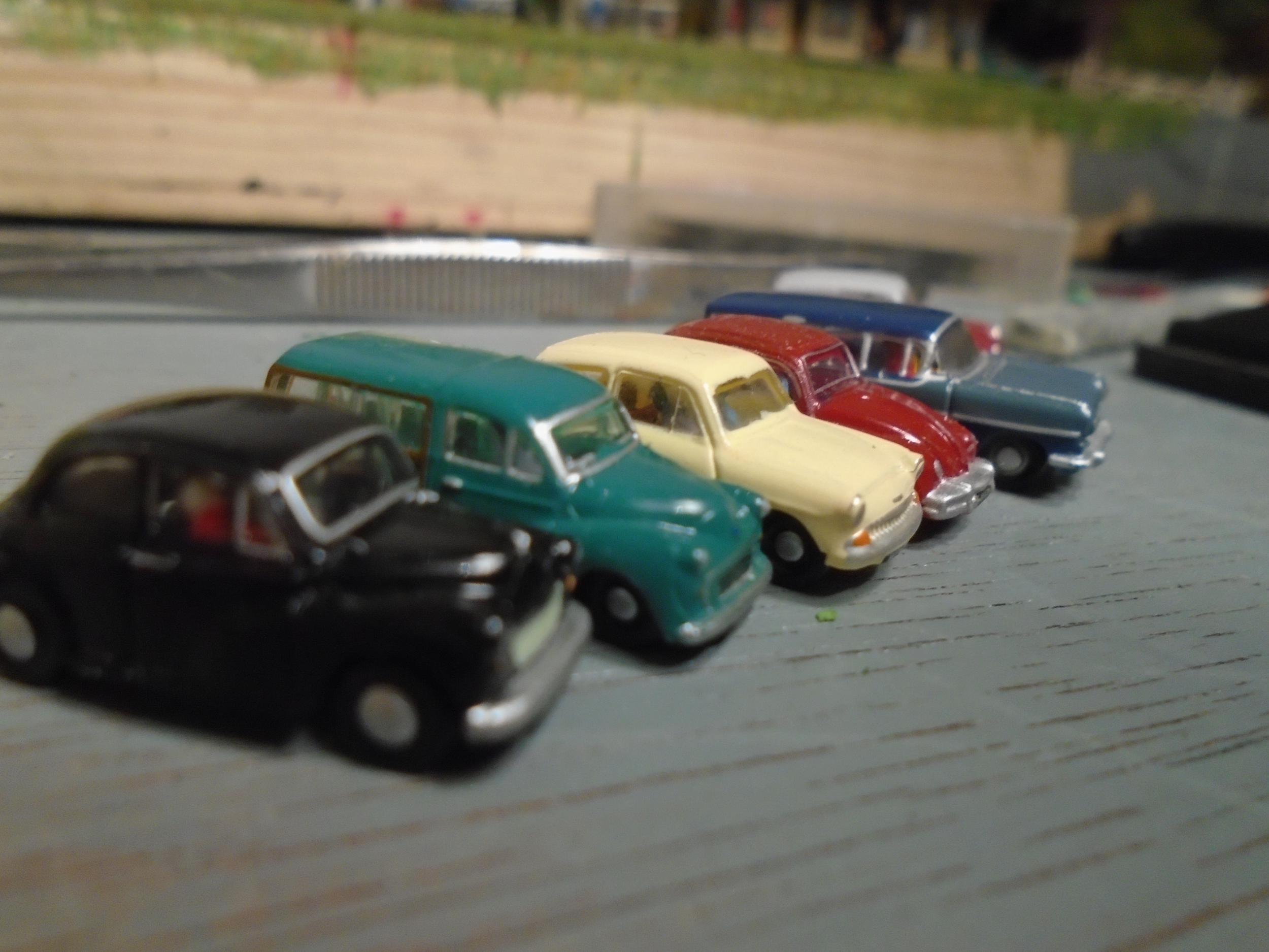

Here is a fleet of cars, all fitted with drivers  :claphappy:....
What you do with all the leftover legs is up to you  :hmmm:

Just a couple of photos to show the difference in looks between a driven and driverless car on the layout.
Also, looking at these photos show how useful a camera can be in picking up things that need fixing. You can see I had the static grass out, and there are strands on the rocks and in the bushes that need hovering up pretty sharpish before any photos are spoilt.
