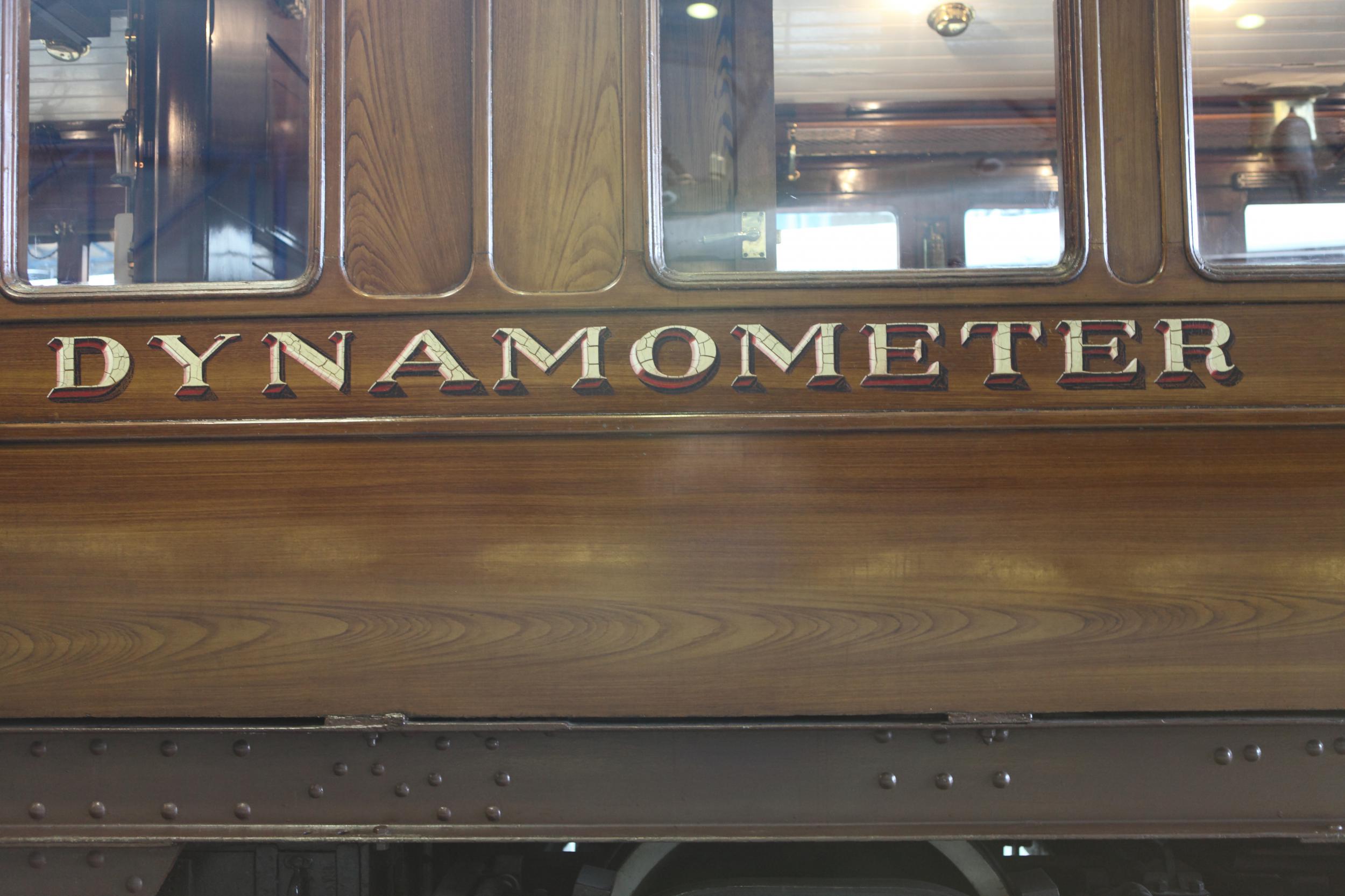

I took 95 shots of her last weekend at the NRM York and when I get time to sort them out I will post some of the more significant ones.
This shot however is invaluable.

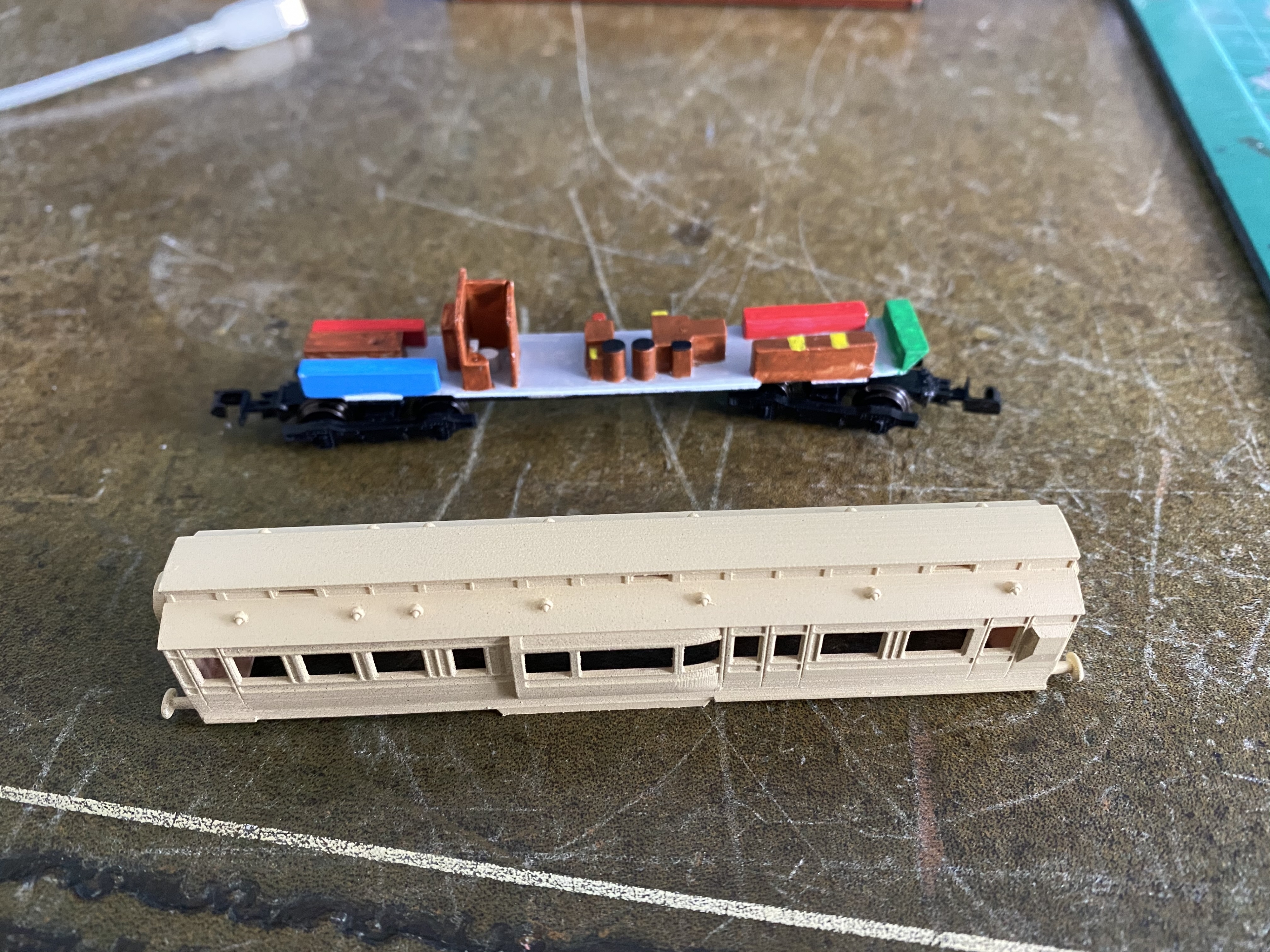

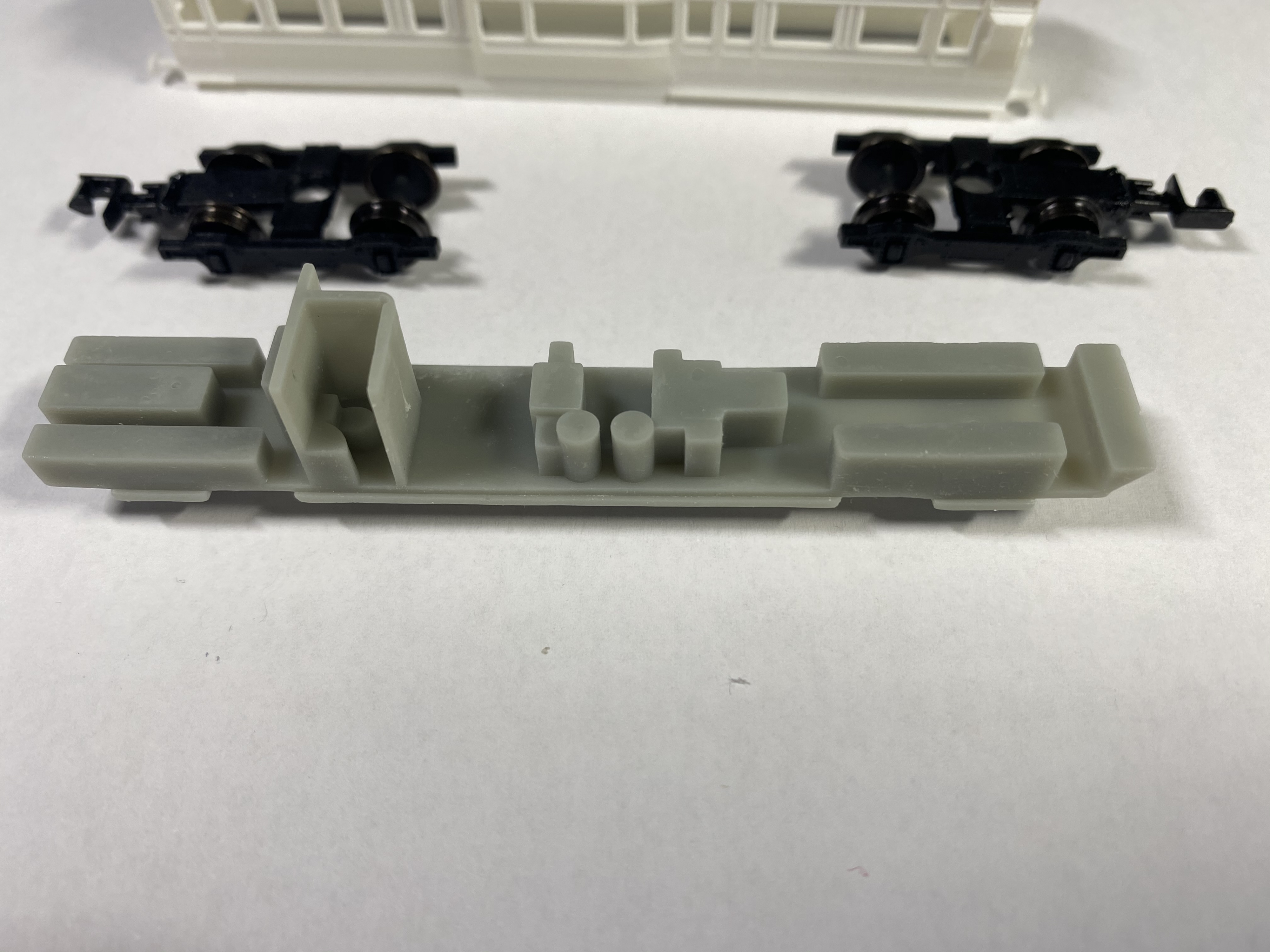

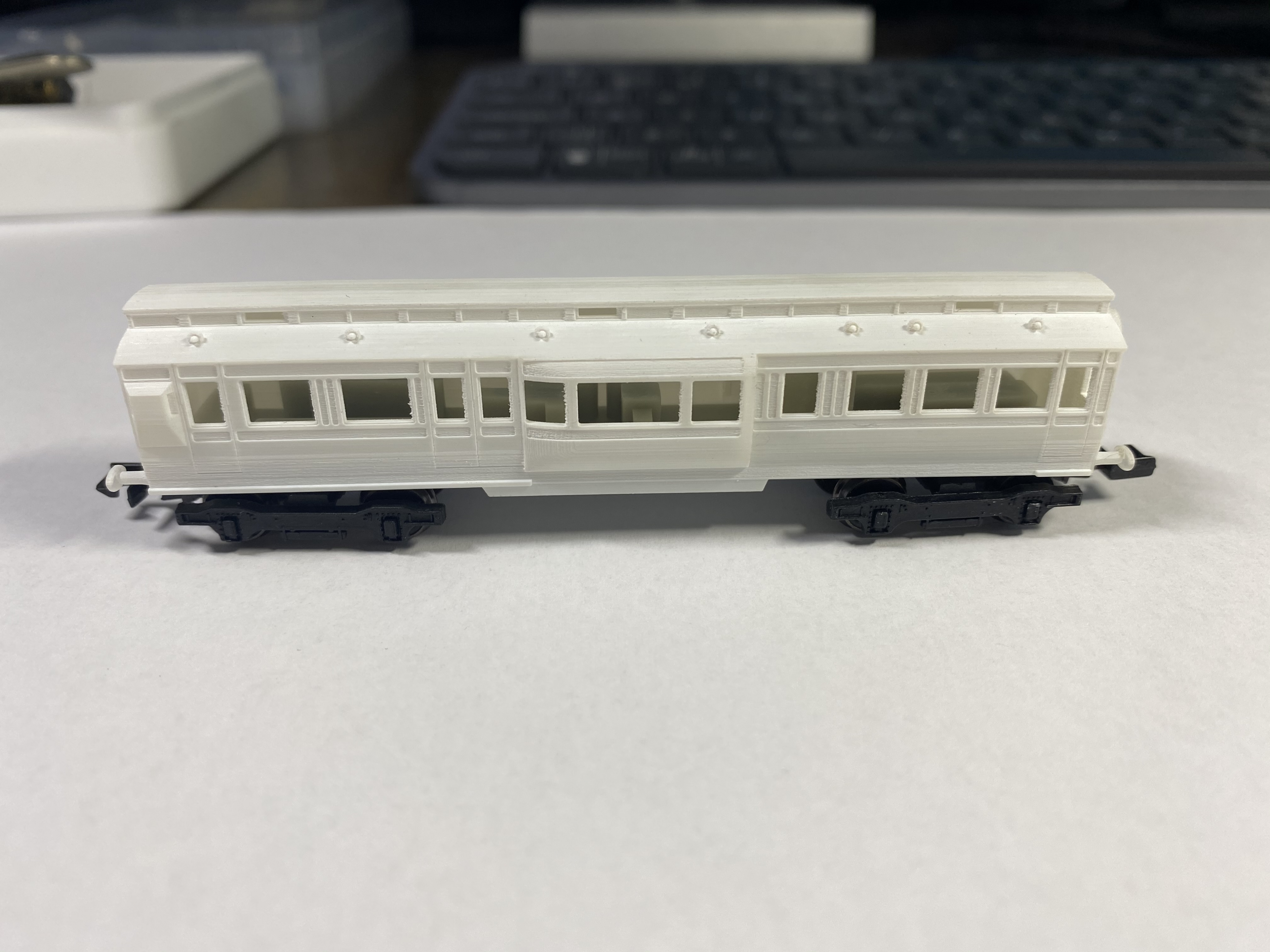

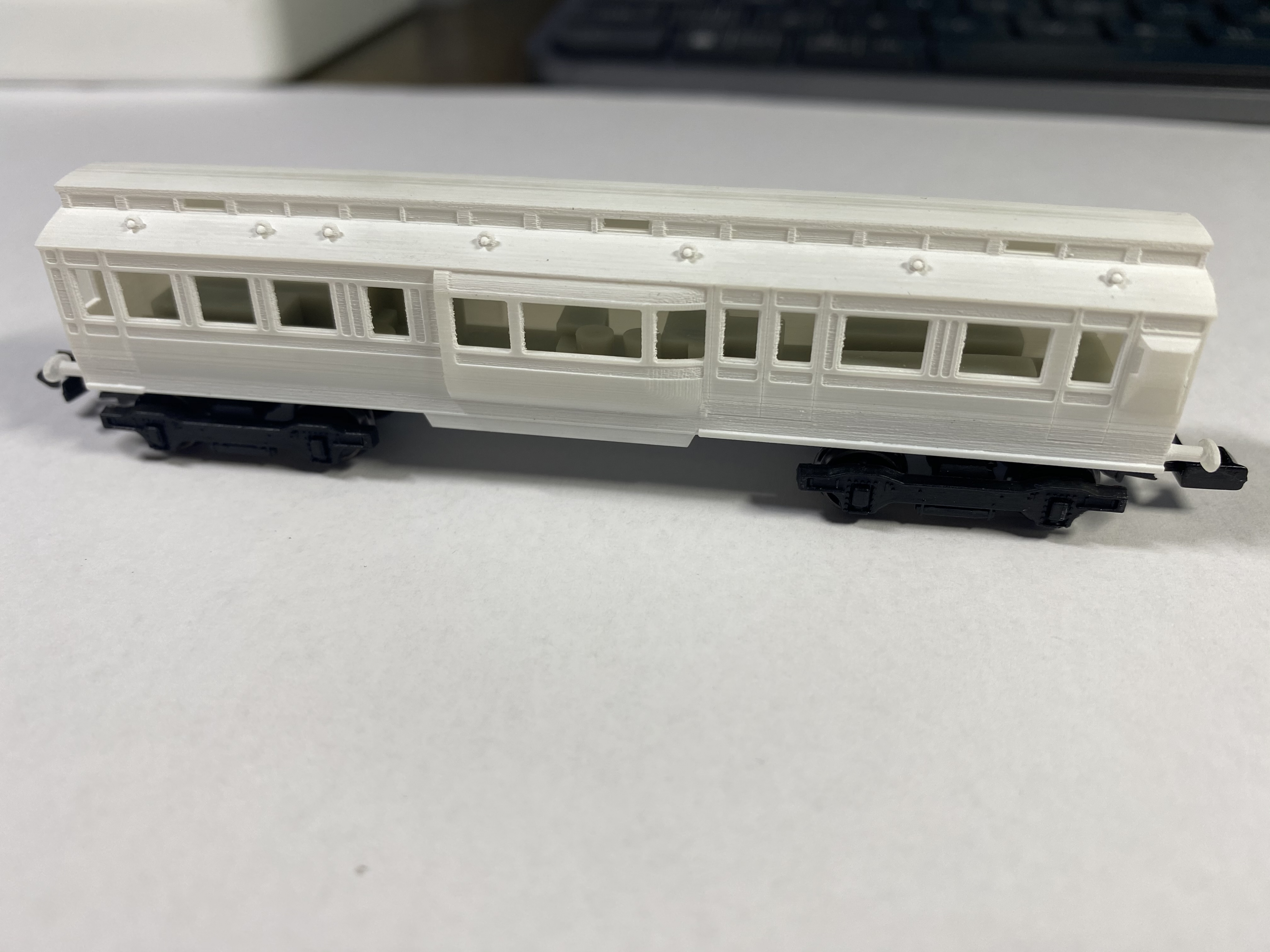

Some progress.
Having watched with interest @Stevie DC thread on coaches and how to paint LNER wood I thought I would dig this project out as a fill in while other models are drying, and to try some of his techniques.
The body available from Shapeways, noted earlier in the thread, is a nice starting point, however the large windows and the nature of the coach type means that some representation of the internal seating benches and instruments is really necessary.  The detail does not have to be much more than a suggestion and is an ideal project to run off on my 3D printer.  In addition to the interior the printed module has the bogie mounts on the underside.  I will add the under frame in etch parts (from my scrap box).
Now I have this printed I need to clean up the prints and undercoat.

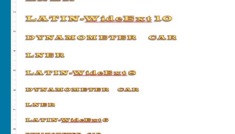

I have built a similar interior for my print using styrene sheet and scraps. Note that the dynamometer wheel was not white in 1938 but dark (black or brown plus grime?). Also, the car was lined in 1938. I've represented that by scraping through my paint lightly with a fine scribe to expose the white print material and then applying a wash of yellow to the entire vehicle. All I want is a very subtle effect. I've not yet been able to figure out how to do the "dynamometer car" lettering--which is inaccurate on the preserved car in York. The spacing and location of the characters was subtly different in 1938. Finally, I've represented the safety bar on the bay windows by scribing a line on the inside of my glazing material.
Snowwolflair
I can print transfers and I have been playing around with generating the lettering.

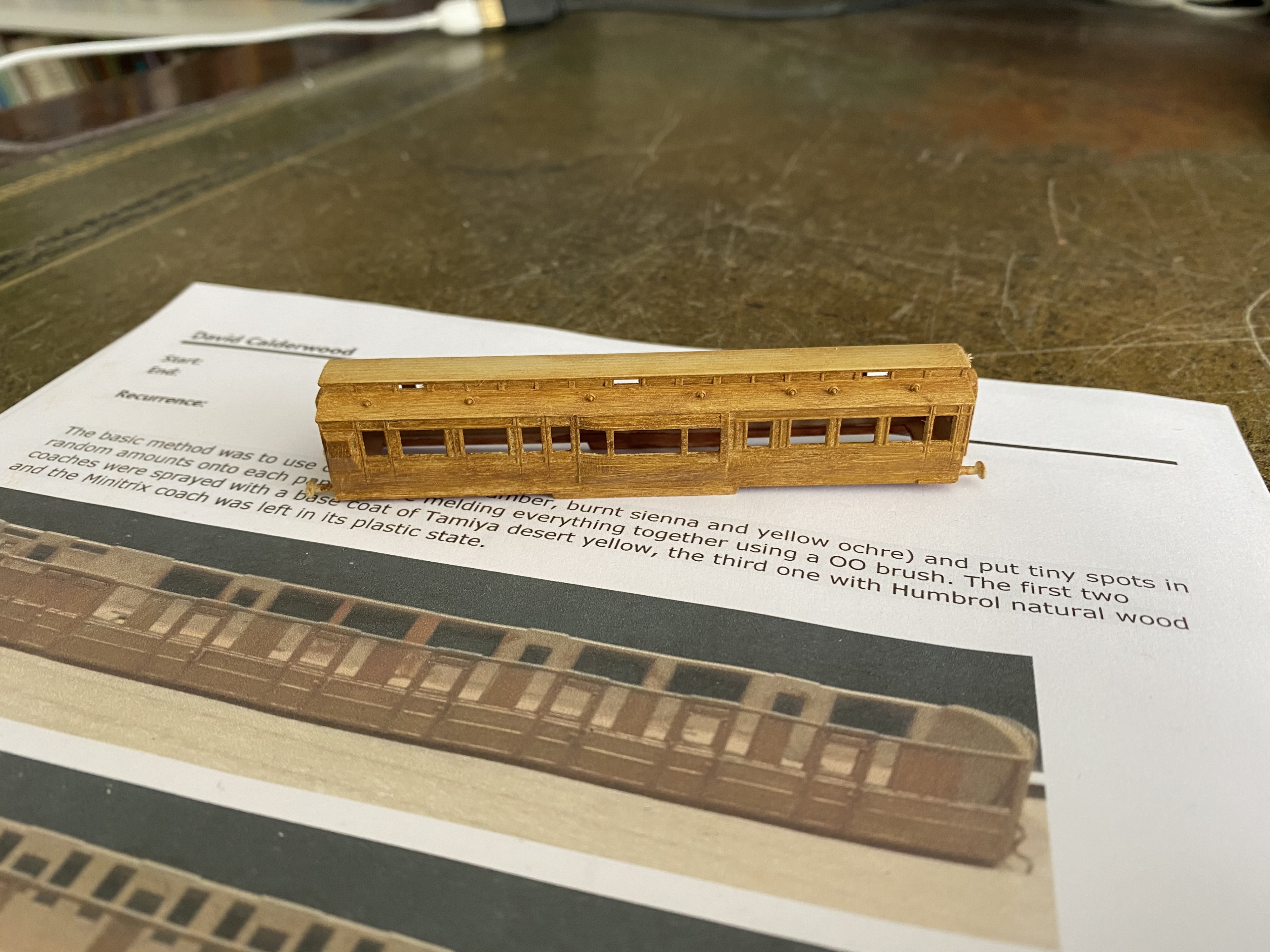

Snowwolflair
Basic undercoating ready for the teak effect (I hope).  It will need weight and I will incorporate this into the under frame when I build it.
Snowwolflair
So far so good.  Next stage will be to darken and age the wood once the oil paints are dry.

Quote from: Shiney Sheff on May 01, 2020, 12:44:14 PM
No disrespects, but why have you done the roof too ?
To do the clerestory window frames there is inevitable spillover, given the brushing technique to create the wood effect.
Its been cleared with turps but the oil paint still stains the undercoat.  It wont make any difference when the roof is masked and painted.
Bit like painting the entire nose of a blue diesel yellow and then masking before painting the blue.
