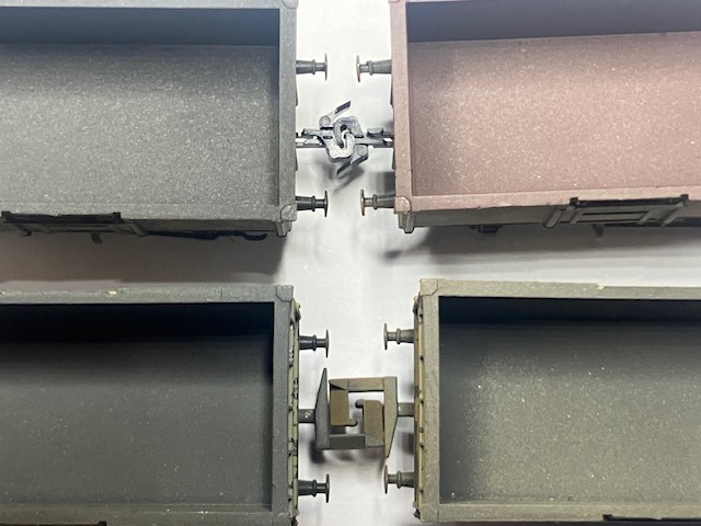

Hello folks
I don't know if this is of interest to anyone or if it has been said before, but Kato make a knuckle coupler that couples with Micro-Trains couplers (and similar) and I presume almost certainly to Dapol Easi-Shunts as well. The part number is Kato 11-702 (black) or 11-707 (grey) and it comes as a pack of 20 (for 10 wagons). These couplers fit directly into the Rapido coupler boxes and can be used when rolling stock is not fitted with NEM pockets. These do not come with the magnetic trip pin so are a lot cheaper (UK RRP £4 per pack) than the magnetic Easi-Shunts. Here is a comparison from above of these couplers fitted to Farish mineral wagons versus the same wagons fitted with Rapidos. The buffers are about half the distance apart with the Kato couplers.
Webbo
ismangil
Ok so consensus seems just to make sure I get wagons with NEM pockets, if I don't want to retrofit pockets to old wagons.
