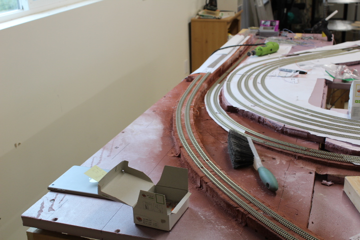

Work has been progressing on the track to the south of Wigan. Five points have been added, giving access from Wallgate to the main line and from the mainline to the Atherton line, plus one to form the crossover from Down Fast to Down Slow.
I've started to add in the curved tracks for the mainline and have been test running as I go with a CL68, a Pacer, and a Pendolino.
Here are some pics.
Looking south at the crossover from Wallgate to the mainline.
And the crossover from the main to the Atherton line
And the curves taking shape before the next sets of points.
Once the main is finished it will be out with the plaster bandage to form a surface on the Woodland Scenics risers used for the incline on the Atherton line
and on the line leading from the fiddle yard.

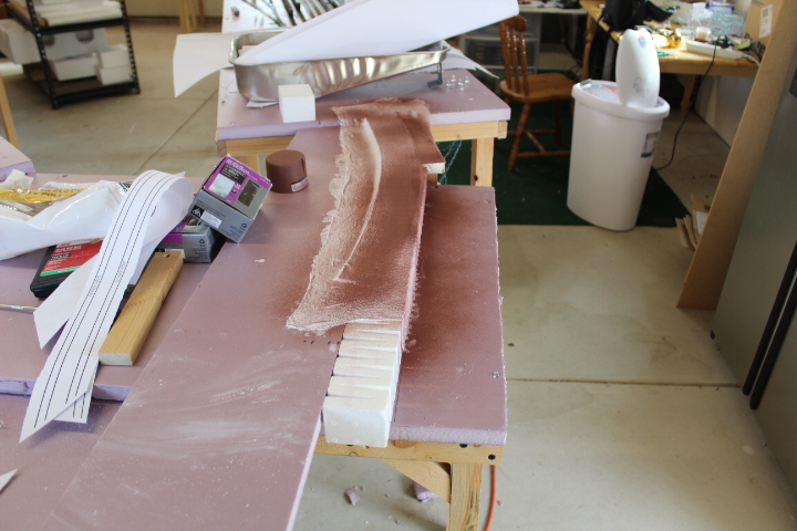

So time for another update.

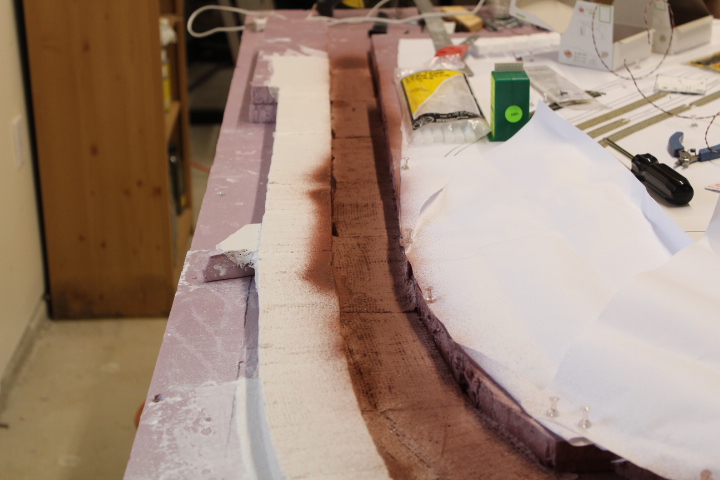

I've now laid the track for the Westhoughton/Atherton line round the curves and also for the track leading from the storage yard.
First everything was covered in plaster bandage and then given a coat of brown primer, I have to be careful here as too much primer will cause the XPS baseboard surface to disintegrate.
I also masked all the existing track as the paint from those rattle cans seems to get everywhere.
This is the track leading from the storage yard.

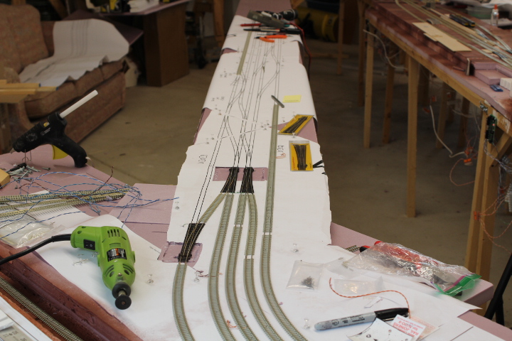

I was then able to complete the curves on the mainline and make a start on the complex point work around Springs Branch.
Getting 2 Tortoise motors positioned underneath the adjacent points was a bit of a challenge because, as you can see on the plan, they are followed immediately by 2 more adjacent points. I ended up cutting a section of baseboard out for both points as a single piece and then instead of halving the depth on the whole piece I stepped it so that the mounting rails on the 2 Tortoises could overlap. In this way, and by mounting the motors on the outside of the points, I was able to get them to fit, and. more importantly, to work.
At this point, forgive the pun, I have had to stop as I only have 1 RH and 1 LH point left and I have had to order more points from Hattons so that I can get the track laid in some kind of logical fashion. I have also decided to simplify the layout here by abandoning the various points associated with Springs Branch itself. This will create a "simple" 6 track main, as I am also ignoring the Liverpool line.
As we have a four day weekend coming up over here, I hope the points arrive, otherwise I might have to start ballasting :(
Once I have the full main line in place then I'll review things to see where I have space for more storage sidings and potentially some rail served industry.

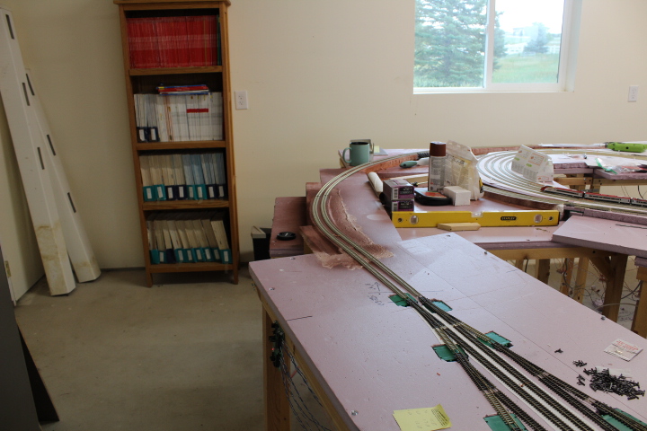

But things are settling down again and I've been able to get some quality time out in the shed to continue work on Springs Branch Junction.
After some careful consideration I decided to abandon Springs Branch depot itself. This saved a couple of feet on the layout ans eliminated 5 points. The space saving allowed me to re-plan the freight fly-under so that it drops and rises again on the straight, rather than on a curve.
Another half dozen or so points have been laid and tested with just 4 left to go before I can get on to some simple straight track laying.
Here are a few photos on progress so far.
Looking south.
Making a start on the gradient for the fly-under.
I'm hoping to get this finished this weekend so that I can run a few trains.
Next I have to get rid of some junk in the shed and build more baseboards, but I may also build a temporary link so that I can get trains running around and around again.

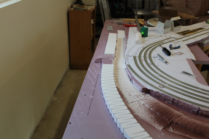

I've managed to get quite a bit more done, and am now faced with building more baseboards. As the garage has a sloping floor, that's not quite as straightforward as it could be.
First I finished off all the point work for my version of Springs Branch Junction.
I ran a test train and got a short. After a happy hour sorting that out all was well and I made more progress on the freight underpass.
What with the trees and a test fit of some Metcalfe retaining walls you'd think I was doing scenery  :D
I also built a small add on baseboard and laid out a little more of the plan.
One obvious issue is that although on my plan I should be able to get between the curves on the main and the Southport/Kirkby line for access, I forgot to allow for the baseboards. So a bit of crawling will be required!
Next I'm going to complete all the baseboards for the mainline, but then I'll complete the tracks as far as the next junction and then probably run some temporary track to give me a loop to run trains again.
