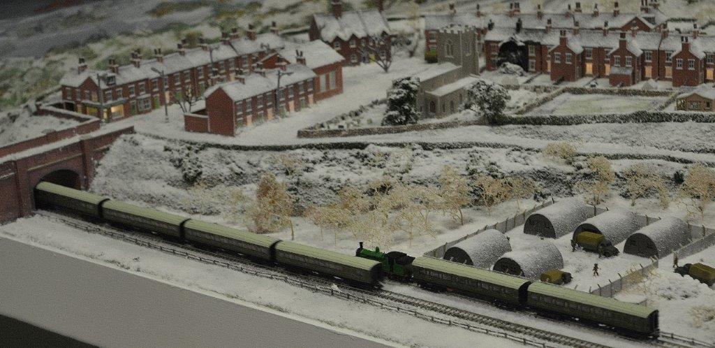

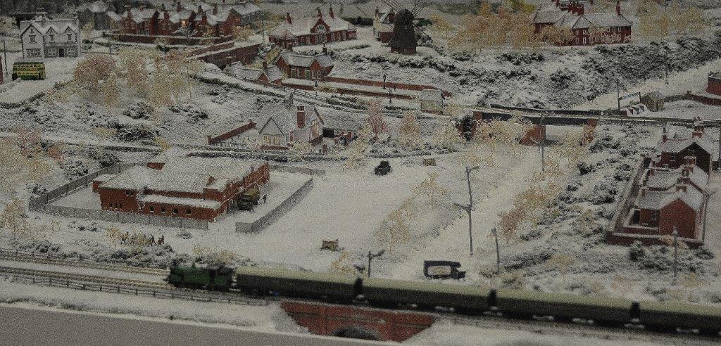

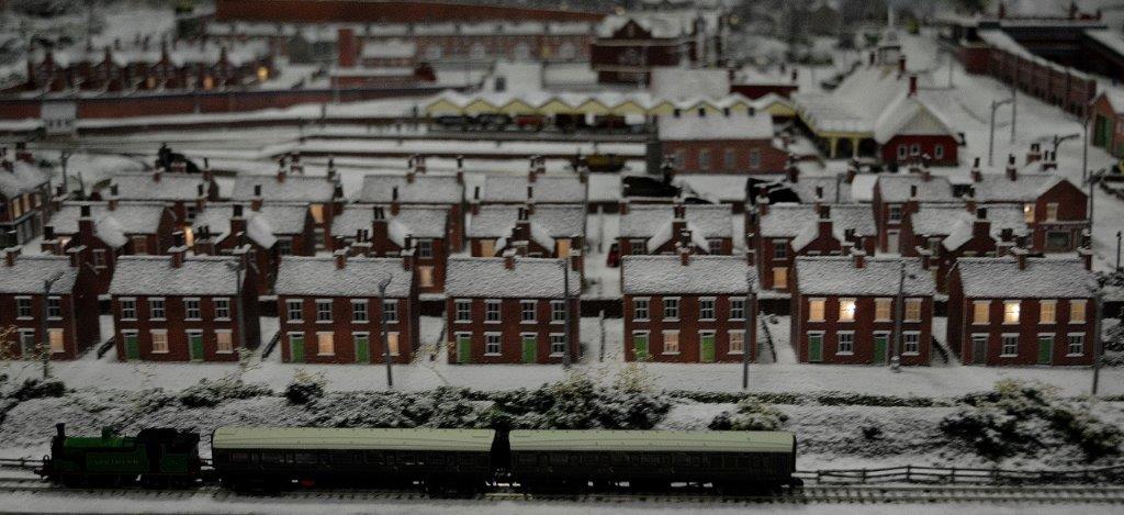

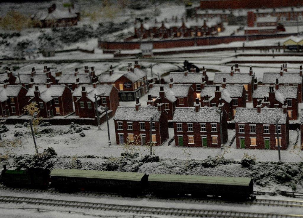

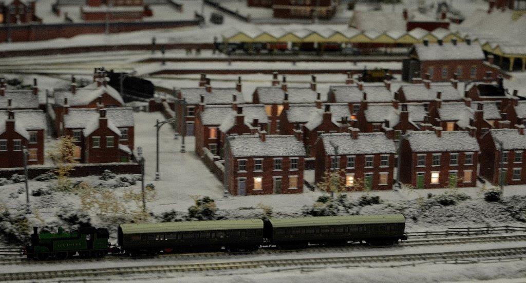

It has started to snow in the Bexhill area and there is no one about.
Colin.

Looking very realistic. How did you achieve this!

A couple of overviews.
@crewearpley40
1) Photo spray mount on the base object
2) Woodland Scenics soft snow scattered from a height with a spoon.
3) brush into small piles for driven snow.
4) Fix with hair spray.

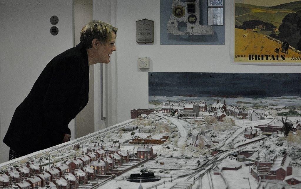

A while has past and an update is due.
In late September we had and open day when our patron Eddie Izzard visited to inspect the progress so far.
Eddie arrived to much cheering from a waiting crowd.
In true style a guard of honour was drawn up from our local defence force.
After inspecting an interesting display of weaponry.
It was off to inspect the centre piece of the display room. The Railway!

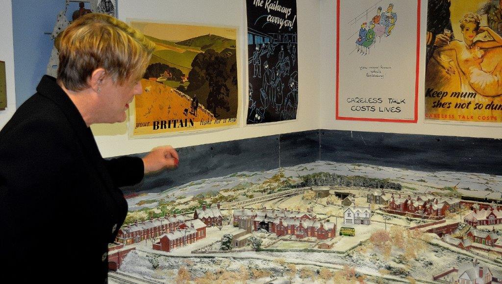

I lived just about there:

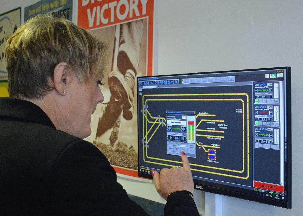

We even enrolled him as an operator.
