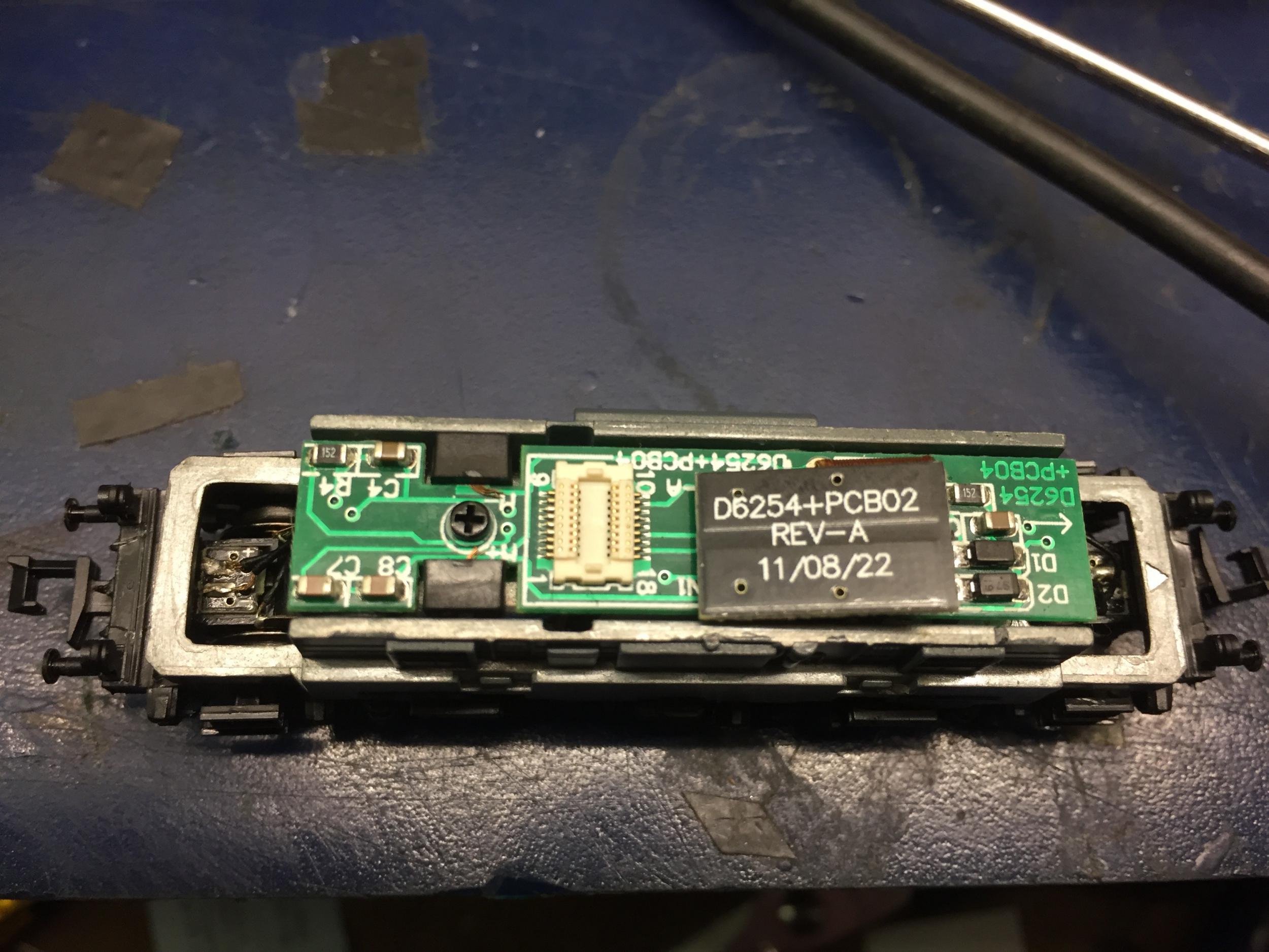

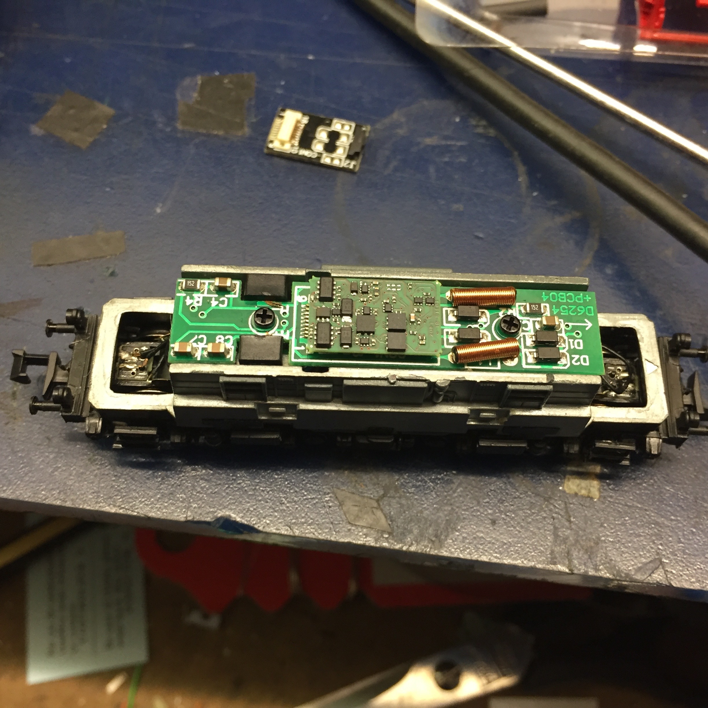

The chip socket seems more robust & reliable that the 6 pin sockets - and the chips do not need 6 little bits of wire soldered on!
Next 18 chip in situ
The black square is the dummy/DC plug
