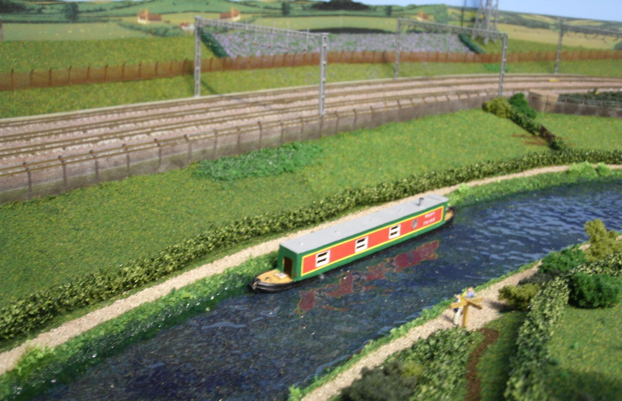

I would have to agree with Graham. I stuck with N because of the space advantage over 00. The visible viewing section of my layout is barely 30 inches across, which would need about double that for double O. Not to mention the length of trains! It would have reduced my ambition considerably in the larger scale. I would definitely say hang on in N  :NGaugersRule:

Sorry, off topic but I just saw this picture and was struck by how good the river/canal is in your model.  I'd be really interested to see more pictures and see the method that you used.  Do you have a layout thread?

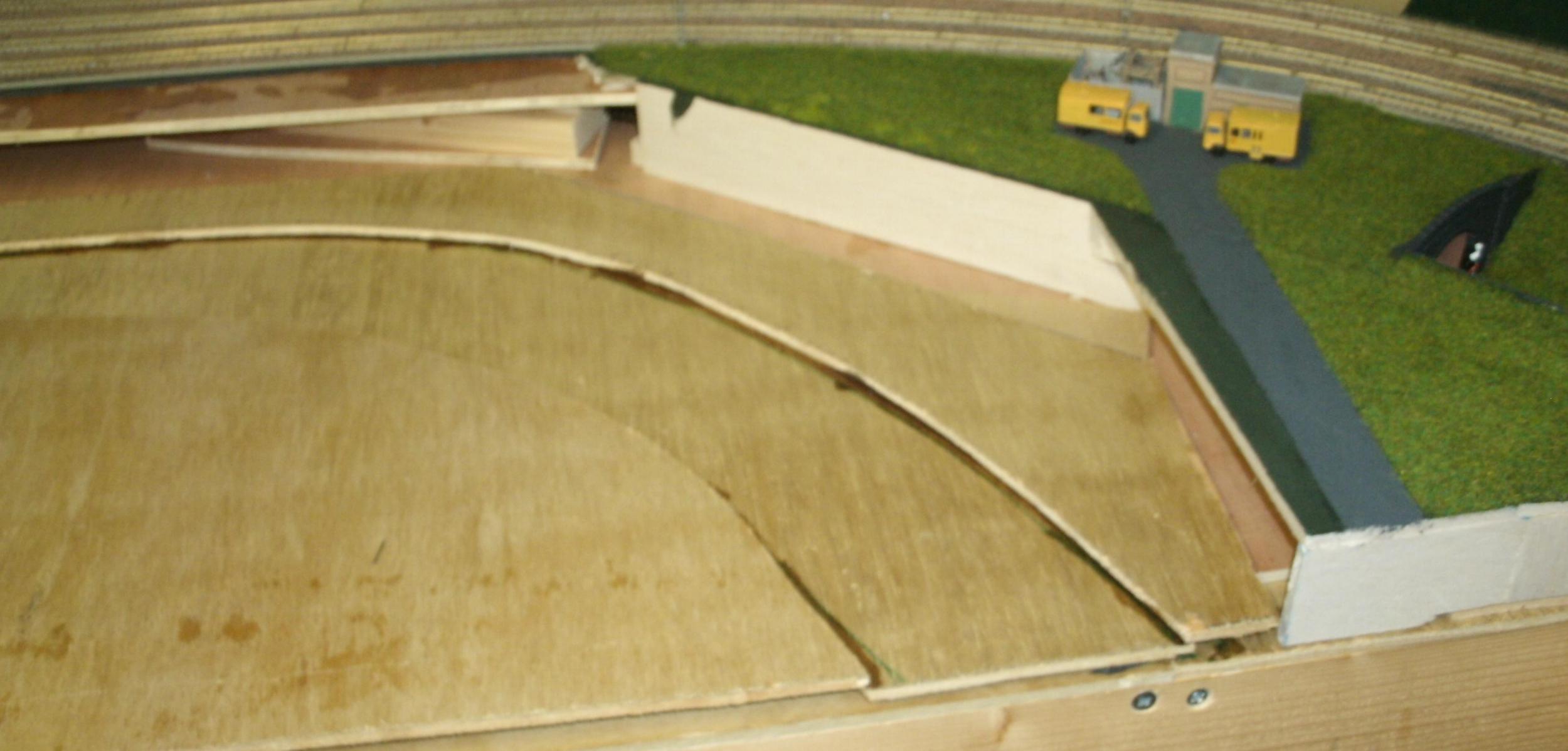

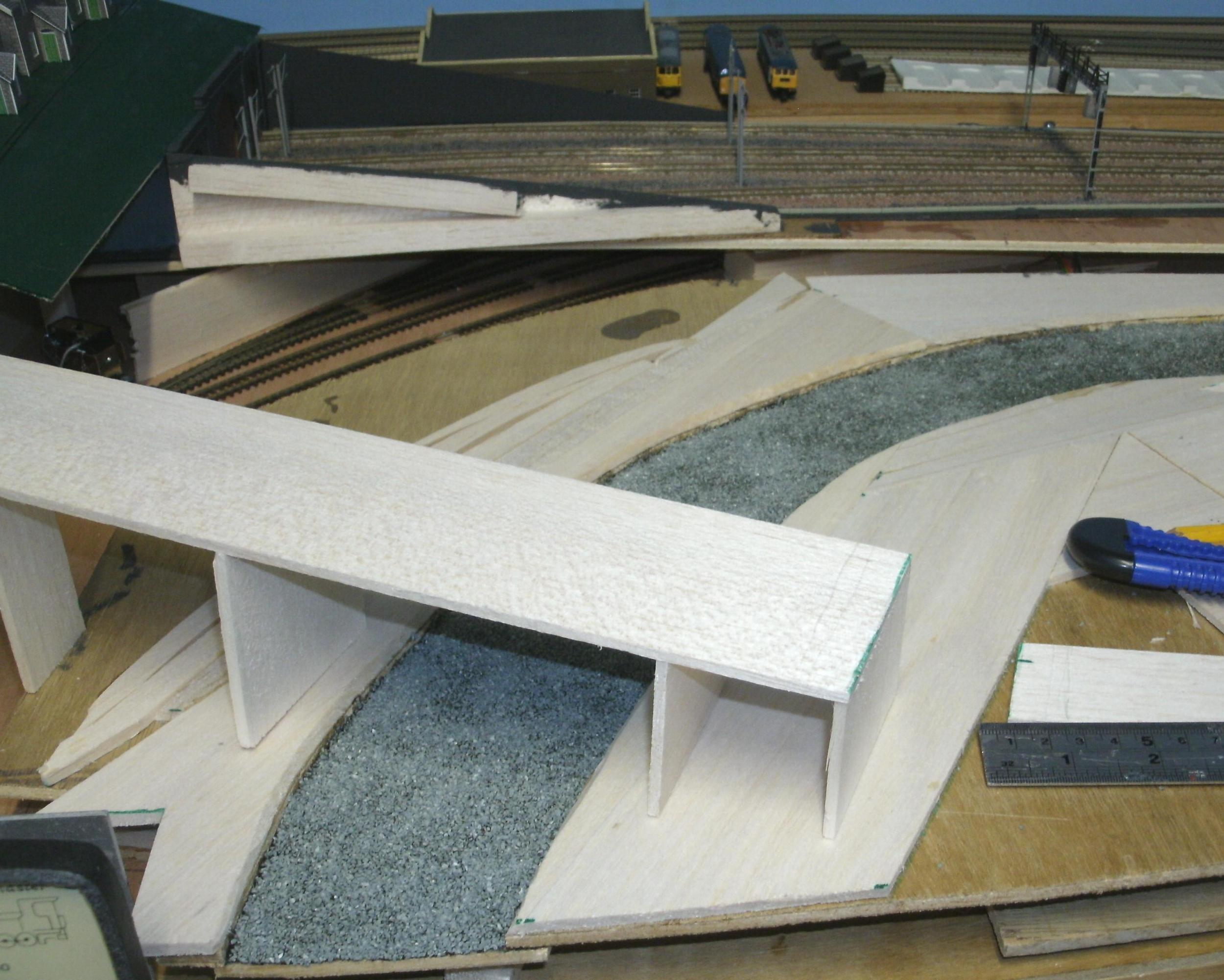

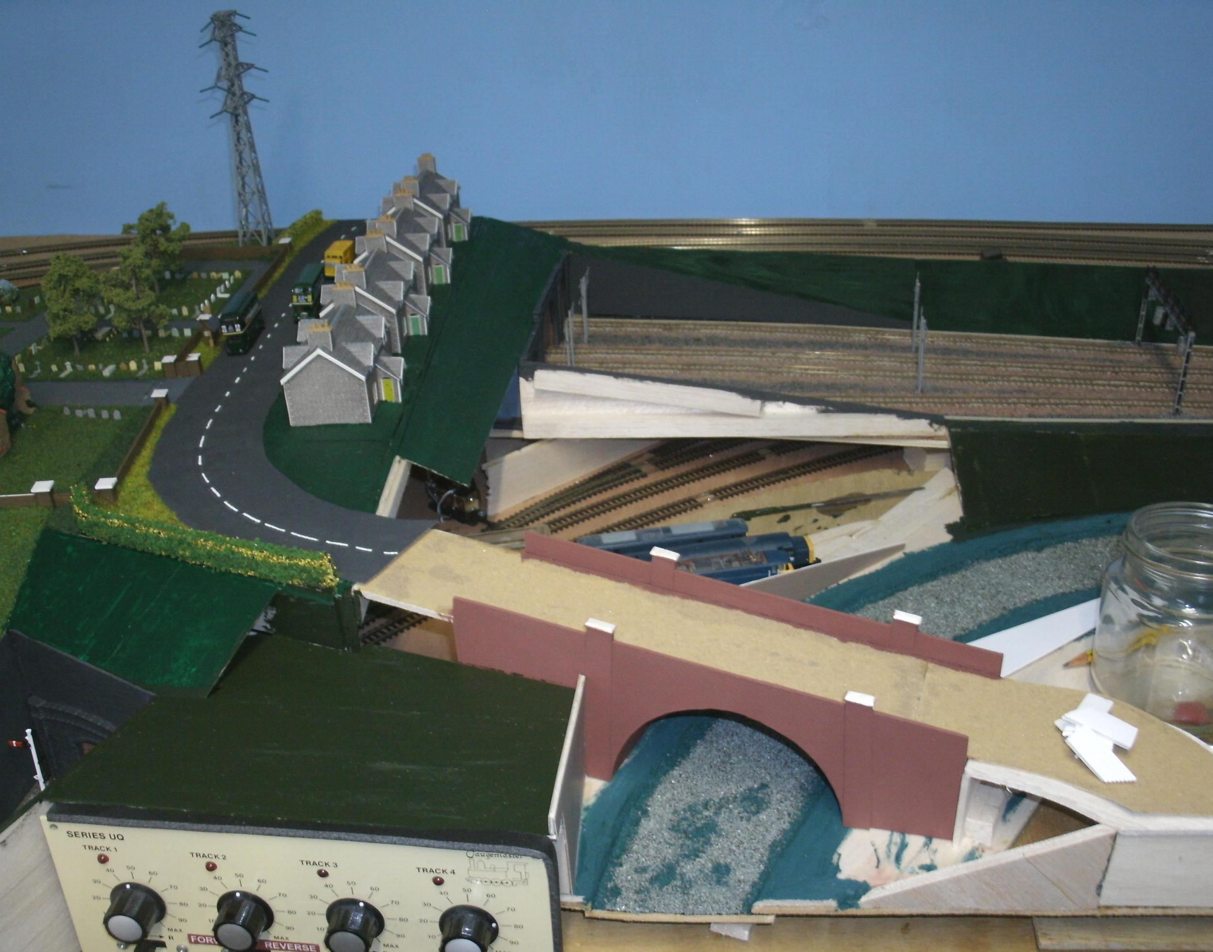

Thank you for the kind comments. The Canal ended up the way it did by accident rather than design. The one thing that I did get right was to make sure the canal was level from end to end to avoid 'pooling'. The canal was started by cutting out a section of 5mm plywood, and recessing the canal bed below the baseboard level. The canal sides were made up from Balsa wood planks cut and shaped. The canal bed was made up of coarse granite ballast glued in place. This was then painted in various mixtures of blue to represent varying depths. (As my sky was clear blue this would be okay, I would've 'greened' it down a bit otherwise)
The bank sides were eventually given several coats of various green paint (leftover DMU and Loco colours!) before being covered in scatter and static grasses. I decided to try Woodlands Realistic Water, which was poured gently into the canal to a recommended depth of about 2mm, which covered the ballast. However, I hadn't reckoned with how the water was absorbed into the stones and sides. The water level went down overnight to leave an uneven ripple where the chippings were. I then used a second and third fill of about 1mm and found the ripple effect showed through. I went from being concerned to reasonably happy with the end result. Finally added a few Noch scenic 'clumps' at the sides of the towpath, and a few 'Blu-tack' swans.

Thank you Andy, that's a great bit of modelling and well thought out.    :thumbsup: :thumbsup:
Rabs
Indeed, thank you.  Two things jump out as particularly good. First, as you noted, the colour of the water is right for the sky colour and second that the reflection of the narrowboat is just right.  It's not a perfect mirror but it's not a muddy blur either, just nicely broken up by the ripples.  It's very convincing.
Has the woodland scenics water been manageable to keep dust free?  That's always been the Achilles' heel of water when I've modelled it before with gloss varnish.

Dust hasn't been a problem so far. I did use a one inch soft paintbrush to clear off some of the scatter and grass material when I had finished. The water was hard enough not to have been marked or sticky enough to keep the leftovers from adhering to the surface.
