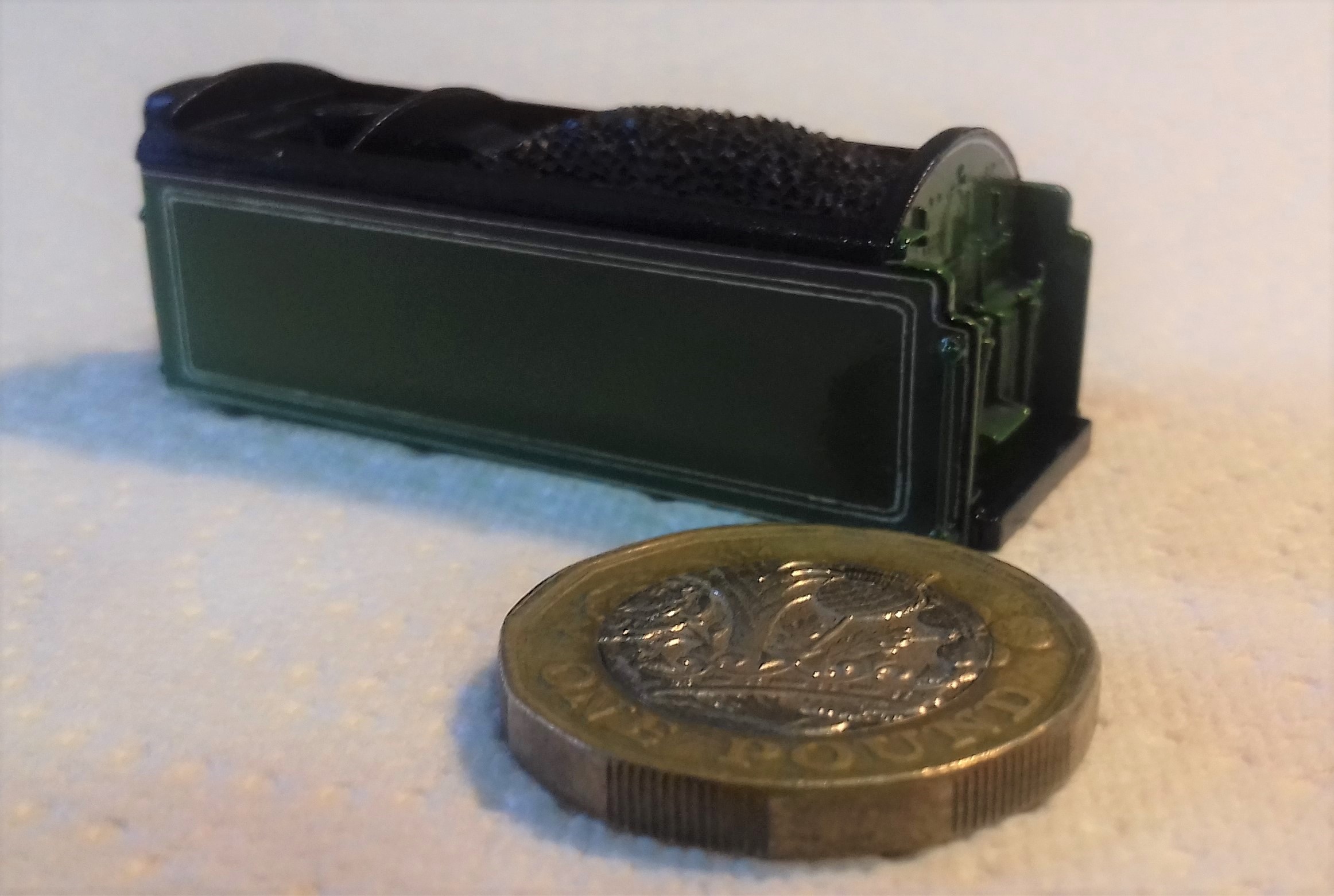

I've managed to spend a bit of time doing the first bits of the center panel lining for Spearmint's tender. While I was originally going to use the hand painted decal, I found myself on an off day with getting the scalpel cuts right to give a consistent outer white line.
Therefore, I decided that I was going to try once again and ruling the outer white lines onto the tender. I've never been happy with my previous attempts as it is very difficult to get two consistent and paralleled lines that are only 0.5mm apart. However, today somebody must have been smiling down on me as I've managed to make a reasonable attempt at it for the first time.
The lines are a little messy in places but this is all on the inside, which will be painted black once the outer lines have dried. The corners are brush painted using a fine tipped brush and then tidied up using a brush moistened with white spirit and the wiped on a kitchen towel until almost dry to gently lift or manipulate the paint.
Overall this represents about 90 minutes worth of work. Now that I seem to have cracked the basics, I expect subsequent efforts to be a bit quicker.

I've painted the center black line today. Below is a rather cruel close up and comparison to Dapol's factory finish.
I've still got some tidying up and patch painting to do, so I might get things a little neater yet.

Well I think that looks pretty damned good, I'd be proper chuffed to achieve something that good.
To be honest Steve, I think the Dapol one looks like its a printed on decal to me, whereas yours looks like its a lovingly restored tender out of some shed in Darlington. Far far more like the real thing.
Just my opinion.
Thanks Kirky, I think the lack of decently lighting does my tender a lot of favours! As the loco is (and will largely remain in) Dapol's factory finish, I've really been trying to match the finish. Once the other side is done, I'll be giving the tender a coat of satin varnish (very slightly bias to the matt side) to try and get as close a finish as I can.
