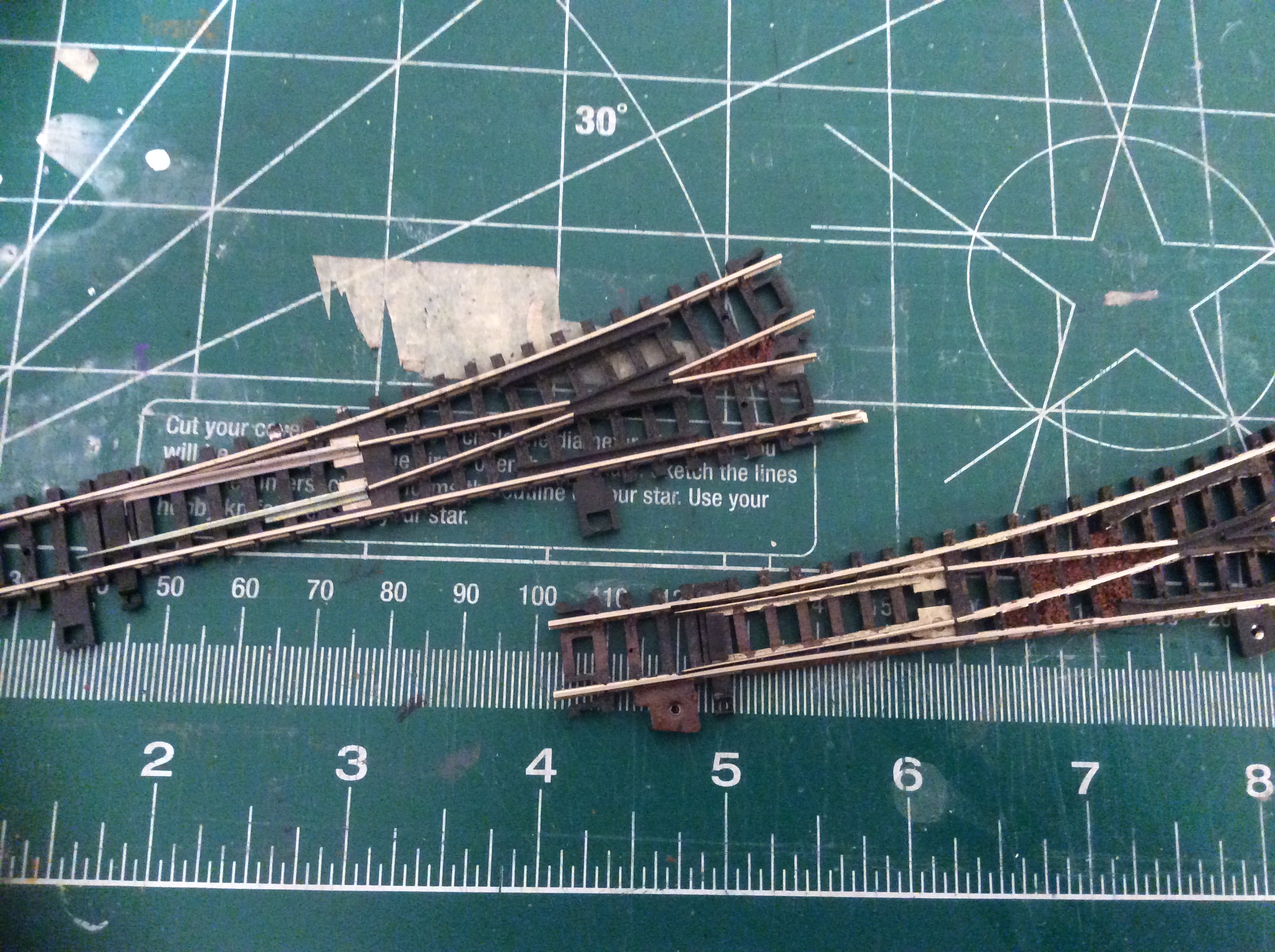

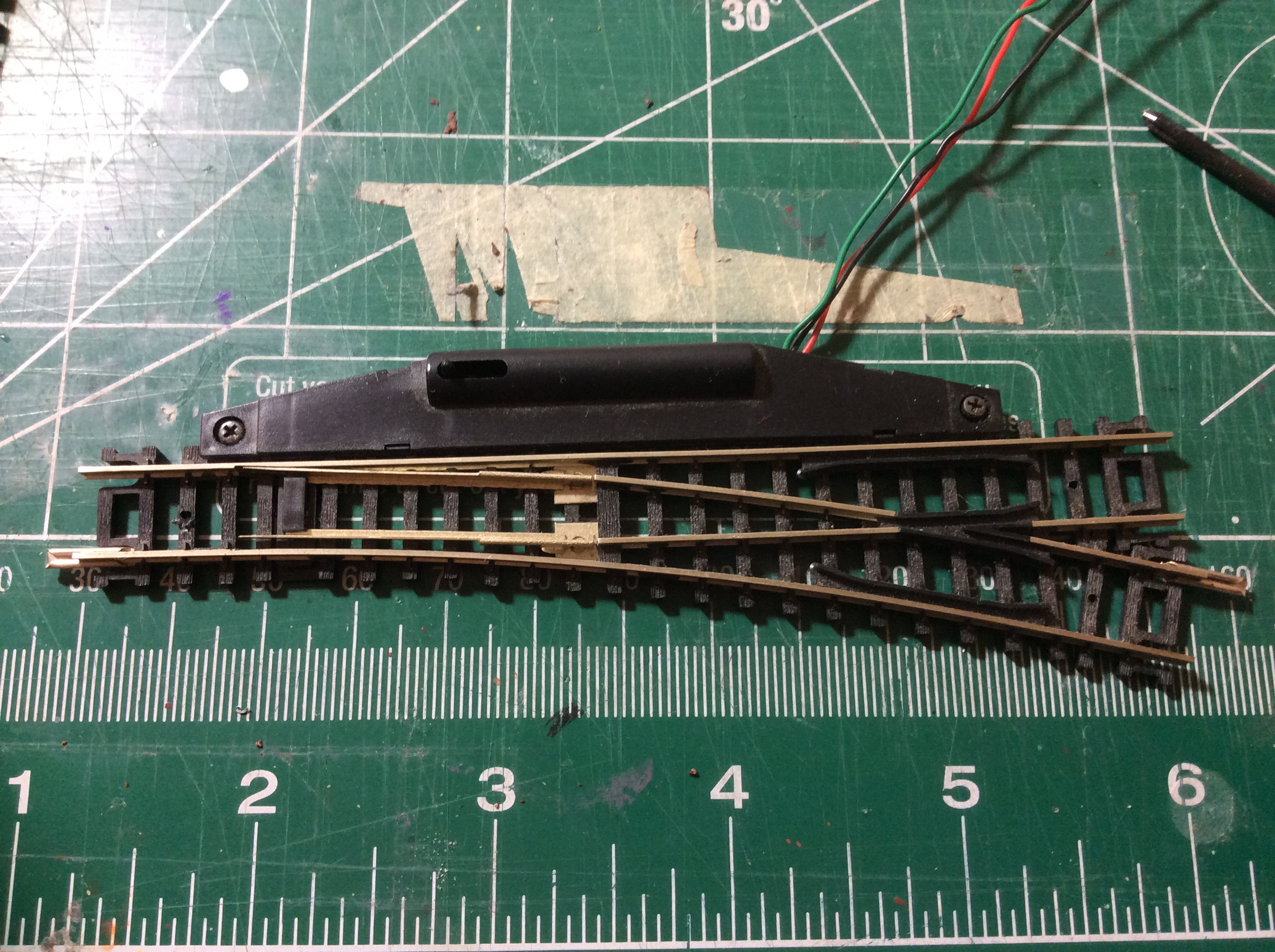

The original switch looks like this.
When you remove the mechanism, it looks like this.
(I forgot to take a picture of the actual switch that I was working on but these are identical Atals switches.)

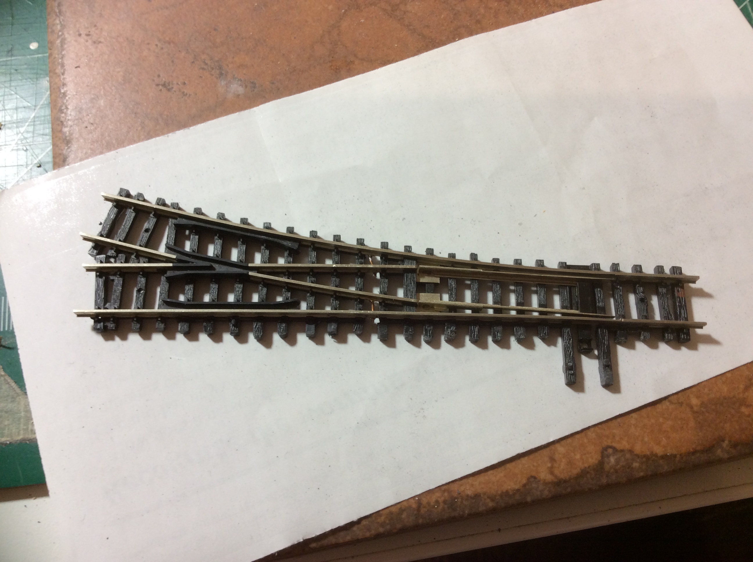

One side of ties (sleepers) are missing.
It's not pretty.  :thumbsdown:
I added small piece of ties, it's getting closer look to Atlas custom line switch.
I also modified the end of switche ties.

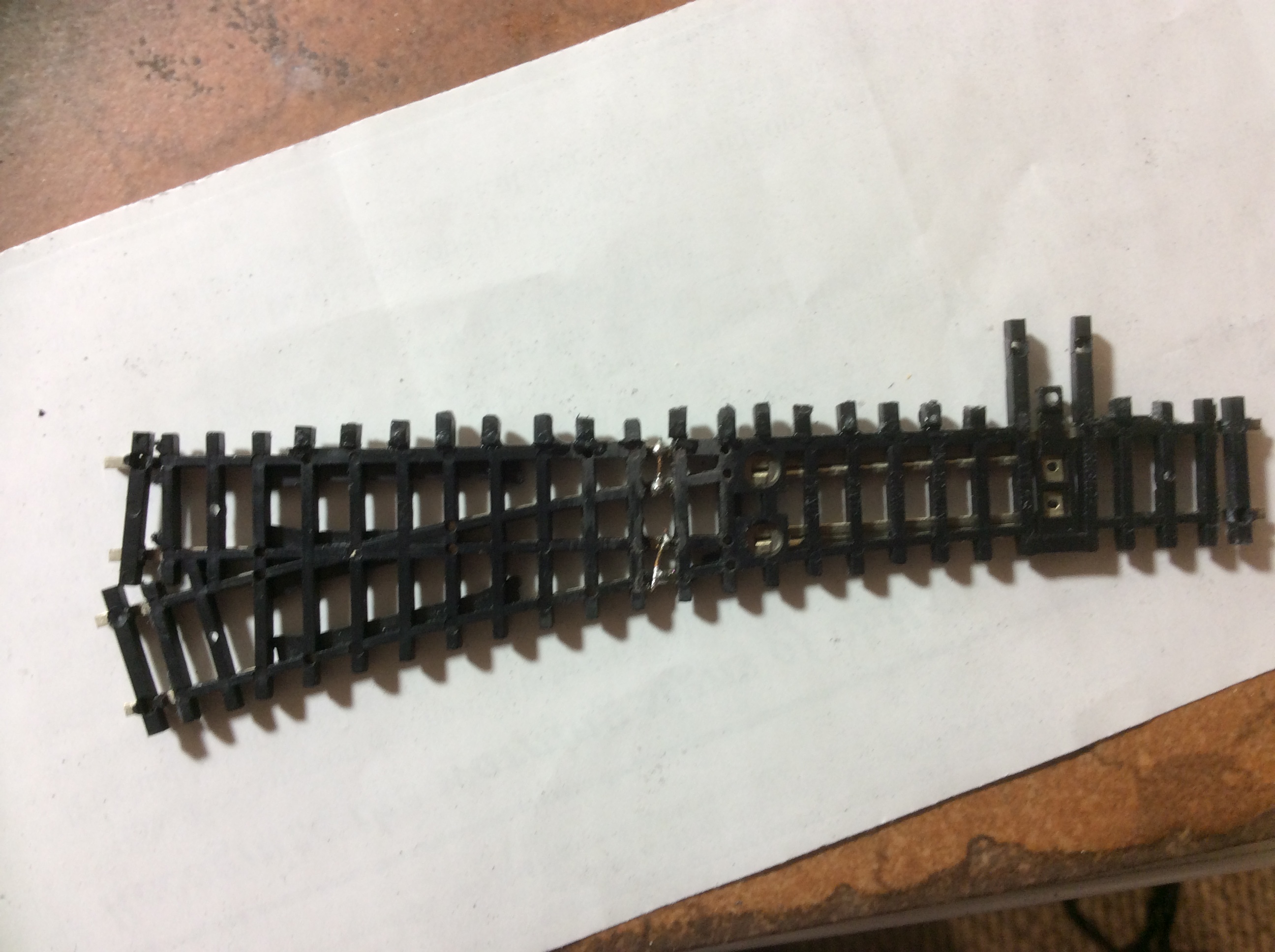

When you use super glue, you can use a left over paper from stickers or adhesive labels. (Waxed surfaced looking paper.)
So that the model wouldn't stick to the surface.
You can see that I'm gluing the model on a waxy paper.
I soldered jump wires for reliability.
(I don't know it makes any improvements though. At least I feel better that way.)
I don't have a needle tip soldering iron so it was difficult and melted a little tie.
