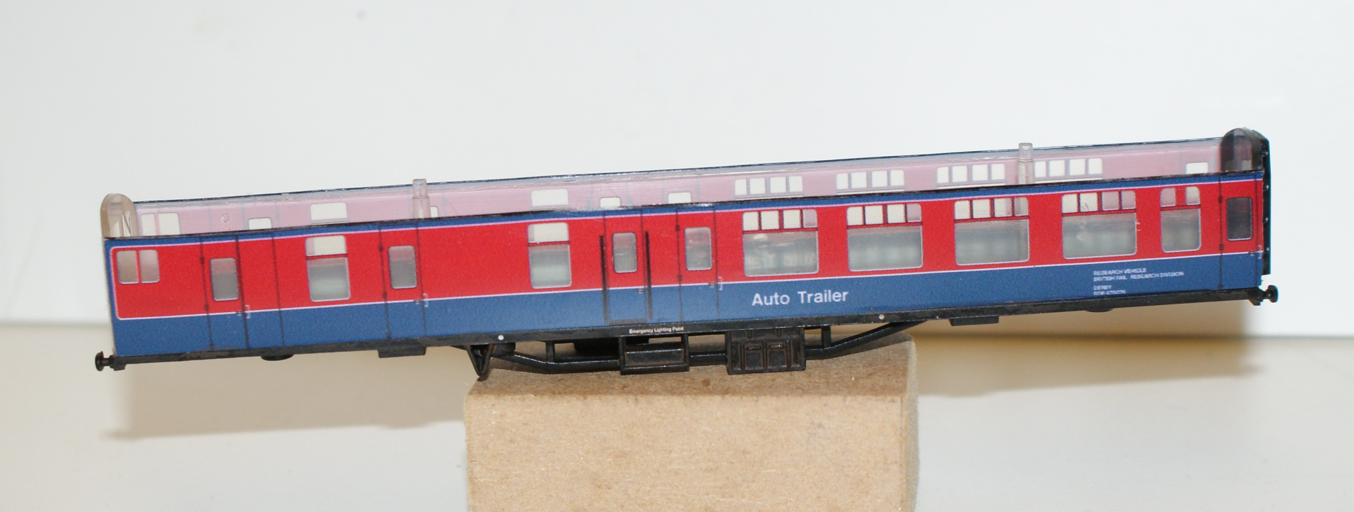

The VBA Van
I thought I would start with the VBA Van as it looked the easiest!
The VBA van has a lot of raised details on the sides.  I sanded these flat with fine wet and dry.  The corners of the van have a small indent in them and I did not think the vinyl would fold into them.  I decided to sand the sides at each corner with a gentle curve to remove this indent.  This seems to have worked but I think that filling the ends and squaring the corners might be better.  The indents in the longer sides donít cause a problem and donít need to be filled.
The underlying colour of the plastic is white and I left the body as white which was a mistake.  The final colour of the vinyl depends very much on the colour of the underlying plastic which for the coaches is transparent.  With a white plastic the vinyl to very red see photo.
The vinyl finished with a very small white line showing top and bottom.  A touch with a black pen or paint sorted this but spraying the body first would have been better

The Coaches
The two coaches I had were Farish MK 1 coaches.  These were marked Made in China and seemed the same vintage all regional railways.  Electra recommend BSK.  I had one and a Second SO.
The BSK had no surface detail at all which made life much easier.  The second had moulded door handles and hinges which had to be sanded off and the plastic polished
The BSK had no interior but the SO had an interior which had to be removed and unfortunately it was glued in and removing this caused some damage which proved impossible to completely remove
Both coaches had a blob of paint on the inside blanking out a window, these blobs did not generally match any covered area on the vinylís and so had to be removed.  No stripper I had touched them so I had to sand them off
Stripping the paint was fairly easy better the last ones I did which were marked Poole made.  I used cheap nail varnish remover consisting mainly of acetone.  The plastic seemed to be slightly cloudy perhaps age?  I used cotton pads to apply the acetone and I wonder if these dulled the surface certainly around the old windows there was some dulling and misting.
 So we have to polish the plastic up again.  After a net tip I started using toothpaste and this certainly was a good start.  In the end I used some Poundland nail polishers which had a variety of finer finishes and the ďshineĒ one seems to do the job but be prepared for some hard work especially if you have had the sand any areas.
Test fit the vinyl before applying.  Sometimes then are a little too bit large sometimes just right.  This is especially important on vinyl like the tribo train which have straight lines and detail close to the edge which could be lost if matching at the opposite end.
It is possible to peel back the vinyl if you have a problem but be careful not stretch the vinyl.  Check carefully for any trapped material under the vinyl.
You may need to trim back any overhanging vinyl at the edges.  The glue is strong and apparently grips better with time but if any edge lifts then a small application of super glue should fix it.
A coat of ant-shine spray will take the shine of the vinyl but donít forget to mask the windows
1.   Try to get a MK1 coach without any raised fittings
2.   Use the minimum amount of paint stripper
3.   Polish off any dullness or misting
4.   Test fit the vinylís before applying
5.   No lumps or bumps the smallest particle will show under the vinyl
